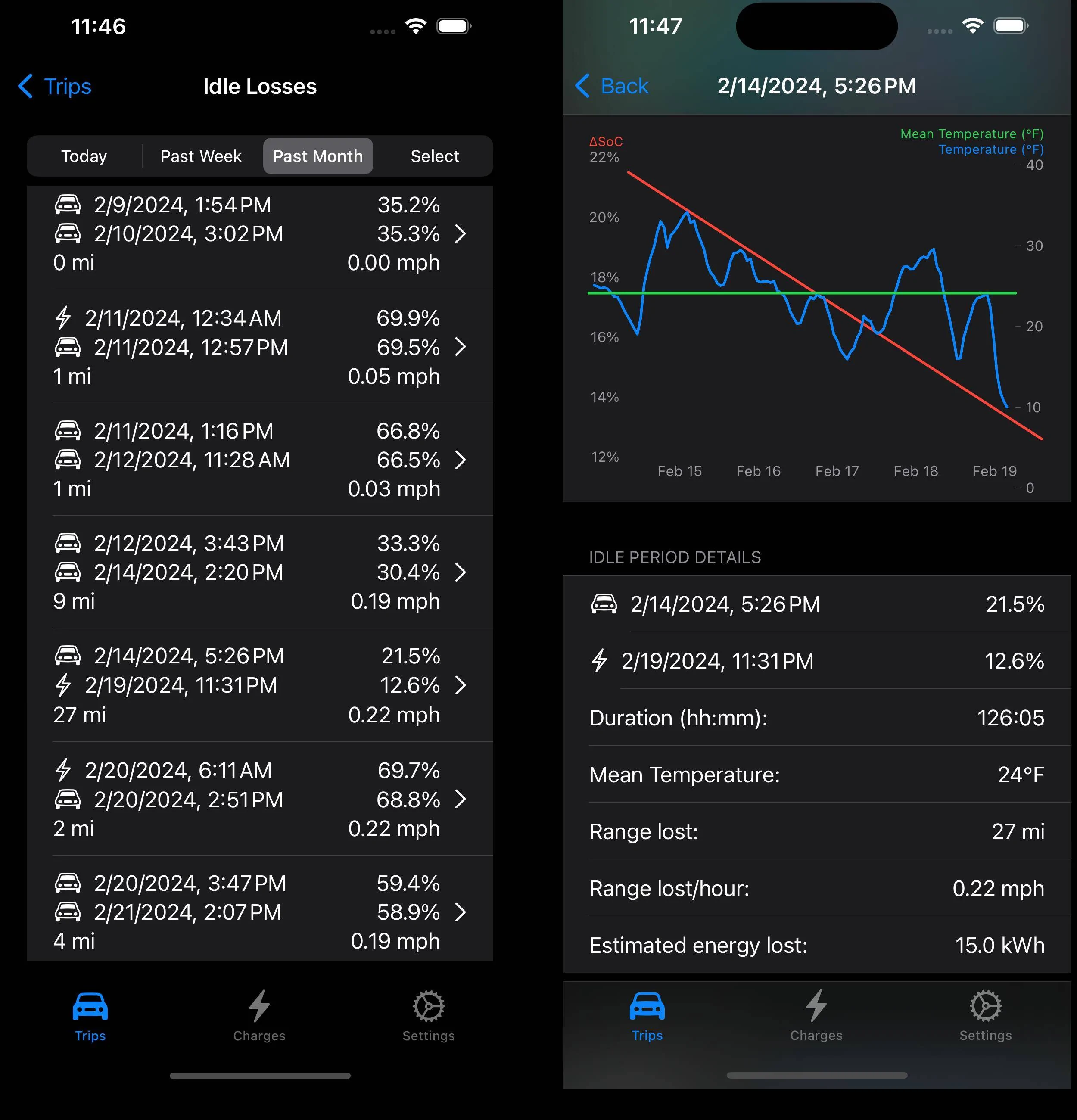

Pretty familiar with the Rivian, I think I have controlled for those cases, plus this has been an ongoing complaint for others. Even if I didn't the results would be similar and not appear to vary with the temperature.
Like the Mach-E, I created an app to record ,my trips and charges and one feature I implemented that I didn't need for the Mach-E was a idle period tracker which displays a list of times the vehicle sat for more than 6 hours along with the loss in range (the details of a single idle period shown below):

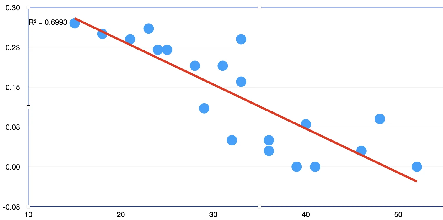

Because I added historical weather data from Apple Weather, I can calculate the mean temperature for the idle period and the results seem to seem to be predictable. While I haven't yet coded a scatterplot of temperature and range lost per hour, putting the data into a spreadsheet visualizes my results:
