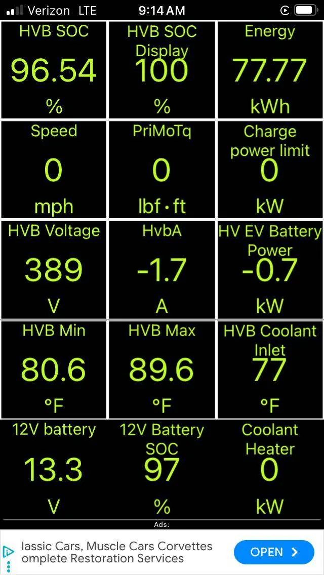

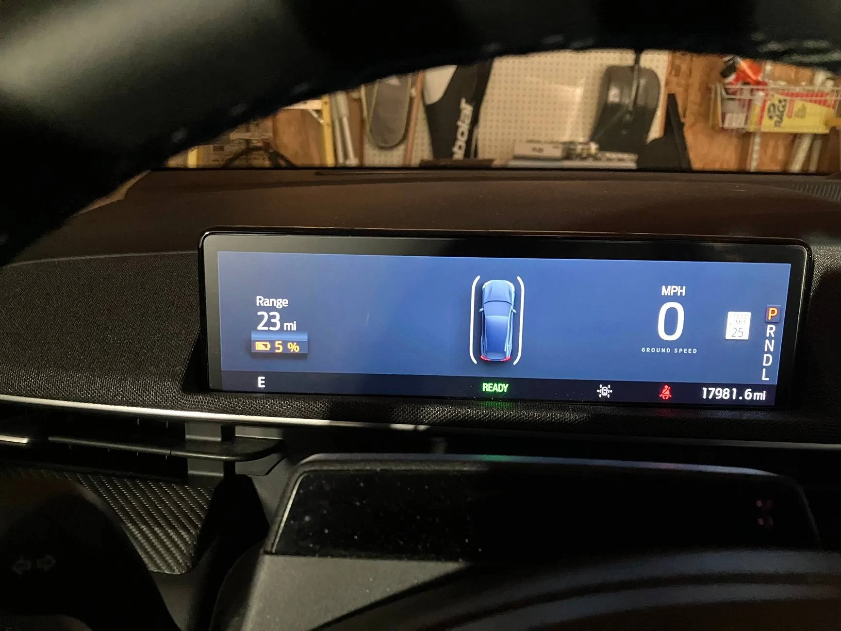

Here's an update on my battery SoH. After charing to 100%, and driving all week without charging, I finally got back down below 10% displayed SOC after driving 281 miles. My GOM now says I have 38 miles and 8% battery left. Energy to Empty is 10.77 kWh. HVB SOC is 12.56%. HVB SOC Display is 8.5%.
Seems like a pretty healthy battery to me. The scanner isn't impressed. HvB SOH is now showing 78.5% ¯\_(ツ)_/¯ . Now I'm plugged in at home waiting for my scheduled charging time to start charging back up to 90%.

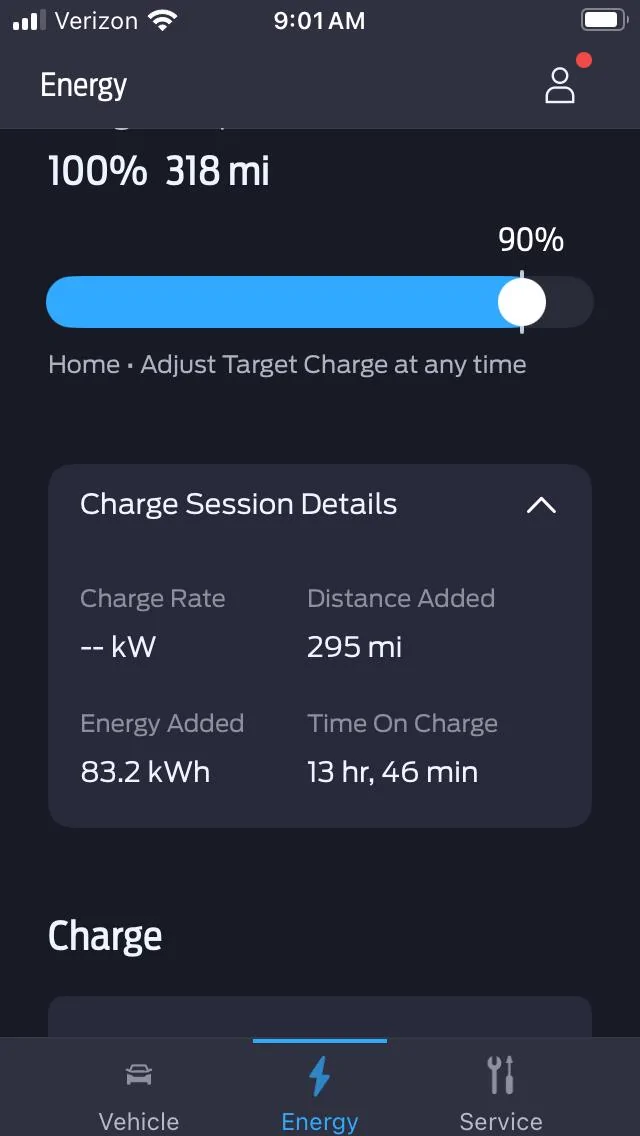

After charging back to 90%
Ford app energy added : 71.7kWh
Scanner HVB SOC: 86.5%
Energy: 70.88kWh Energy to empty
HVB SOH : 78.5%

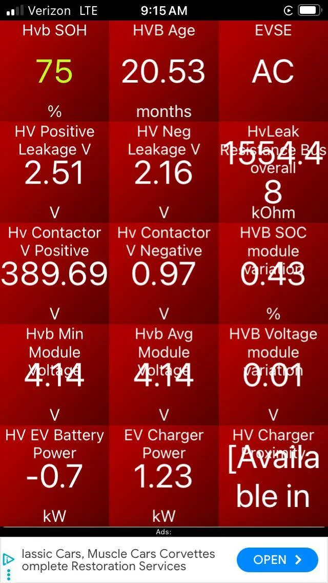

Here's an update on my reported SOH. It's trending down.
I just go back from a 600+ mile road trip after which I ran my battery down to 5%. Charged back to 100% overnight. After sitting at 100% for a couple of hours, I checked my SOC and it's reading 75%.
At this rate, I might be eligible for a new battery before the end of the year.

The BECM measures how many amp hours go into the pack during a charging session, and uses that to calculate the battery capacity. Which is converted to a State of Certified Energy percentage. So it should be a direct measurement.
Warranty does go by the official certified SoH value (which is the same as what Car Scanner reports), so he will get a replacement if it hits 70% unless they can get it to recalibrate to a higher SoC value.

I'll add a couple more bits of info related to energy added. The displayed SoC before I started charging and the reported energy added for the charging session.

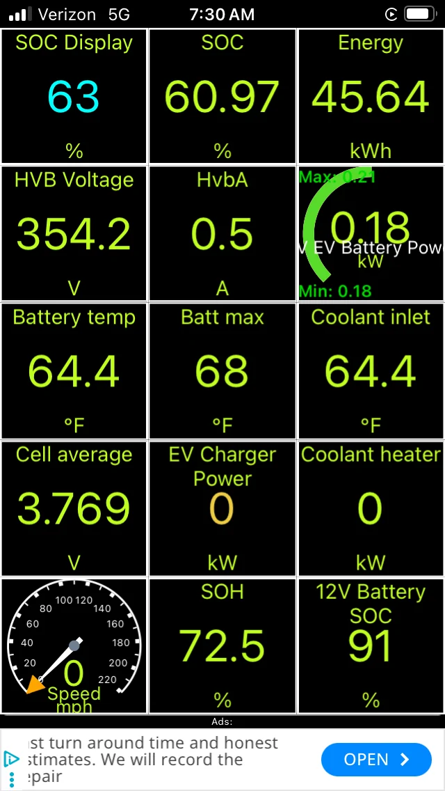

My HVB soh is now down to 72.5
Ford Mustang Mach-E HVB SOH 80% IMG_5212
Car is at the dealership today. I asked them to check the HVB. They said they don’t see any issues and I shouldn’t trust any third party scanner tool data.
11,449
25,276
There won’t be any issues, just low health. What do they say the battery state of health is?

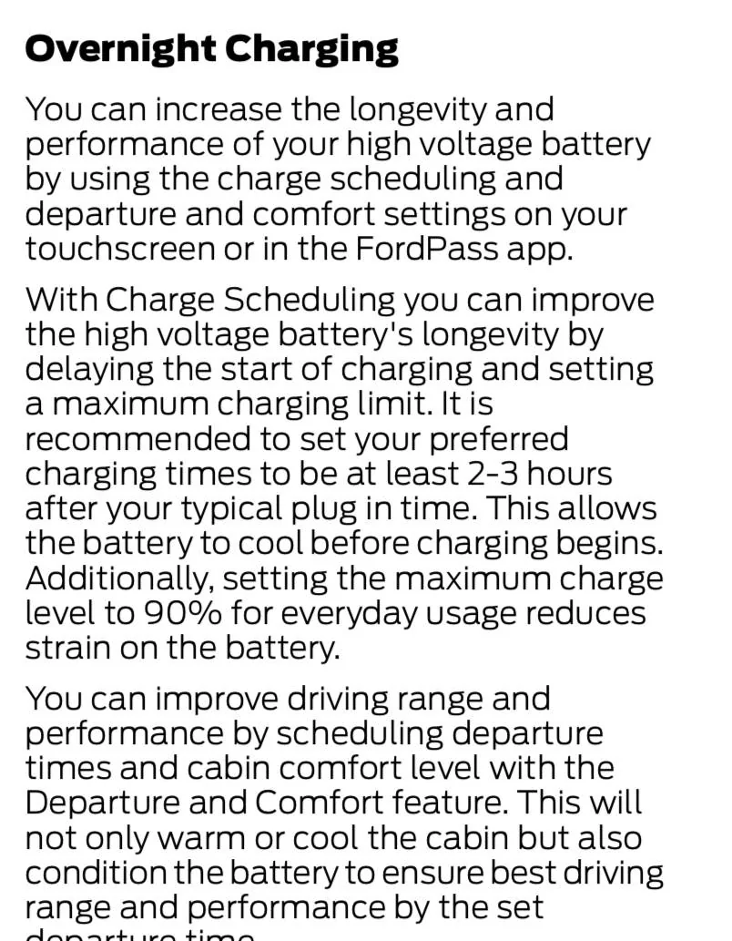

Based on the graphic above from the manual, it is better to schedule a charge hours after arriving home versus plugging in right away. Is that correct? Doing that will allow my battery to cool down before charging. I usually plug in to charge as soon as I get home to bring it up to 80% after my short commutes.

In theory, yes, it’s better to let the battery cool before charging.
In reality, the AC charge rate of about 0.1C won’t make a meaningful difference either way.
