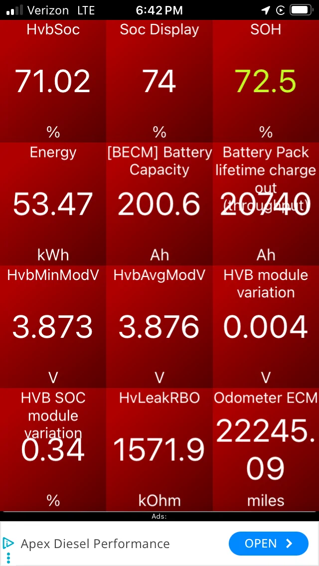

I believe this is the HVB State of Health.
Ford Mustang Mach-E HVB SOH 80% IMG_5223

Yes, the SoH value on my car matches what FDRS and PTS says (which is what Ford goes by for warranty). It’s for the high voltage battery; there is no state of health parameter for the 12 V battery.

Do you have a ‘23? My 23 had the BECM glitch where the charge port never shut off after reaching the target charge. Always wondered how bad that glitch threw off the battery calibration numbers. My car is about 2 years old now and the SOH was down to 86%. I did the MachLee calibration procedure and it is now 92 which still seems low on a car with 13000 miles and a gently maintained battery with 25-50 percent charge sessions and keeping it around 40% or lower during the hottest time in the summer in MA.
