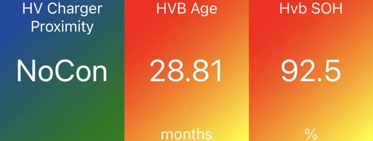

I had the same issue I noticed a few months back. I was down to 88%. There is a lot of different views on how to charge. I read on the forum to charge everyday, even though my normal drive is only 40 miles round trip, and I use only 16-20%. What I have since learned is that the battery likes to be deep cycled more. I now take it to 15-30% before I charge. Then I charge to 90%.
Once a month I charge to 100%. That is key because that is where the electronics does it magic in cell balancing. 100% is NOT a bad thing. If you need it for a trip, then do it. It actually helps than hurts.
Since using the methods Mach Lee posted, my SoH is now 92.5. You get a lot of advice here on the forums, some of it bad. Find what works for you and go with that.

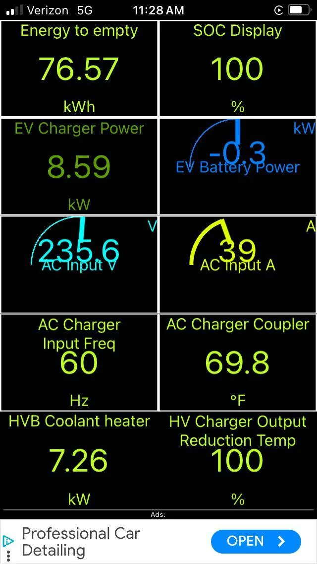

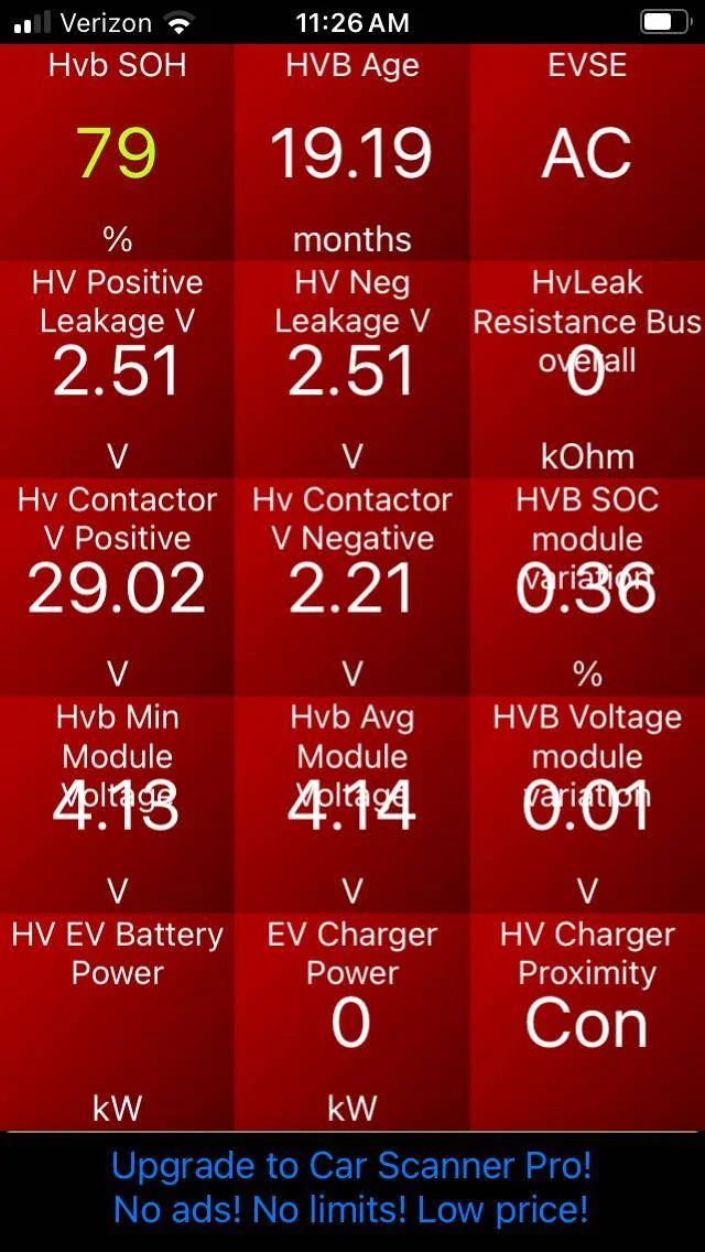

After completing steps 1-5, step 6 results are not great....
Procedure (NCM packs):
  1. Charge the vehicle to your normal level (e.g. 90%).
  2. Drive the vehicle (without charging) until the battery is down to 5% or less.
  3. Park the vehicle and let the battery rest for at least 5 hours (preferably overnight)
  4. Level 2 charge all the way to 100% in one session without interruption.
  5. Leave the vehicle plugged in and let the battery rest for 3+ hours after 100% is reached.
  6. (Optional) With a scan tool, read the kWh to empty and state of health parameters.
  7. Drive without charging until battery is below 50% (10% recommended)
  8. Charge the vehicle back up to your normal level.
  9. Repeat if desired.

The EtE value is also very low, and correlates pretty well with SoH. Unfortunately. I suspect it won't get much better based on what I saw in my MME. But a few more charges to 100% can't hurt IMO.

Thanks for the replies. I'm not going to worry too much about this. The range is more than enough for my needs including on a recent 1800 mile road trip. I am curious why my numbers are so low after only 17 months of ownership and 16,000 miles.
I'm going to continue with the rest of the calibration process and maybe try it again in a few weeks. I'm also tracking how many miles I get from 100% to 10% SoC displayed. From 90% down to 9% it was only 209 miles. That surprised me.
One more question, Charging from 9% back to 100, my Ford Pass app reported 80kWh energy added, my charger reported 87.19kWh added while my Energy to Empty was only showing 76.35kWh, how does that align with what others have seen?

i've been keeping an eye on this thread because i had created a SOH tracking dataset here and this would be the lowest SOH seen thus far
overall i wonder what the ford method for testing / validating the battery for warranty purposes is. it seems like you may indeed be on track for a warranty, but in some ways means it doesn't really matter.......

As for energy added from charger and what actually went into the battery, your results aligns pretty well with mine. It’s about 10% (give or take some) losses. My battery seems to max out at around 85 kWh, but when charging it can go above 90 kWh added from charger if I went deep.
Thanks,
Yeah that proves the SOH estimate is just off and your battery seems almost full health. Not sure why it’s not updating.
I hope it's just the estimate that's off. My driving and charging habits might have confused the algorithm. Prior to running the calibration routine, the battery was never below 25% and seldom below 50%. Maybe it needs to see more data at the low end of the range. ¯\_(ツ)_/¯
