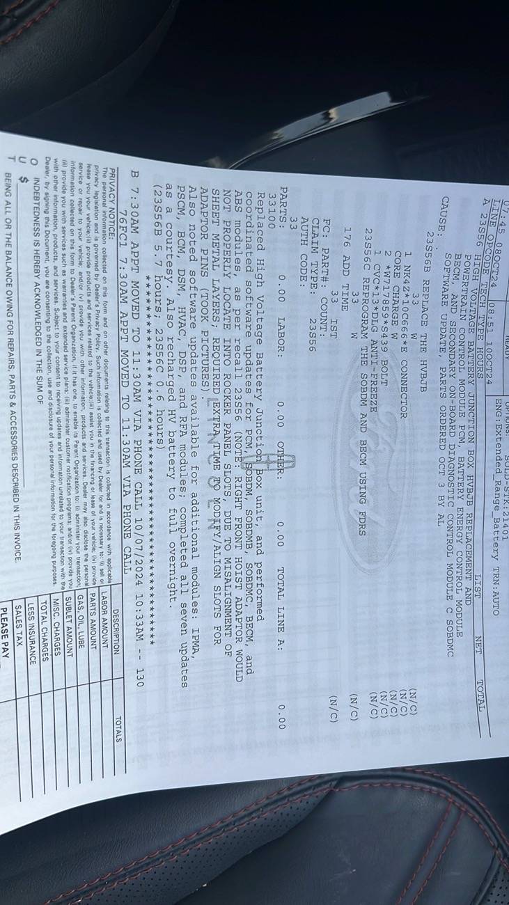

danielcb
Daniel
May 9, 2022
168
98
British Columbia
Mustang Mach-E 2022 ER AWD
Fantastic turnaround.
You can see in my work order 5.7 hours. Apparently FDRS found a lot of modules requiring updates.
Thats really nice they updated modules that had FDRS updates available. They usually don't do that for an afraid ( lack of knowledge ) of breaking things, usually. At least that what the Key West Ford (New Westminster) people told me when I did the HVBJB replacement...
