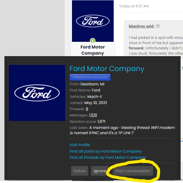

@Ford Motor Company any chance you can assist ?That is where the NHTSA comes into play. They can make sure this gets fixed. Very bad publicity in the automotive press and ambulance-chasing attorneys play a role too.
Hey there, David! Can you please send me a PM with your VIN and dealer name/location so I can look into this reversing concern for you? To send a private message, just click on our username and select "Start Conversation". I'd be happy to see what I can do to assist!My wife just called me and encountered this. Parked in the garage, was a bit close in, so turned the shifter to Reverse, and when went to back up a little, it went forward (into the shelves, damaging both the shelves and scratching the car’s paint).
