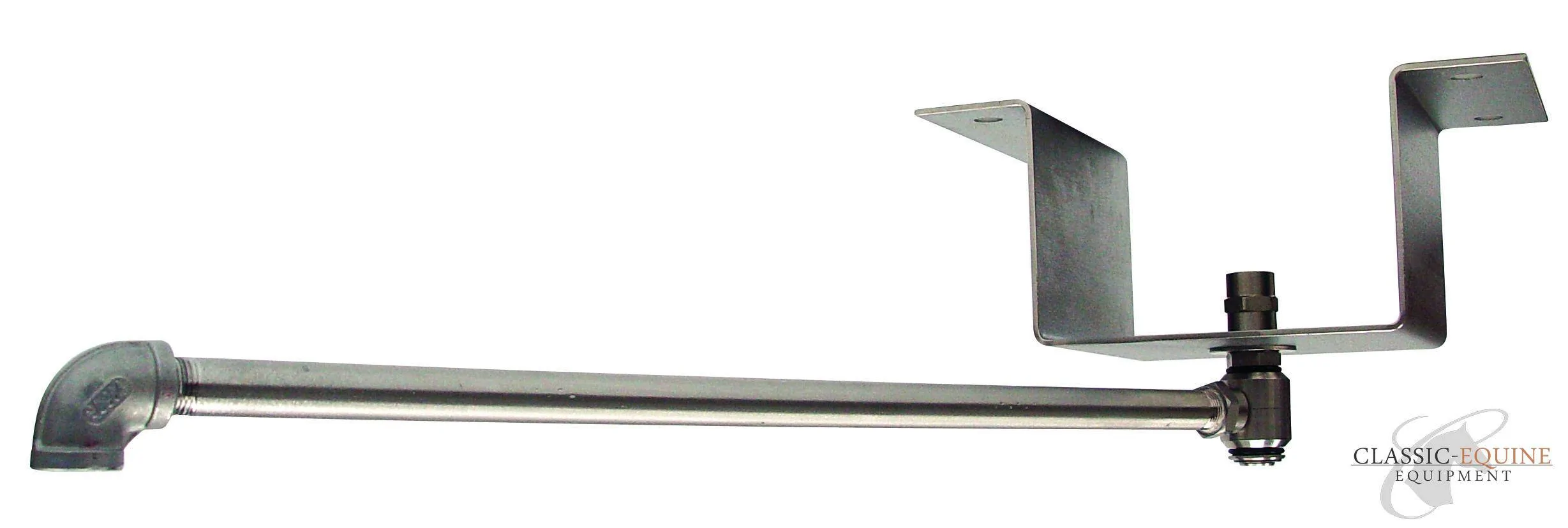

I'm searching forums and the internet, but figured I would see what ideas people had here.
Situation:
3 bay garage
EVSE is mounted just to the left of middle bay
Mach-E is parked in right hand bay. Currently, EVSE cord is running across the front of the middle bay, then out to the Mach-E. Works perfectly.
Near future will have a Lightning in the middle bay. Longer term solution is to get a 2nd JB48 ($95 after rebate from utility and 30% tax credit on remainder), share circuit, only extra cost would be IF I have an electrician come to put 2nd JB48 cord into box and connect with existing connectors.
Problem:
Truck will be parked all way in. Passing the EVSE handle over the truck back and forth would be a PITA. Want easy, inexpensive way to move charging cord from between bay 1 and 2 to between bay 2 and 3.
Before pulling truck in, if car is done charging (likely), move cord to position for truck. But, if you then take the car out, and come back, and need to charge car, cord is on wrong side and can't be easily passed over truck.
Desired Solution:
Run cord up so that it's above frunk height of truck, then somehow by suspending cord, and handle, from ceiling, be able to pull handle from bay 1/2 to bay 2/3 and back again.
Given that I can share the circuit with two JB48s, that's my long term solution (don't need 80amp charger for truck). But I'm looking for say a pivoting arm or inexpensive tool balancer, coupled with a way for the EVSE handle to be pulled to the vehicle that needs it.
One idea I had was like a shower curtain track, running side over the middle bay, with handle hanging from a cord. Each side could pull the handle towards them, and cord to pull it would run up to a pulley on the ceiling and then come down to dangle between the bays.
If you've come across any neat inexpensive solutions, please post them here.
I have not seen this idea but the design of the wash wand & hose in car wash bays that can swivel around 360 degrees from a pivot point overhead comes to mind!
