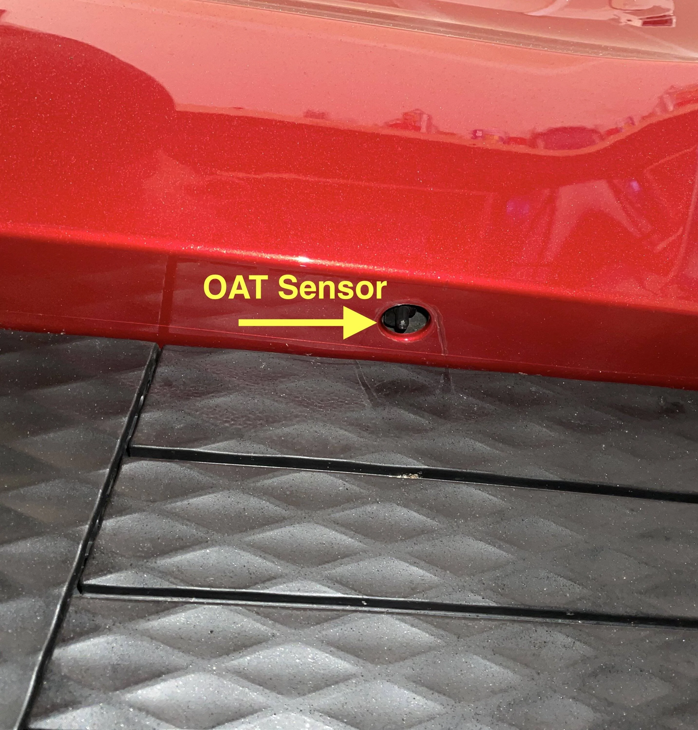

Interesting. If you got front PPF, make sure they cut the hole open around the temp sensor above the grille shutters. Common install error with front PPF on the Mach-E.
Another factor is the temp 16" above the pavement is going to be sometimes 10-15º hotter than the temp measured at the standard weather station height of 78". So the air flowing over the sensor could actually be that hot. That is also the temp of the air flowing over the battery, hence the warning about plugging in when it reads 113ºF or higher.
