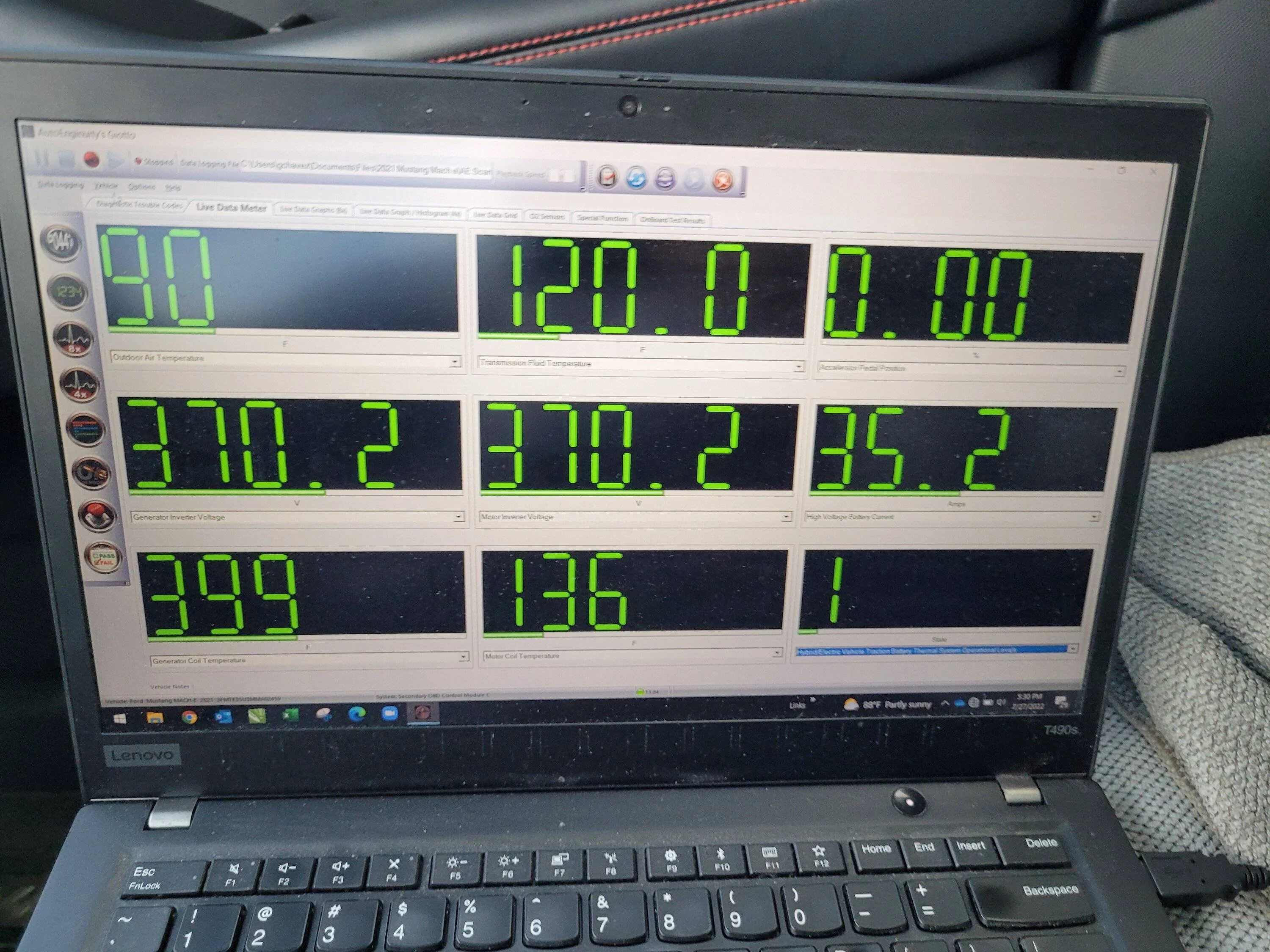

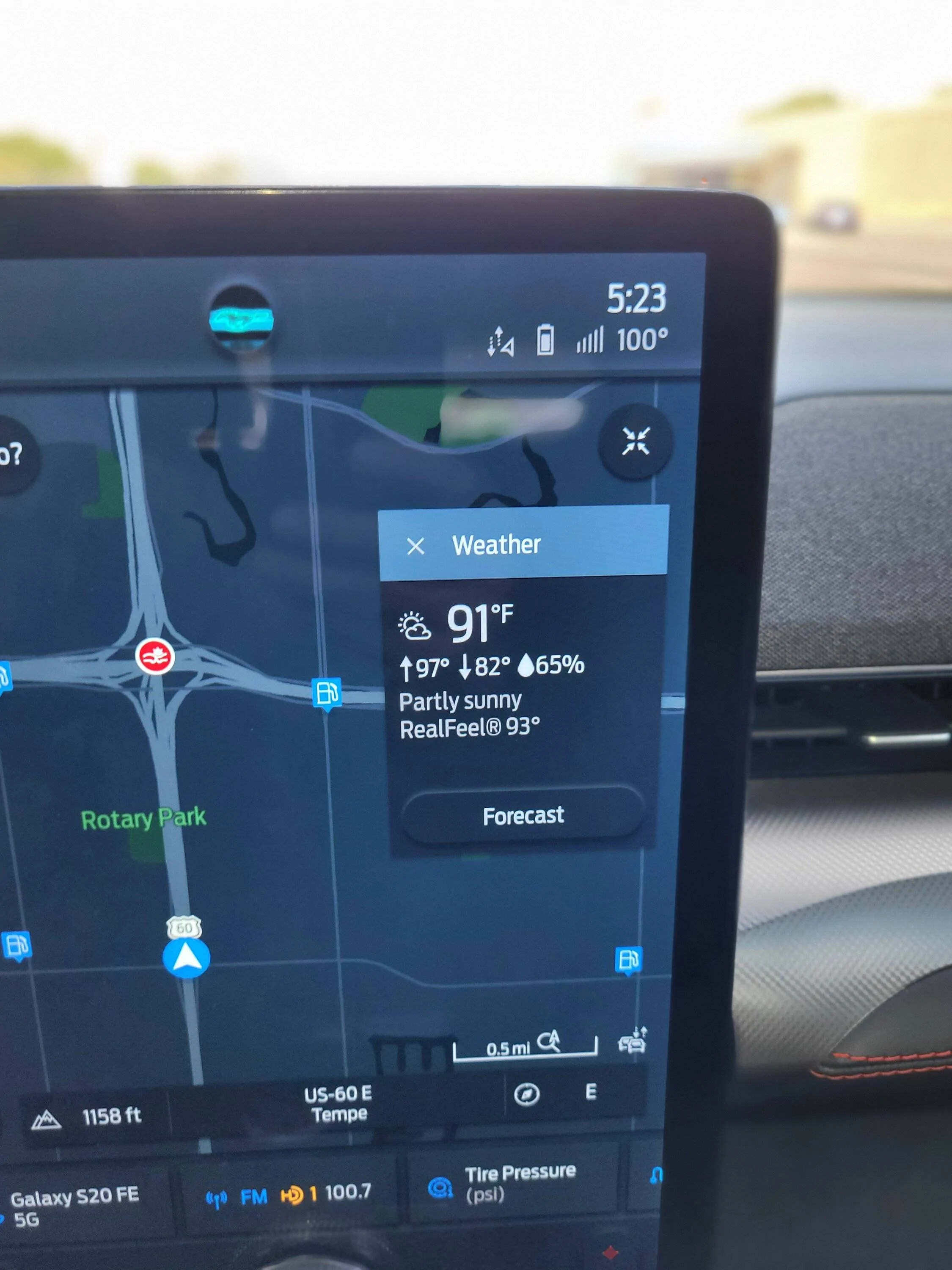

So check this out....
It appears Outside Air Temperature as reported by SOBDCM C is actual ambient. We tested it on the drive home. Check my process and let's see if you agree with my conclusion.
I followed my nephew in his 2020 Ford pickup on the way home. My son rode along with him and texted me with updates to their temp display in the truck.
Started our vehicles and my reading was 91F while theirs was 86F. Within a couple hundred feet of driving, my reading matched theirs (86F). Then they both tracked together. Pulled out onto the road in front of our shop and temps increased to 88F. Freeway on ramp was 91F. Stuck in traffic on 1-10 at 93F and stabilizing at 95F.
Clear the congestion and drops to 90F. The section of US-60 that flies over the train tracks drops to 88F.....both vehicles. Then back to 90-91F for the remainder of the 20 mile drive.
I data logged most of the trip. Will sort through the data and see what info (if any) that jumps out at me.
Data captured is
1. Outside Air Temp
2. Generator Inverter Voltage
3. Generator coil temp (not a real value)
4. Transmission fluid temp
5. Motor inverter voltage
6. Motor coil temp (seems valid)
7. APP
8. HVB current
9. Hybrid Electric Vehicle Traction Battery Thermal Operation Level (what just curious what that was about....)
So, do we agree there is a value in the SOBDCM C that knows actual ambient temp? If so, how does it determine that value? Seems fairly accurate.....for today's drive at least.
Oh BTW....the Sync screen started at 95F and stayed that way for about 5 min then it rose to 100-101F and consistently remained 8-10 degrees F above whatever the SOBDCM C was reporting as actual outside Air Temp.
Yes, seems like the actual temp but it has to come from the ECM/PCM since the SOBDMC doesn't have an ambient temp sensor wired to it. Only motor temp and trans fluid temp.
The service manual lists this for the SOBDMC:
Ambient air temperature filtered (source: ECM) - Ambient air temperature, used to adjust high voltage battery cooling fan speed
Still no idea why the display would show a much higher reading than what you saw on the scan tool. It should have come down to match if you were driving for 5 mins.
Thanks for that extra info. HVB cooling fan is a funny description, but I get what they actually mean there. :)
To clarify......
I have found air temp in three different modules so far...
  1. PCM: Listed as Ambient Air Temp and it shows the sensor voltage as well as temp value
  2. HVAC: Listed as Filtered Ambient Air Temp and it showed the same temp value as #1
  3. SOBDMC: Listed as Outside Air Temp.
# 1 and #2 match what is shown on my sync screen. That value did change after driving for about 5 minutes.
#3 was a different value and was static until I put the car into motion. After a couple hundred yards it began to show a different value that matched almost exactly to what my nephew was showing in his pickup while we both drove on the same road at the same time. We drove for about 20 minute and it tracked the same throughout that drive. It amazes me that value was so accurate or at least in alignment with what his truck was reporting as ambient temp so I am super curious how that value is determined.
I believe the display gets it's value from the HVAC module, which says it is "filtered" (whatever that means....). I did look at the HVAC PIDs and found a setting for Filtered Ambient Temp. That value matched the Ambient Air Temp sensor in the PCM at the time I looked at it so I don't really know what filtered means. Does that mean it is sampled less frequently, or perhaps the value is adjusted by a factor or equation or maybe even something else entirely? ?
