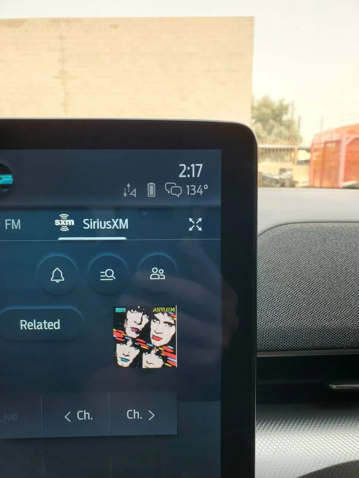

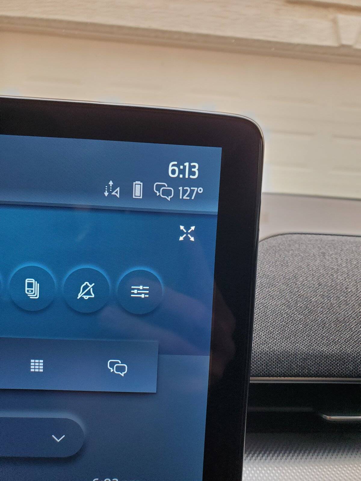

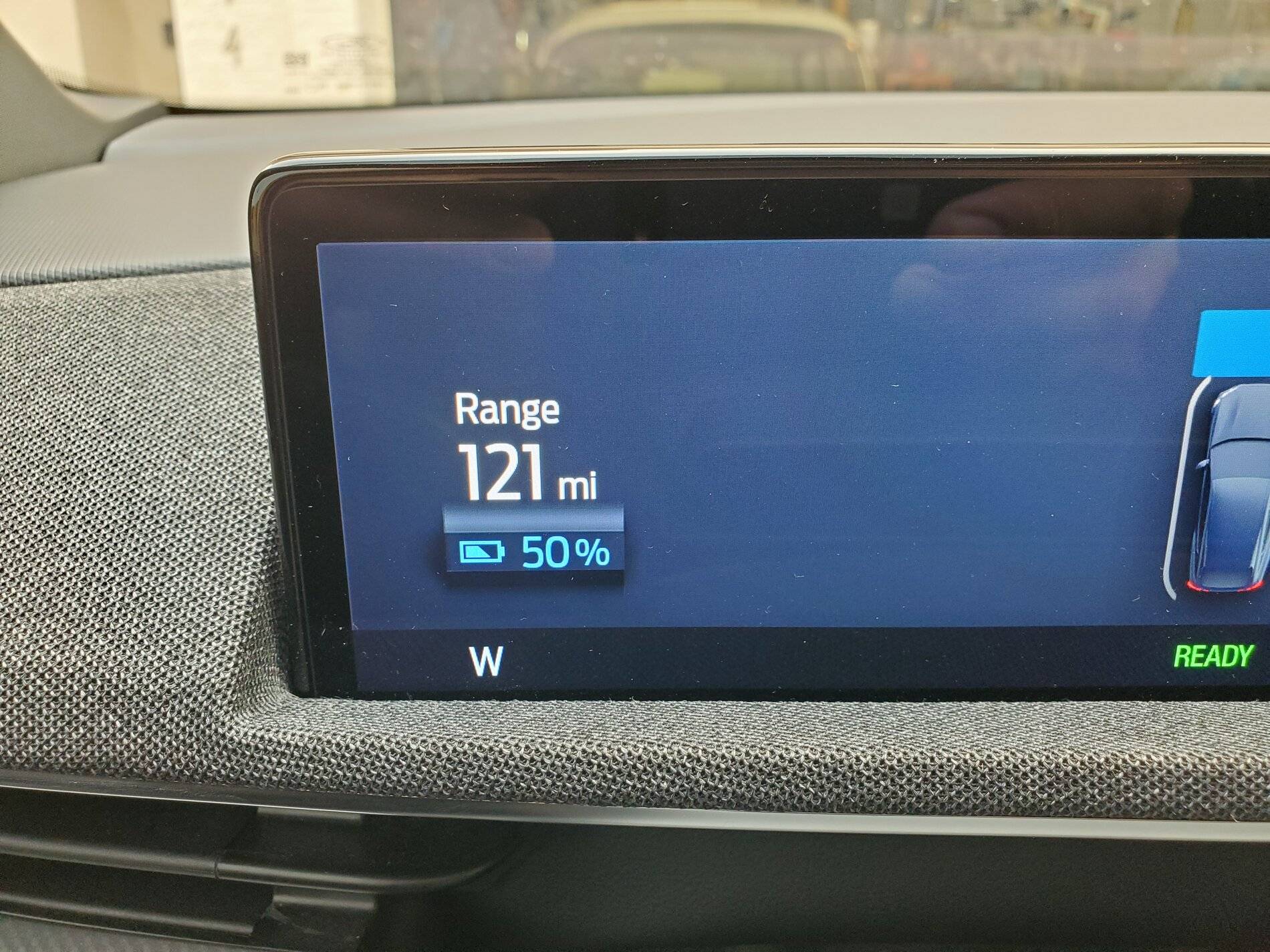

The ambient temp sensor must be influenced by the heat under the hood. It said 127 in my driveway but that is in the shade when I get home so there is no way that is accurate. I got out my IR temp meter and measured 104 degrees at the closed louvers. Measured the pony emblem and it was 117 degrees. Started the car to open the louvers and pop the hood and measured 117 at the radiator (portion exposed through the louvers) and 132 degrees in the front compartment area. No way any ice is going to last very long in there so the shrimp feast is going to have to wait until the fall. :)
Lastly. Range impact at these extreme temps is 20%. My normal range is 300 miles if the temperature is 105 or less. 115 degrees or more and range drops to around 240 miles looks like...
Thank for all of the helpful replies. If the MME is reading the temperature close to the pavement and managing the cooling for the battery appropriately, then I'll just have to get used to it. It is certainly different from our 2018 Ford Edge.

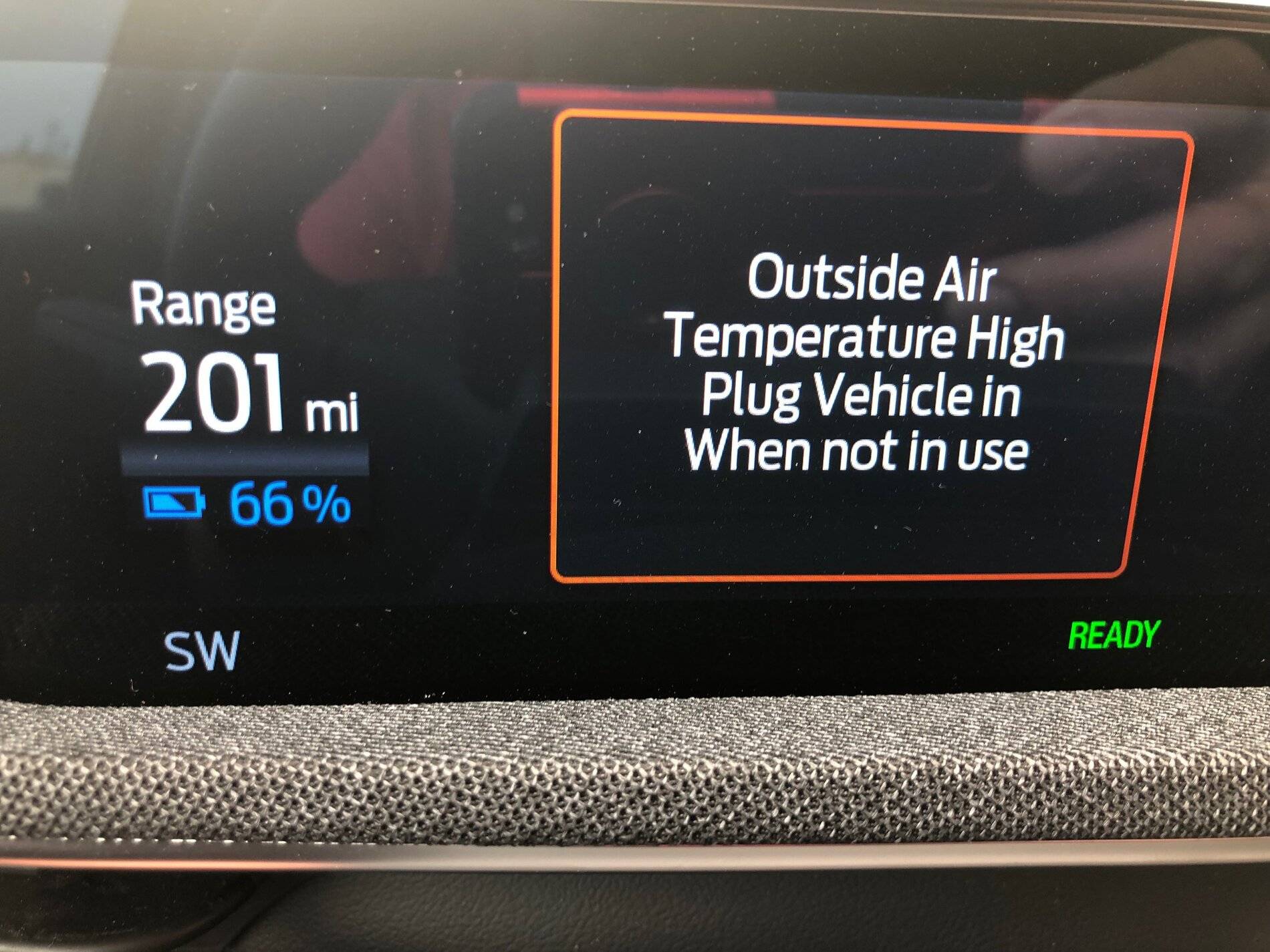

I haven't seen a significant decrease in range with the Phoenix heat, but the High Temperature warning message has become a familiar sight.

This has been my experience too. It seems the temperature sensor updates relatively slowly.
I think it is very common to get an off-the-chart high reading in any car if you have parked in the sun when you first turn it on, but OP noted in one of his posts that it seems to last while he is driving.
For me, however, the temperature corrects itself after a few minutes of driving. For example, when I drove my Mach-E on Sunday at midday, it was in the high 80s/low 90s in Los Angeles, but I distinctly remember that the Mach-E was showing only 67 degrees. It stayed at 67 degrees until I was driving for a minute or so and was about a mile from my house when it started to jump up by several degrees ever couple of seconds before it stabilized in the high 80s.
The photos I posted were taken while driving in suburban Phoenix traffic. I think the idea that the outside temperature that is being reported is the temperature close to the pavement (and therefore close to the batteries) makes sense. It is hot here in Phoenix, but 129 degrees is Death Valley, not Phoenix!

If driving in ambient temps over 113F and caught in a traffic jamb moving at a slow crawl then the car will start to over heat. When that happens, the A/C to the cabin is limited and starts to blow warm air. I presume this is because the battery takes priority over the passenger compartment. Temps on the Sync screen will exceed 140F during this process.
This was never an issue last year so something changed. I can only presume the change is software related but I don't know that for sure. Maybe last summer was mild compared to this year?
At any rate, the first time it happened to me this year.....the display was reading around 120F like normal and then I got caught in a traffic jam. I was on an incline in 1PD and watched the temp display count up from 123F to 142F in the span of 60 seconds or so. Then the A/C started blowing warm and I was starting to panic. I turned off 1PD and the temps stabilized and even began falling. It dropped to around 135F or so and then traffic started moving again. Once I got up to 40-45 mph then the temps fell like a rock. All the way down to 112F where it remained for the rest of my 40 min drive.
I don't know what temp the car needs to be plugged in to cool. Seems like anything in the 115F and above displayed on the Sync screen is a good bet the car will start cooling when plugged in. Doesn't happen every time though. So I am not really that certain. ??

Separately. as you can see from the other replies, Phoenix drivers are reporting displayed temperatures of 135 to 142 degrees. The car apparently overheats at those temperatures. That is a much bigger issue than the temperature variances I reported last year when I started this thread. If I knew the 21P22 software update would increase the likelihood that my car will overheat in Phoenix in the summer, I would not have done the update in the first place.

No car would display the "correct" ambient temperature you think of. The temperature from weather report uses a specific setup - typically shaded 1 meter or so above grass area. Your car with a temperature sensor 1 foot over a pavement under the sun will measure much higher temperature. It is the true temperature at where the sensor is. The car is not smart enough to know how much it is higher than you "correct ambient" temperature.

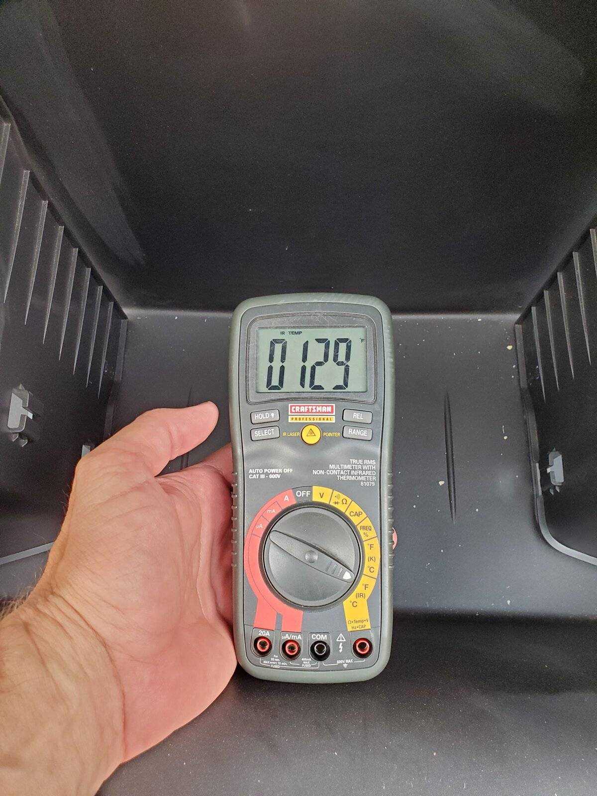

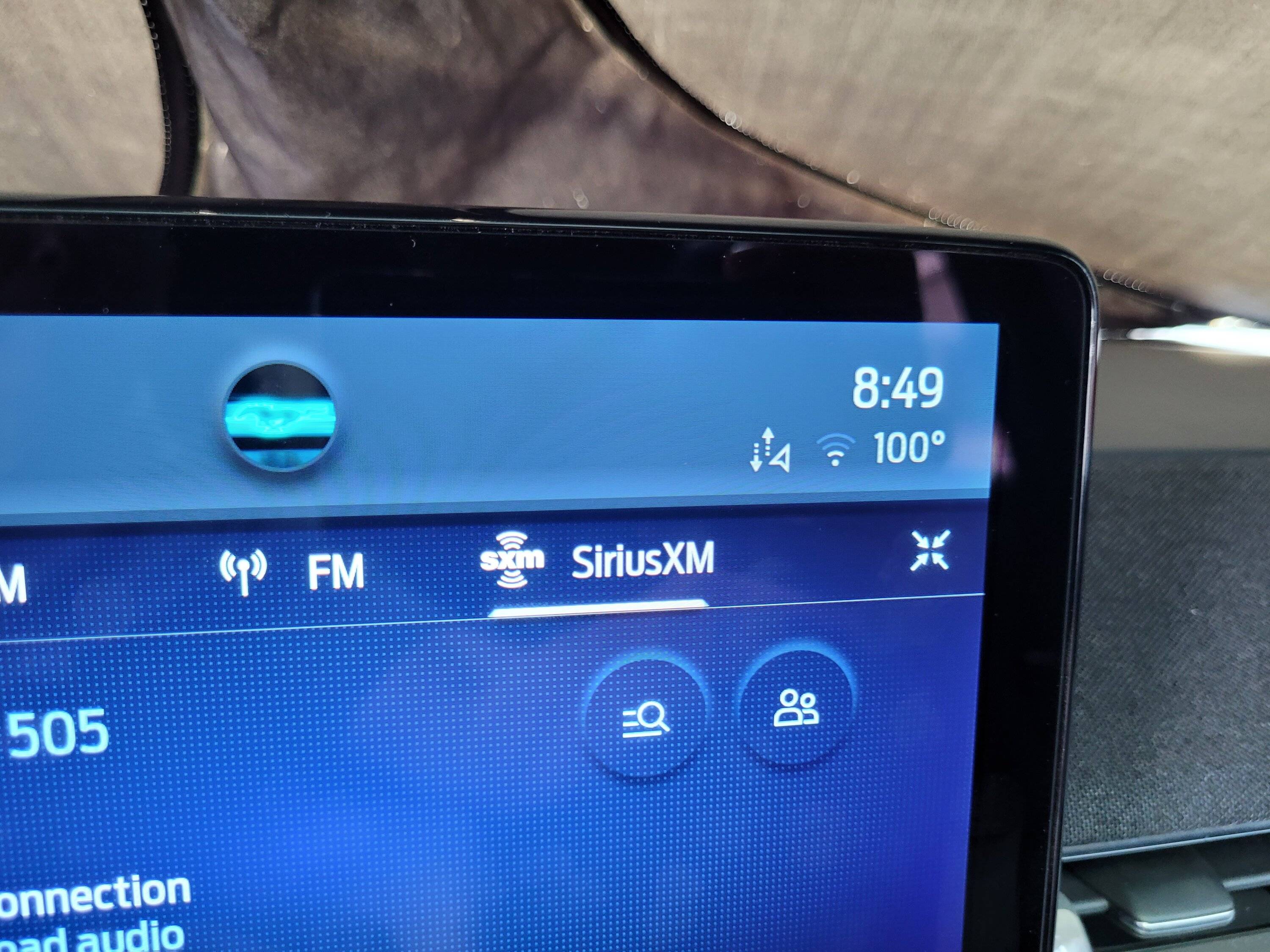

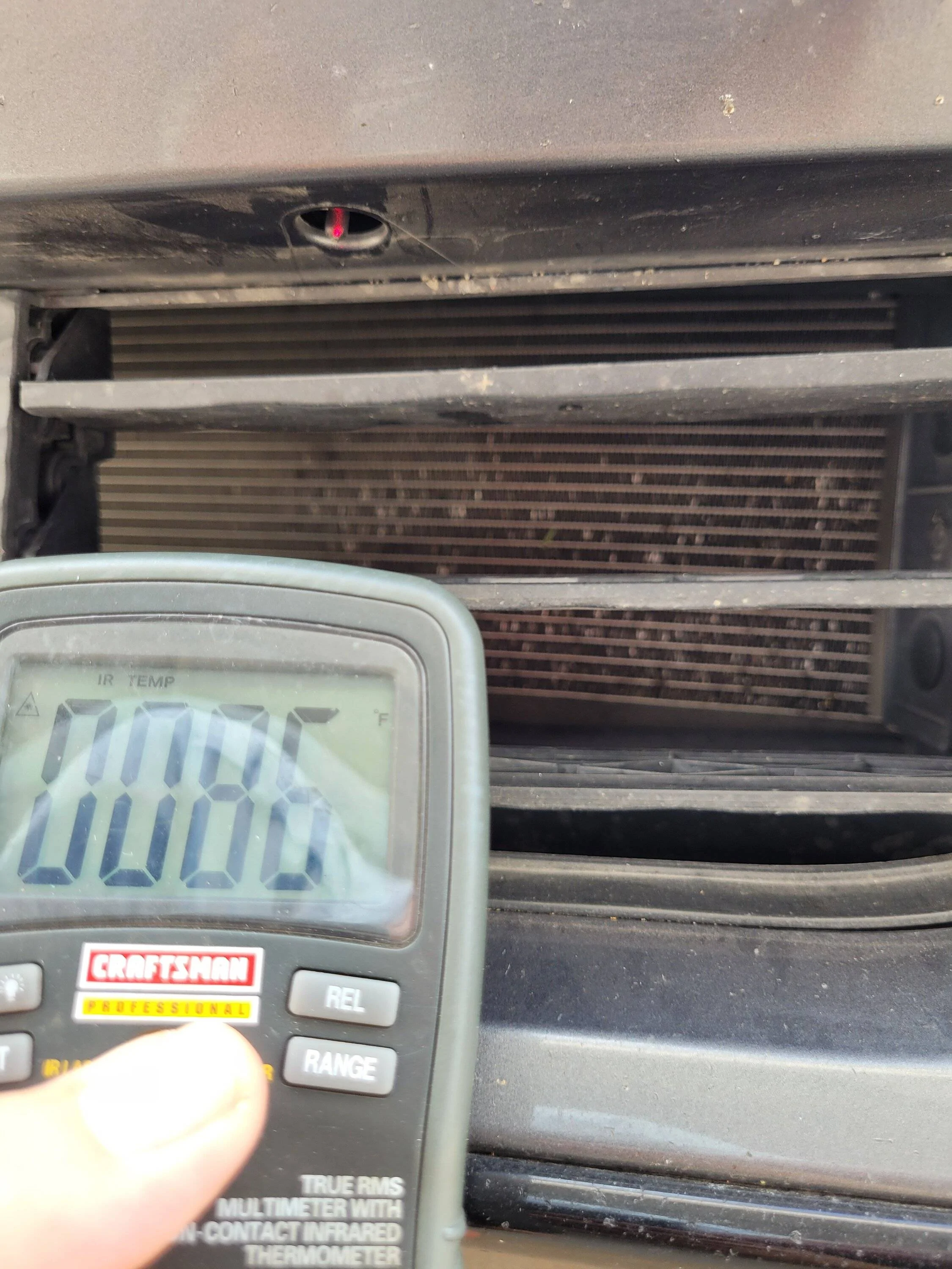

The temp displayed on the Sync screen appears to get its data from the temp sensor under the good vs the sensor in the bumper above the louvers. Not sure why Ford did that.
I have measured it many times. The temp displayed on the screen matches the temp of the front trunk compartment and not the ambient.
That being said, now that I know this. I can use the temp display on the screen to determine when the drive train is adequately cooled or when it might be overheating. If they get too hot then I can adjust my driving accordingly. Same as when driving an ICE and the temps approach the limit.
