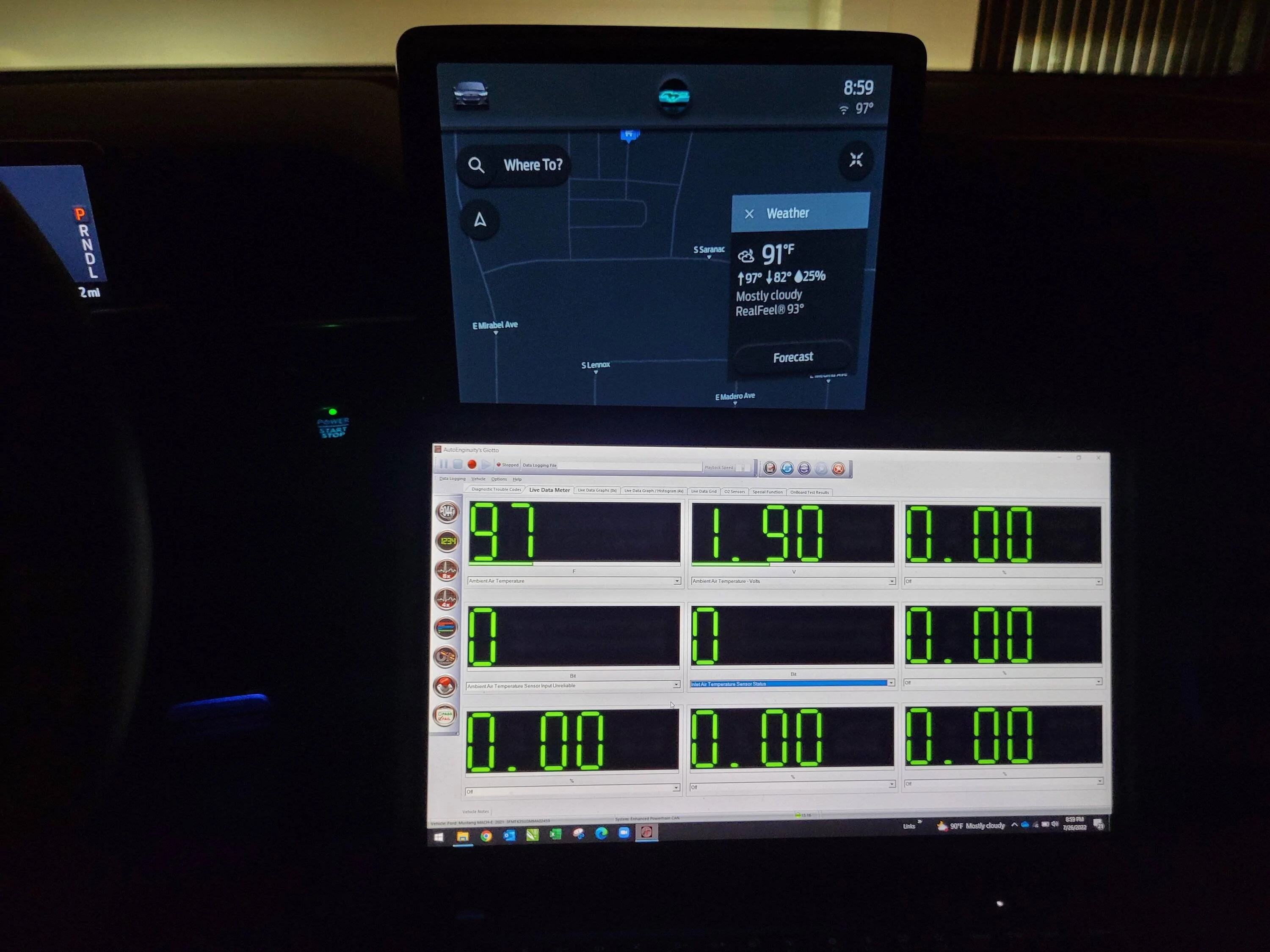

I think I found it.
There is a temp sensor out front in the bumper and several temp sensors under the hood. One of those sensors under the hood is picked up by the APIM as ambient air which is really air intake temp in an ICE. The PCM for an ICE needs to know the under hood temp to calculate air density for fuel trim so the terminology is similar but not exactly the same.
The sensor out front in the bumper is picked up by the SOBDCM C as outdoor air temp. That reads correctly. I measured ambient temp at that sensor with an IR temp and a thermocouple device and it showed 87F, just like the scan tool shows.
Then I measured the various components under the hood and they were all right at 97F, like the Sync screen shows.
At this point I can only suspect a programming error in respect to which sensor is being looked at for the Sync screen reading. When I get time, I will unplug that sensor up front and see if the Sync screen temp display changes at all. I am willing to bet it won't be affected.

I think I found it.

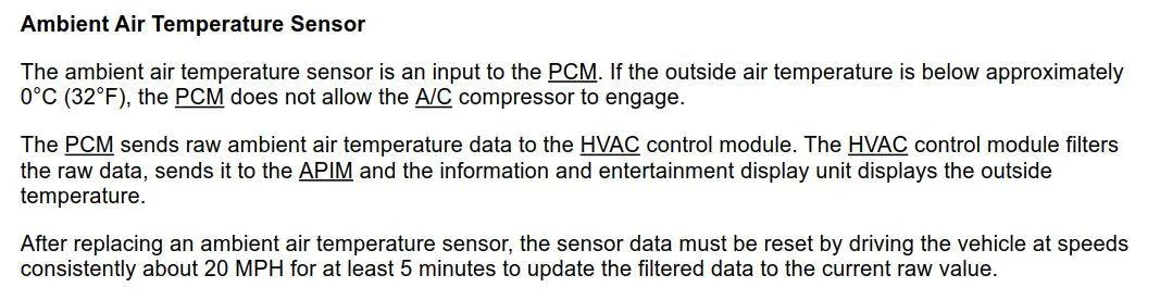

The bumper sensor is called the ambient air temperature (AAT) sensor and is actually wired directly to the PCM. The PCM reads the value and sends out the reading to all the various modules on the CAN busses. There are no other ambient temp sensors outside the cabin or under the hood. Only coolant temp sensors.
The temp reading parameters will not update when the car is stopped. Basically I did an experiment where I blew a heater on the outdoor temp sensor with the ignition on, and none of the readings changed anywhere. It continued to use the last temp reading from the last time the car was driven, even though everything has fully cooled down (parked for 12+ hours and garage was ~15ºF cooler than last reading). Nothing in the car was as warm as the last reading.
The current software will not update the outdoor temp unless the vehicle starts moving, I think the spec is you have to drive above 20 mph for at least 90 seconds before it will update. Below that speed it probably uses the last value.
I will have to double check the outdoor temp reading in the SOBDMC again, IIRC that didn't change on my car but it seems to on yours. Perhaps that is a difference with the newer software. Yours might not have the averaging algorithm on everything while stopped.
I think the PCM is still sharing the live AAT readings in the background, that's why the SOBDMC was updating even though other indications weren't? It's not because it has it's own sensor. You can try the hairdryer test too while parked to see what changes and what doesn't.

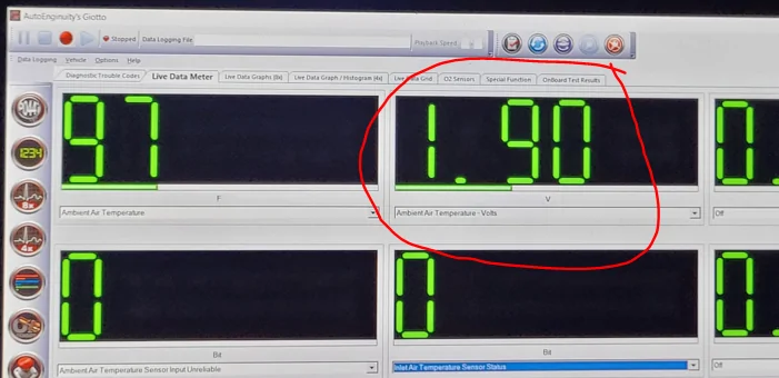

I tried same basic test as you with same conclusion. In my case, I had to drive around for 5 minutes before anything changed. Even the SOBDMC reading remained static while parked. I found this note in the WSM...
Ford Mustang Mach-E Outside Air Temperature Discrepancy 1658945142540
The only volt reading I can find was in the PCM, which is always a clue to me that reading comes from an actual sensor vs a calculated value.
Ford Mustang Mach-E Outside Air Temperature Discrepancy 1658945857121
The values displayed in the SOBDMC and HVAC module don't have a volt value so those are either calculated or now apparently shared from some other module such as the PCM? That kinda complicates things because I like knowing if I am looking at an actual reading or something from a look up table.
I think I will try one more experiment and report back what I observe.....let's find out if those reading change when stopped but still in D (not in P).

There is a PID in the HVAC module for "Unfiltered Ambient Air Temp". I looked at that while driving and it was the same as the temp displayed on the screen.
Maybe that temp display on the screen should read "Road Temp". Which would match the speedometer anyway......

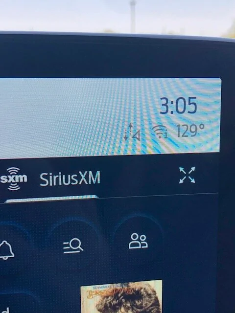

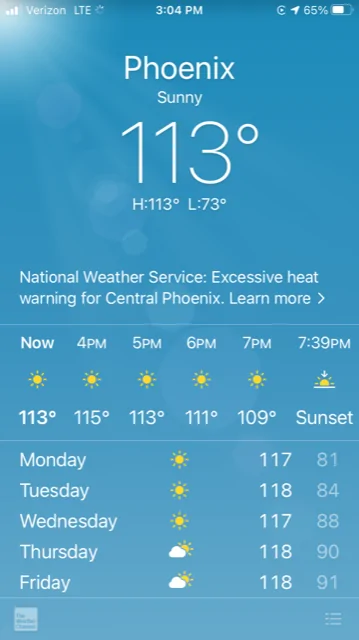

We've got an MME RWD ER (Infinite Blue) that drives and handles well, but as the temperatures here in Phoenix have started to climb, the outside air temperature shown on the display reads high by 13 to 16 degrees. I assume the car is using the outside air temperature to manage the batteries and the vehicle performance. Has anyone else seen this type of error? Is it harmful to the car (especially the batteries)?
For example here are photos from this afternoon. Weather.com reported the temperature at 113 degrees, while the MME displayed 129 degrees.
Thoughts?
Thanks!
Rick
I was told by phoenix ford dealership, it appears to be a programming issue ford engineer was working on the programming. to fix it . mine was reading 130 when it was 105 outside.
