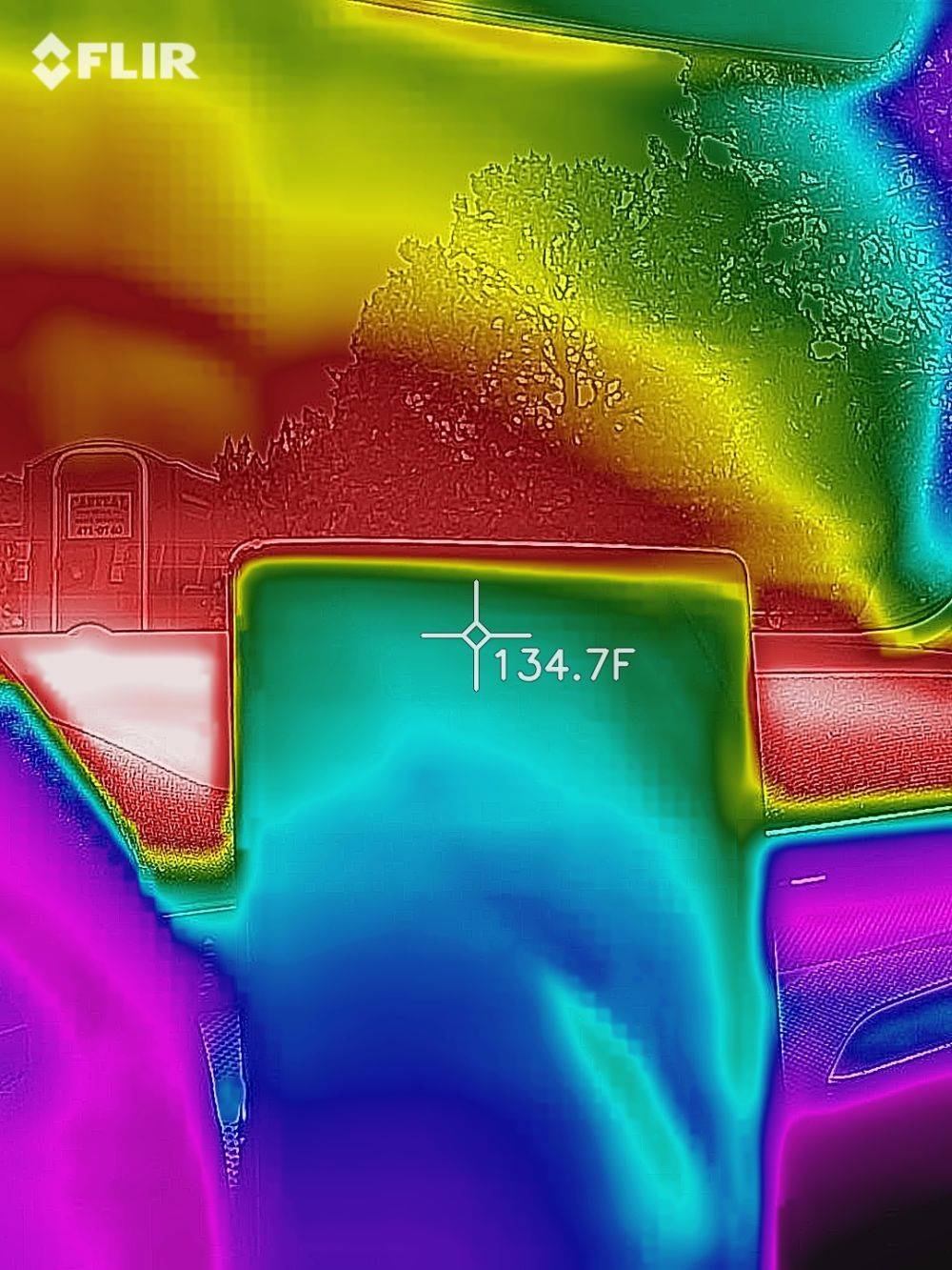

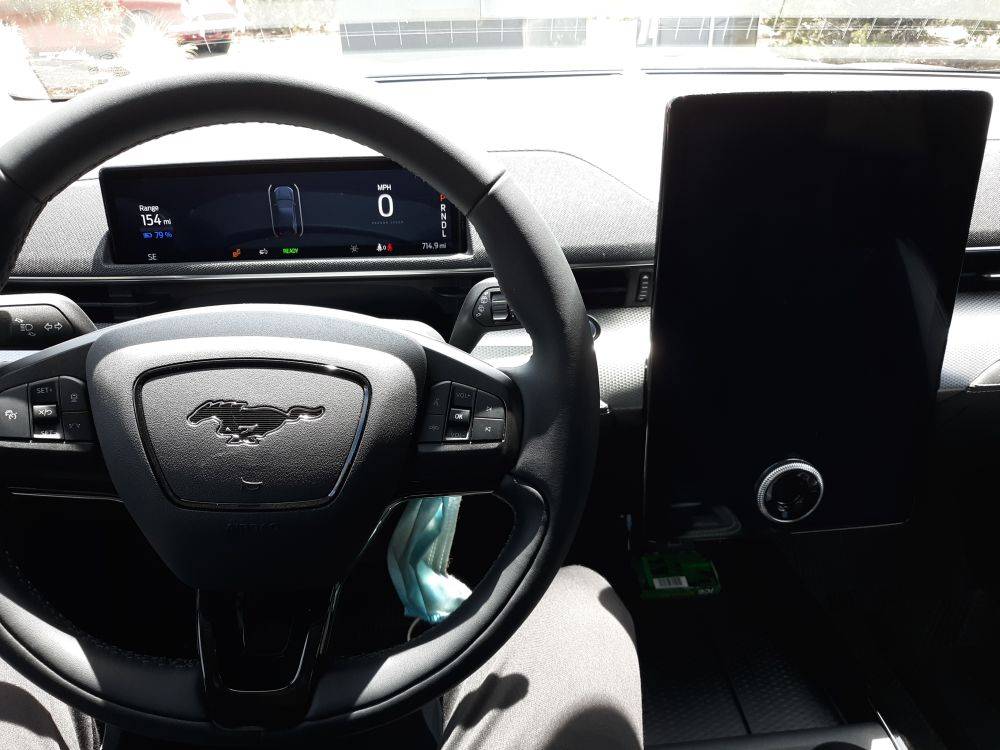

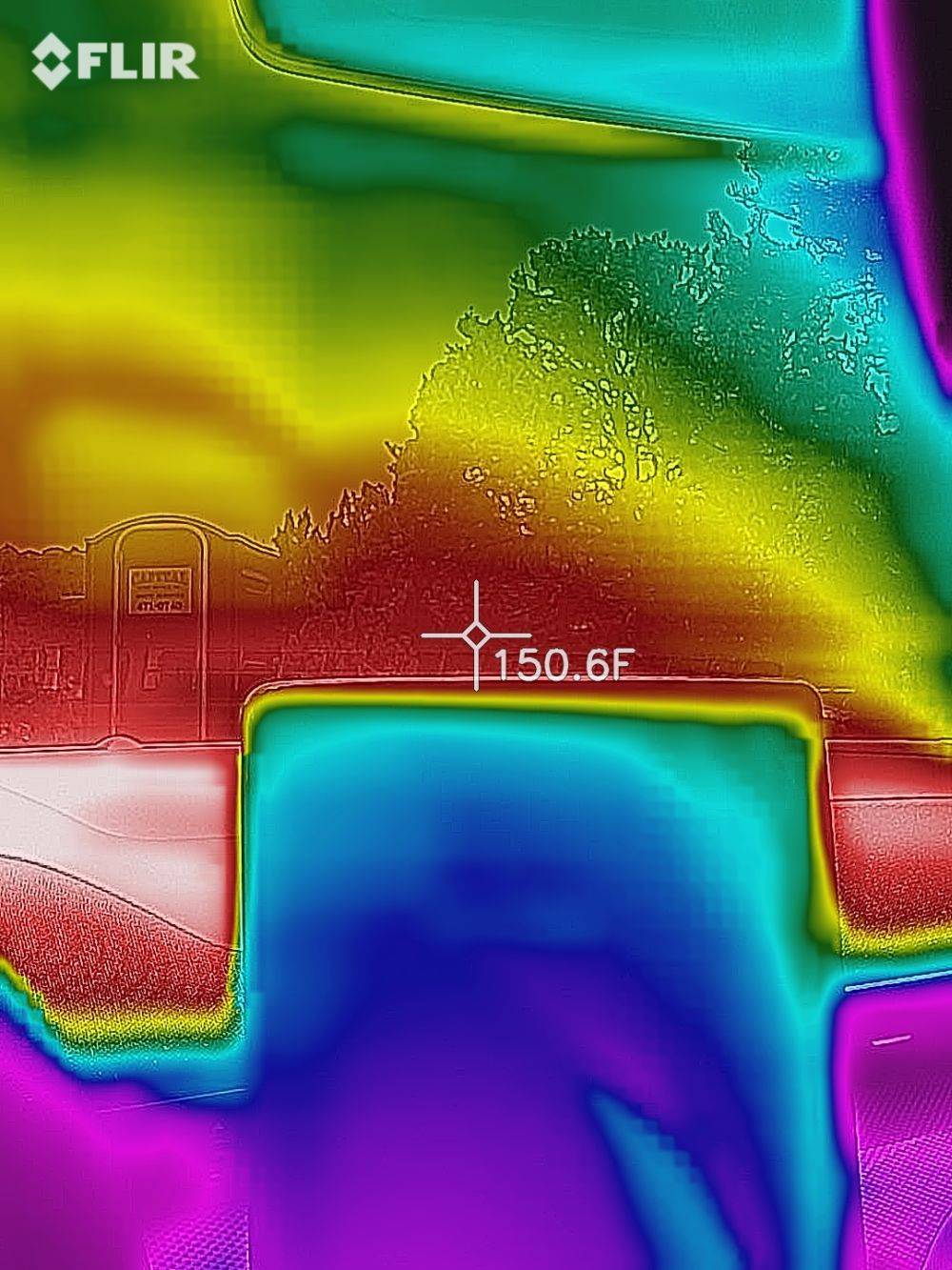

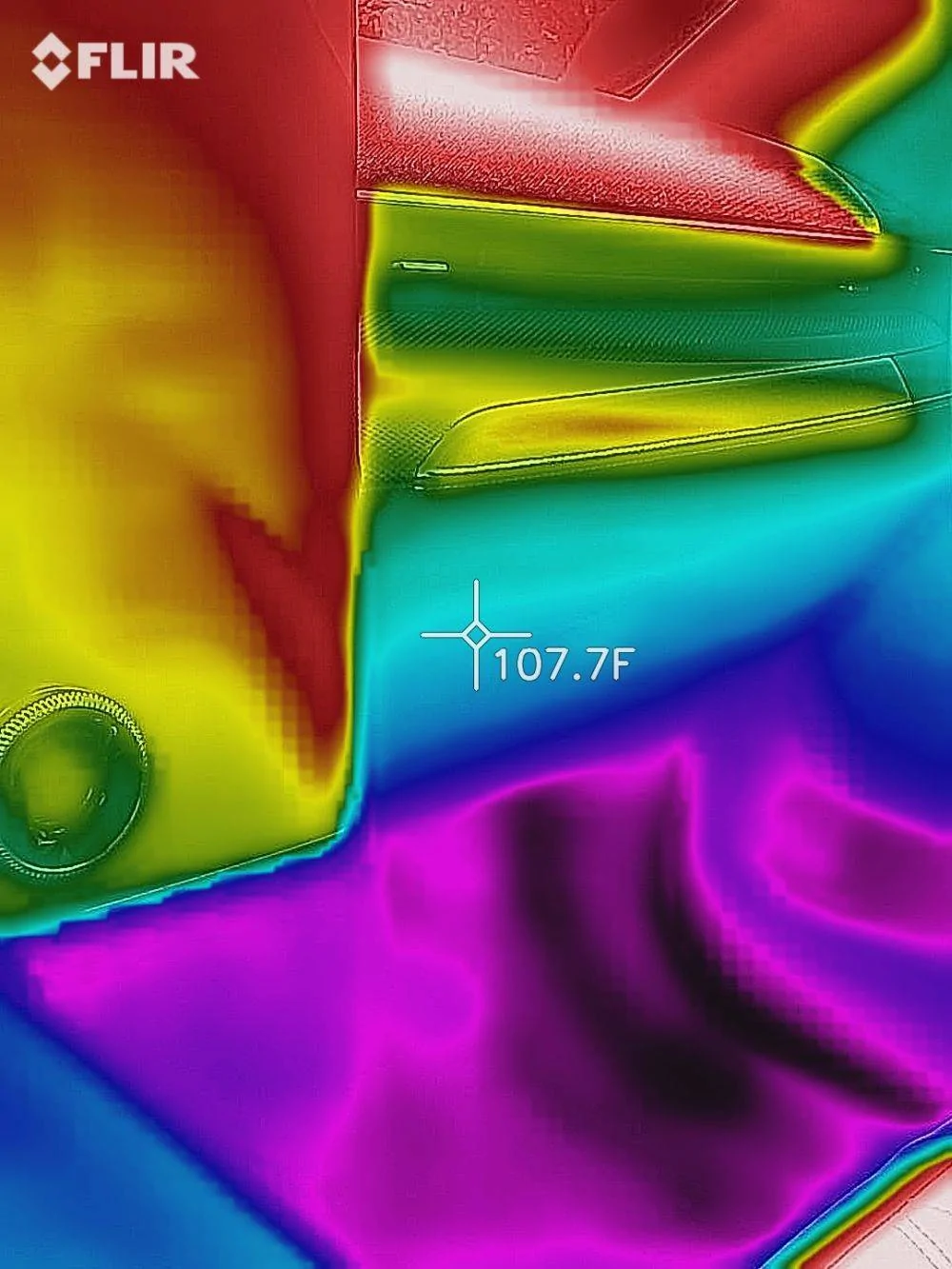

I had my screen replaced the first month I had the car. I took a picture of the drivers display on, and screen black, followed with a FLIR picture showing front of screen temp was 130F while windsheild was closer to 150F.
My dealer got a screen in about a week, called me in, and a Ford Field Engr was there to train their tech on the procedure. Took about 4 hours to remove/replace. Field Engr said they had a run of bad chips.
