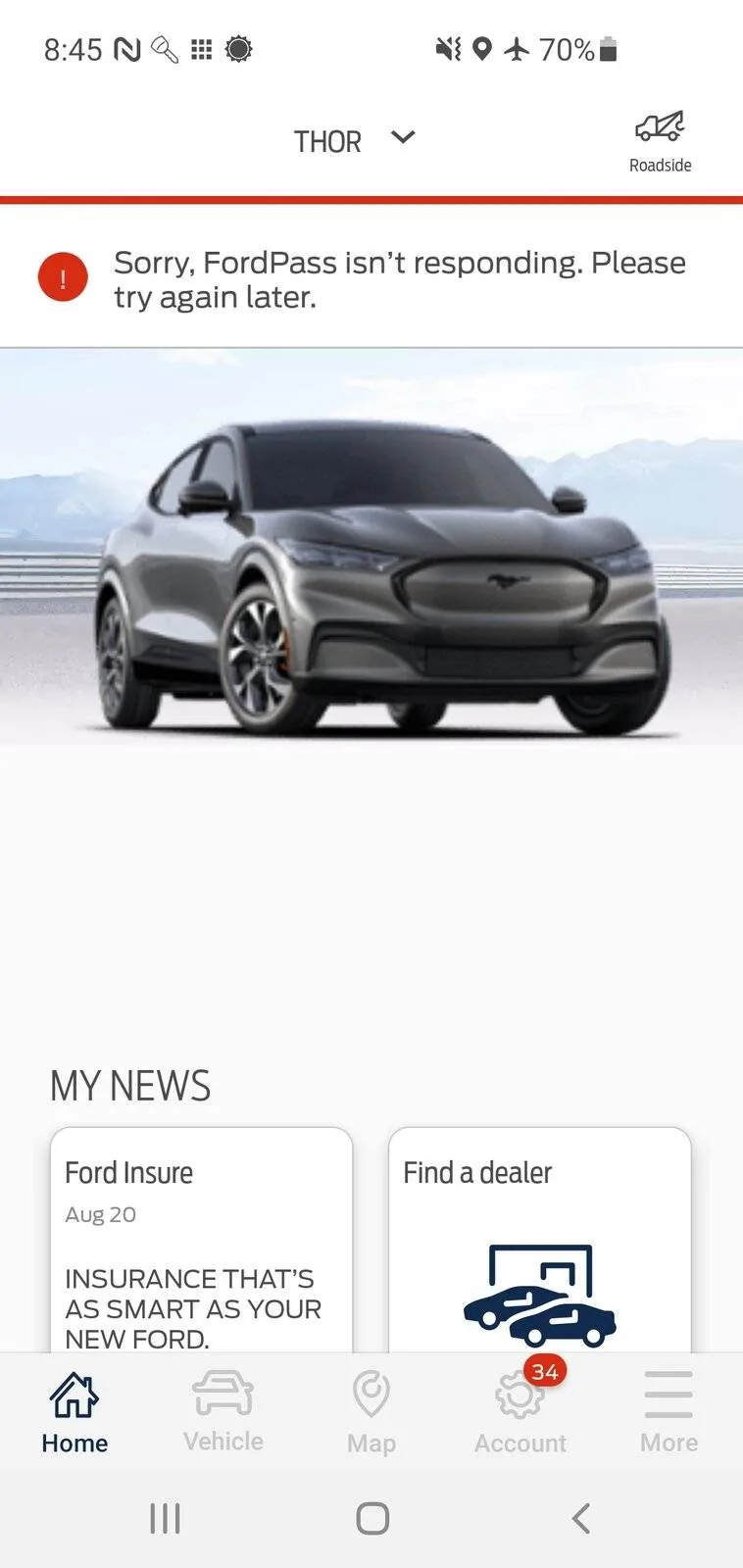

My car is behaving strangely today.
Still running FordPass 3.28.0 so I can't blame this on a recent update...
Today at work it cooled the battery like normal but was very very loud. I could hear it running at max compressor speed for a while then it would slow down for a few seconds and then ramp back up to full speed again. Sounded like it was throttling.
Later this evening when I got home I plugged in outside my charge schedule and the car started charging. Checked FordPass and it couldn't connect. So I got back in the car and the dash said charging so I checked my charge settings and it said the car would wait for the schedule to charge. Weird. Conflicting info.
So, right now it is charging even though it shouldn't be charging yet. Not sure what is up today but it's being weird. Very curious what state of charge I will see in the morning. Supposed to stop at 90% bit it might blow right past and go 100% Full Monty tonight.
Haunted car.
