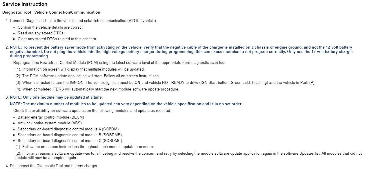

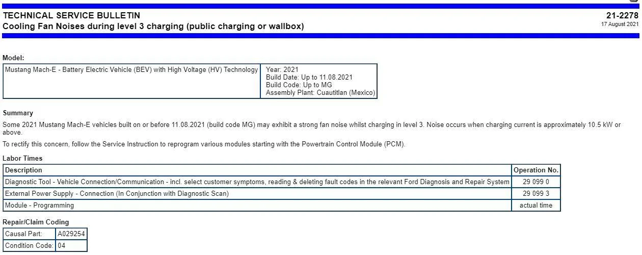

Some 2021 Mustang Mach-E vehicles built on or before 11.08.2021 (build code MG) may exhibit a strong fan noise whilst charging in level 3. Noise occurs when charging current is approximately 10.5 kW or above.

Interesting that there's now "a fix". I will have to have my dealer apply it.
Interesting that this refers to "level 3 charging". At least in North America, "level 3" means DCFC ....... maybe, in Europe "level 3" means three-phase charging ...... or did the author make a typo?
No, if you read the details it discusses charging above 10.5 kW. It may not help with the overly-loud L2 charging problem but then again it might.
They also use the term "mode 3" and mention a specific kWh. The term "wallbox" is used, which I have only seen from UK/EU forum members. If I had to guess I would say this update is designed to address both L2 charging above 10.5 kW and L3.
