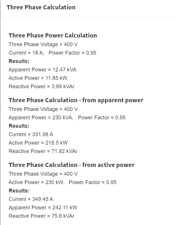

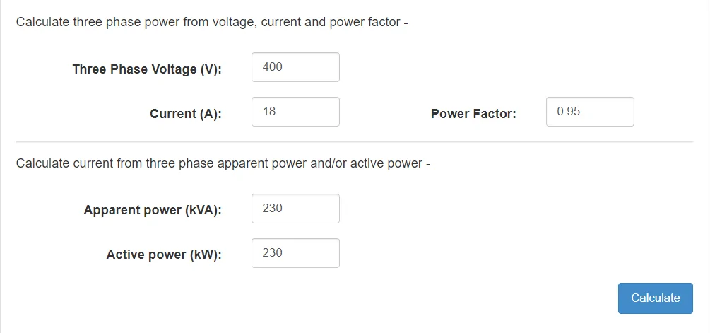

It would not be the same 48A at 415V. Each phase is 120 degrees apart so the combined current flow is not the same. It's been quite a while since I was an electronic tech, but calculating power on a 3 phase circuit is a lot different than DC P=IE.
Per this Three Phase Calculator - myElectrical.com when I plug in 18A it says ~ 12kW
at 16A it is closer to 11kW.
