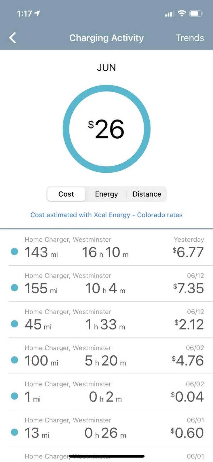

I am sure it is more efficient and cheap at 32 amps. It is hard to tell in the app. Also I think my chargepoint app shows the time spent charging when I unplug the car. I can't believe it would take 16hrs. The charging at the top is at 32amp. It was at about 28% and I charged to 90% standard range.
