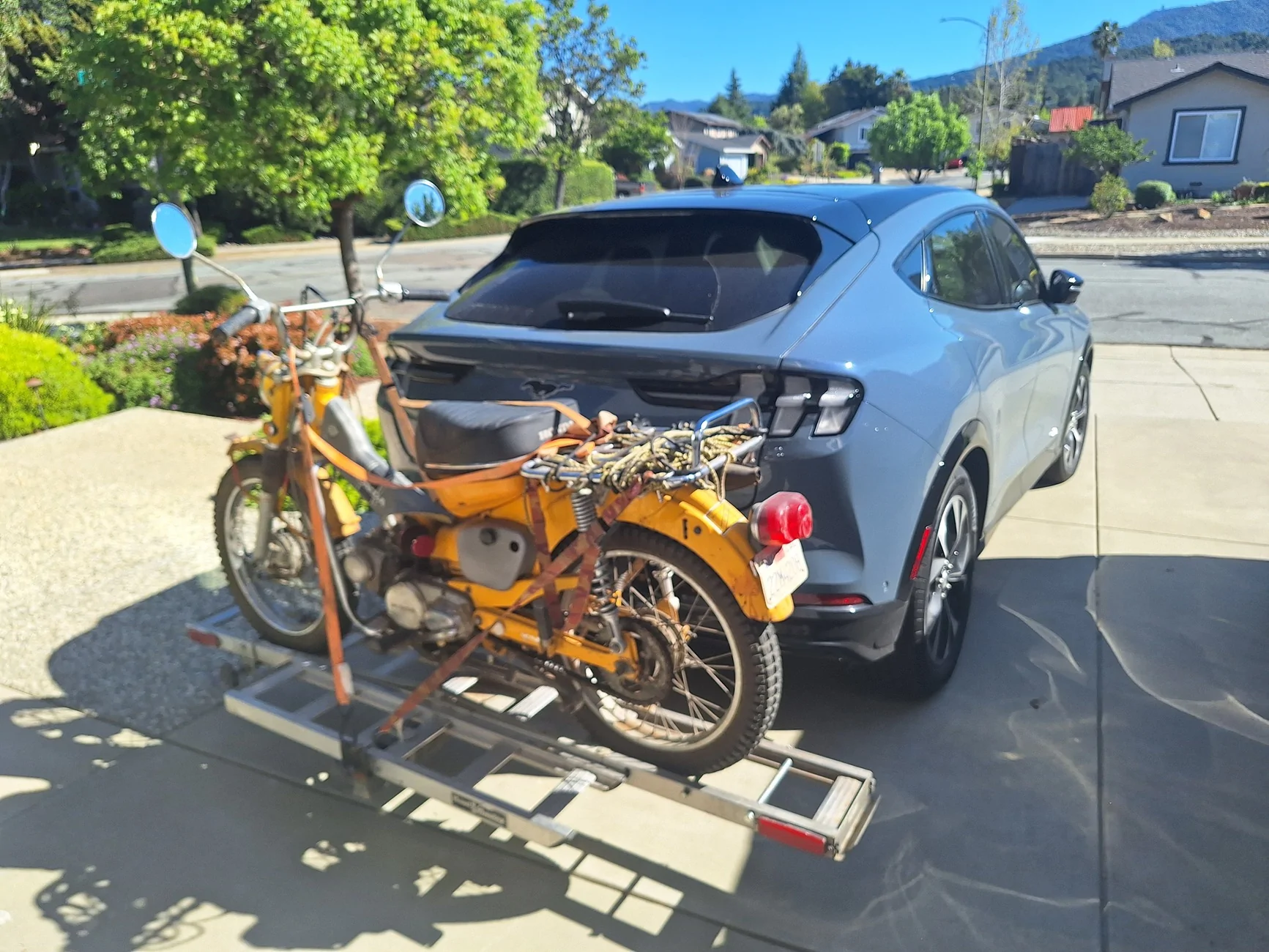

Hi. I installed this one.
The Draw-Tite 76460 Class III Max-Frame Hitch is a 2-inch receiver designed for 2021-2026 Ford Mustang Mach-E models, offering a 3,500 lbs Gross Trailer Weight (GTW) and 350 lbs Tongue Weight (TW) capacity. This concealed, steel, black powder-coated hitch requires minor fascia trimming and features a secure frame-mounted design.
Ford Mustang Mach-E Installed Curt hitch 42431

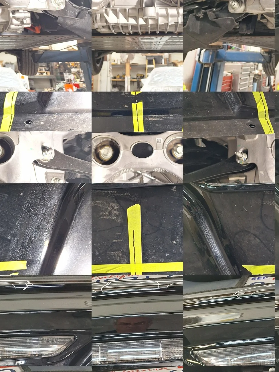

DesertRat46
DesertRat46
Mikeon line
Apr 15, 2026
33
53
Desert Hot Springs Ca
2025 Mach E premium Rwd ex battery
Retired Fleet/Service Manager
Yes we did as the hitch needs the space. We used a jig saw . We made the cut smaller than the instructions said. You have to lay under the rear to even see that isn't been cut.

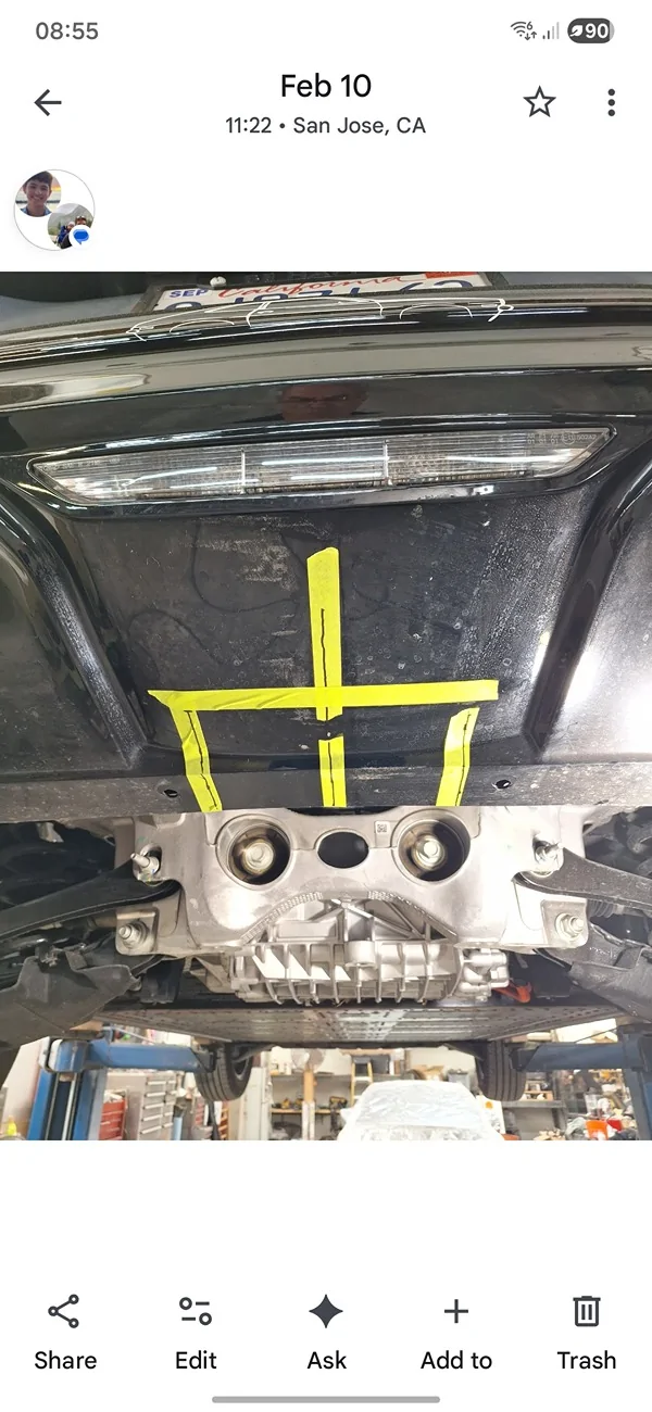

Here's a better picture.I don't know what happened to that other one
Ford Mustang Mach-E Installed Curt hitch 43885

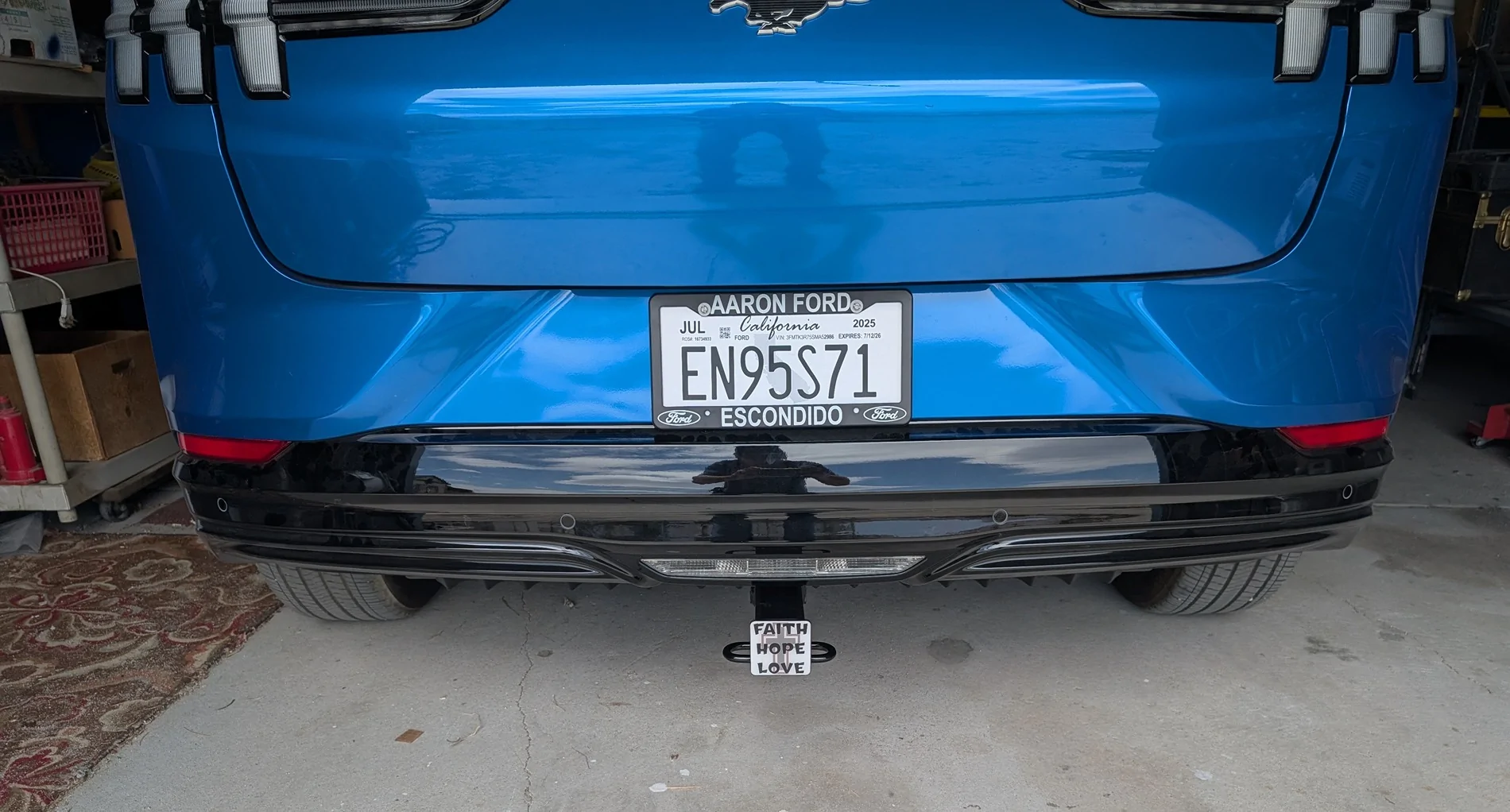

IL, USA
2022 GT
Bought it from Etrailer.com less than $300 with free shipping. Now I can carry my Lectic bikes on the rack I have
