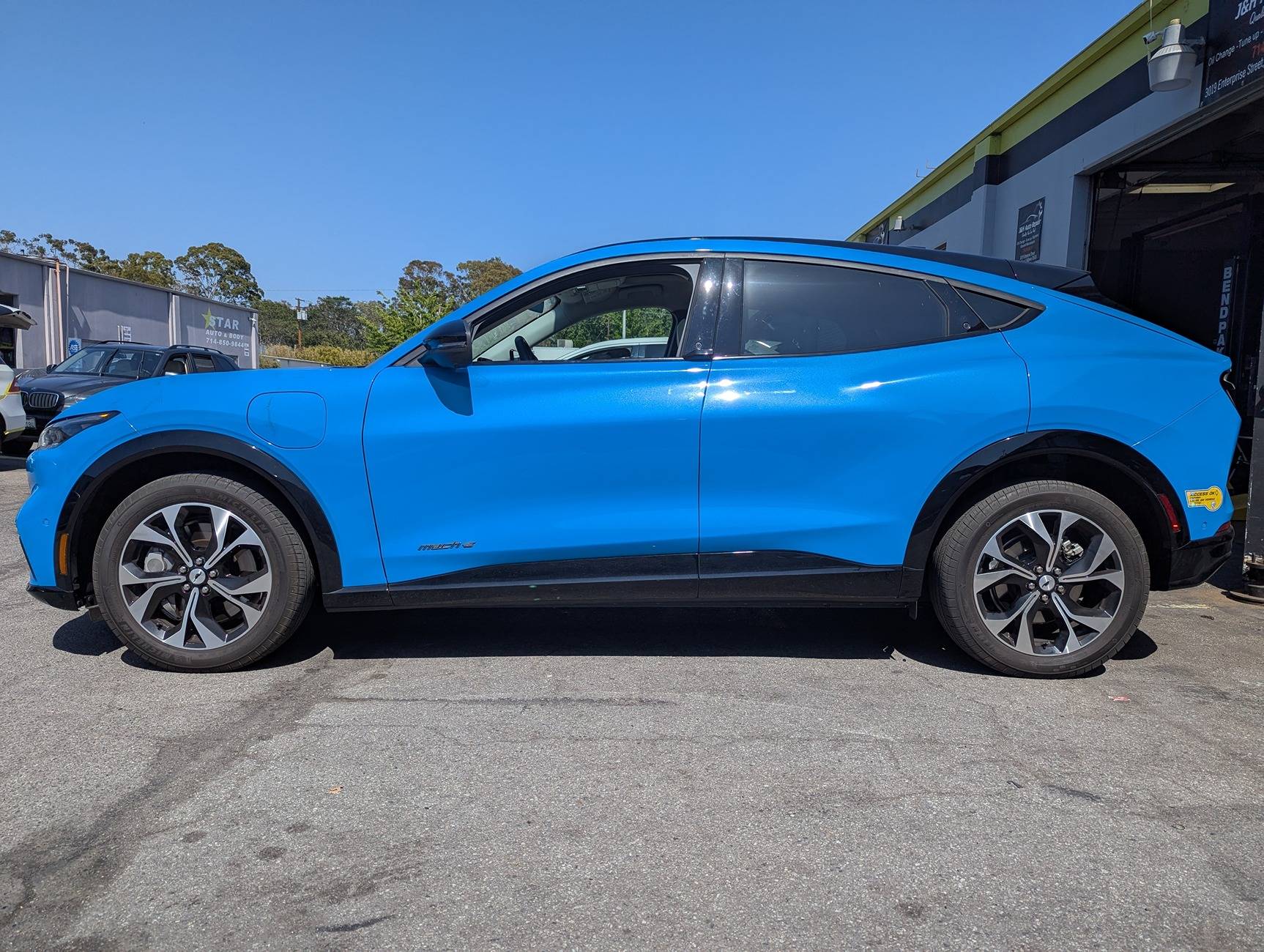

I finally got those rear spacers removed and the car looks more balanced now! Standard range RWD trims will not need any rear spacers.
Ford Mustang Mach-E Installed Mach-E Rally Springs on my 2023 RWD ER 1000012839
Also, last weekend, I had to fill the cargo area to the brim with stuff totalling more than 200 pounds, and after a decent drive around town, I thought the suspension felt even better!
With the extra weight, I guess I got a taste of what these springs feel like on anything other than a 2021/2022 SR RWD. This reassures me, as when passengers sit at the rear, I likely won't have to warn them about the rough ride anymore!
Anyways, I'm really happy with this upgrade! Thanks to everyone here for your input, esp OP @giwu42!
