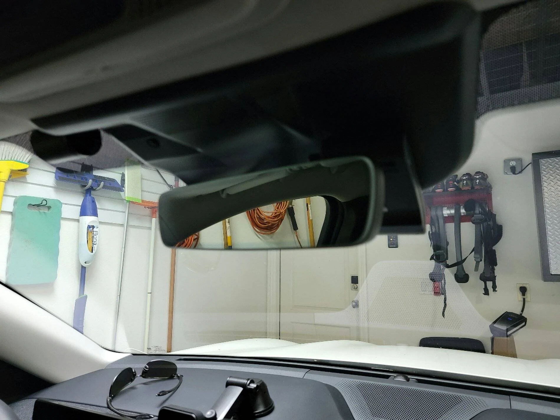

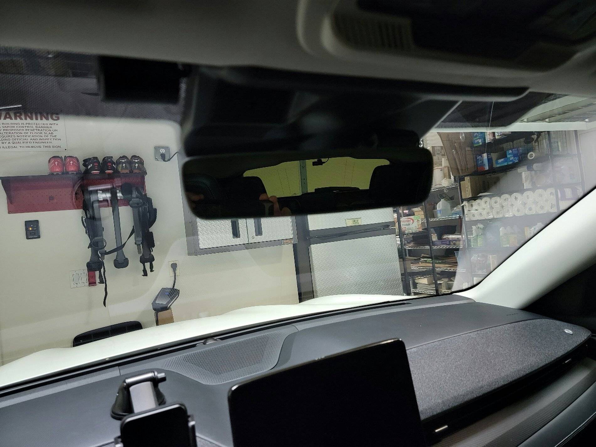

Installed Thinkware U1000 dash cam with radar parking w/ rear cam w/ OBD Connector. Installation went well. I was able to mount forward camera next to mirror mount on right side, pretty well hidden. Small hole in mirror cover kept wires concealed.
All wiring routed through drivers side roof and A pillar. Was able to use a small wire fish with door weather stripping pulled slightly down. Rear view mirror cover,left side dash side cover and rear glass trim came off easily and reinstalled.
WHOA!!!! There is a slight hitch in the Giddy up !!!!
I just found out the none of the Thinkware OBD connectors #1 and #2 will work with the radar parking . They are telling me that OBD connection is for Non-electric and Hybrids cars. That statement is including Dash cams. I Emailed them the Ford accessories information showing OBD connection for their dash cam . They said : will get back to me !! We will see. I have removed the radar parking connection and all seems to be working fine with the dash cam. I Found a additional OBD connector From IRoad. In talking with BLACKBOXMYCAR, they insist that's this works with radar parking. I have it on order, will get back.
