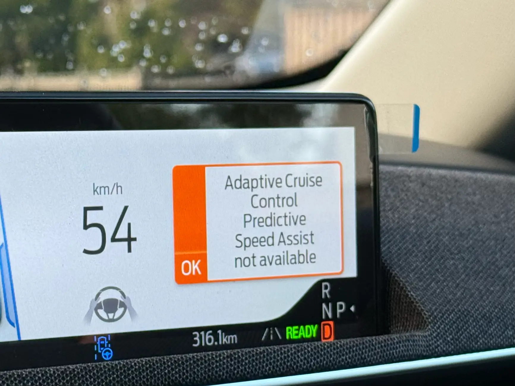

Hey guys,
I've just taken delivery of my 2025 Mach-E select.
I'm getting this error quite a bit... seemingly in certain geographic areas. I'm wondering if it's a problem with map/speed limit data.
On some drives, I don't get the error at all.
I'm booked in for service, but any thoughts on other ways I could try to fix the issue?
Ford Mustang Mach-E Intermittent error: "Adaptive Cruise Control Predictive Speed Assist not available." Cruise control error
Keen to hear from anyone else who has experienced this error, and what the fix was.
Thanks everyone!

Hey guys,
Thanks everyone!
