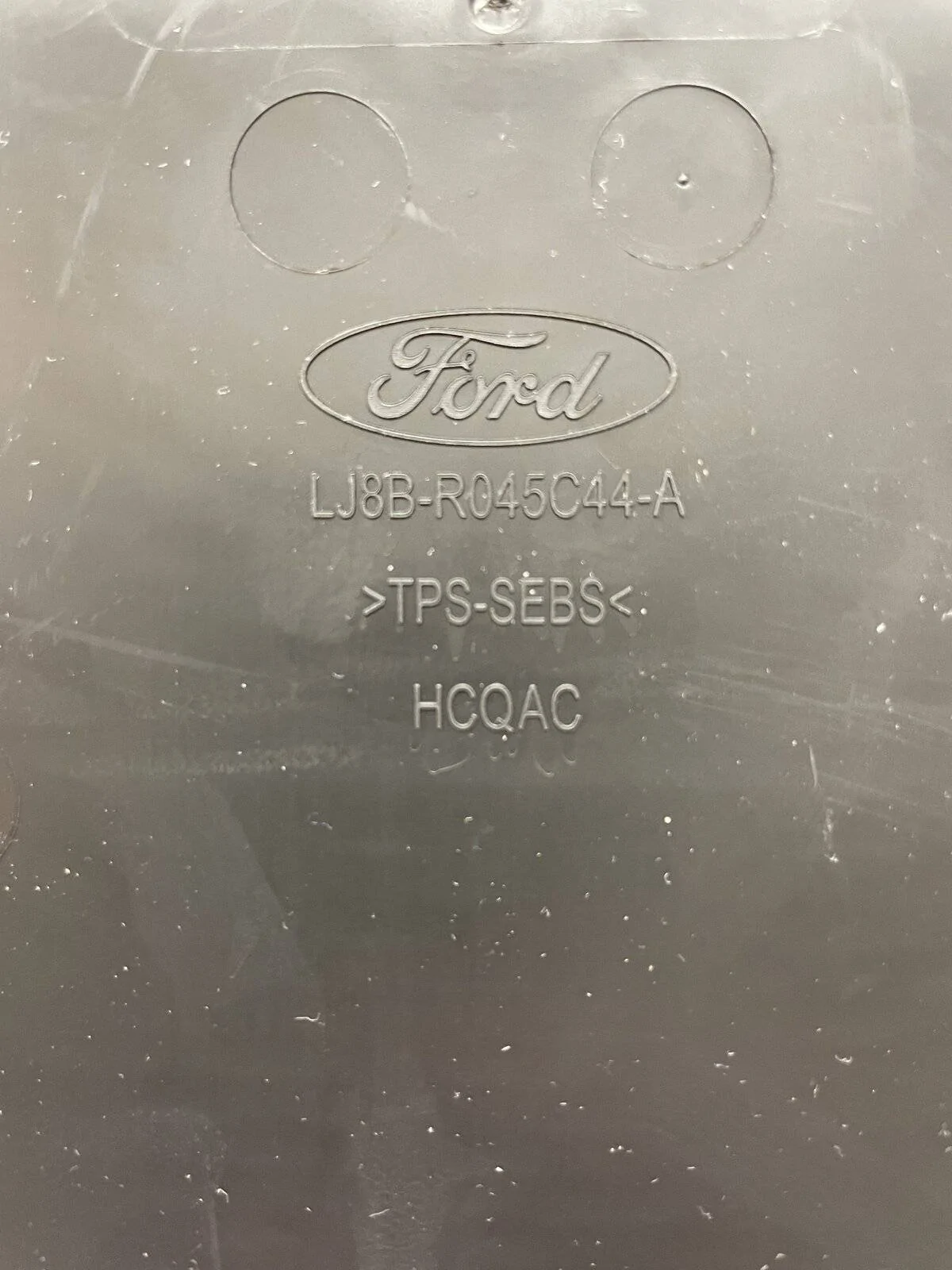

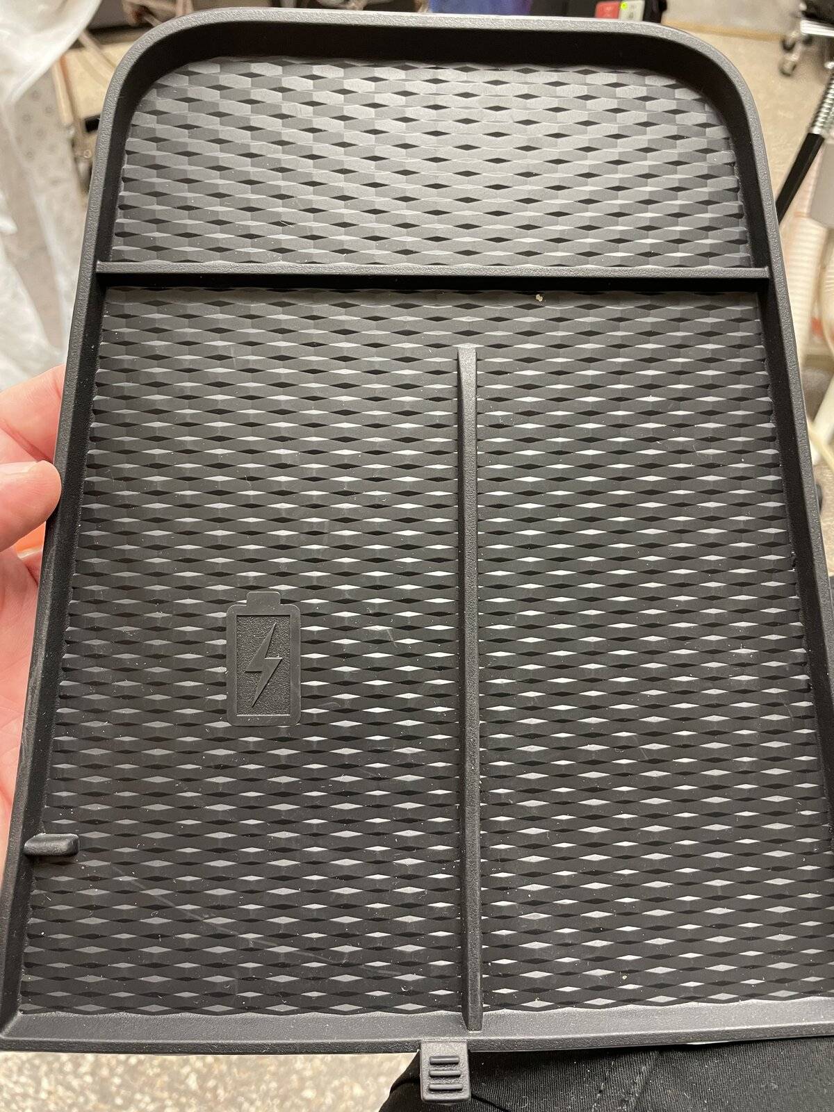

So after posting this yesterday and then doing a lot of driving around, I've decided that I am having issue with the phone not staying in a charging state. I ended up removing the rubber mat and it seems to make all the difference in the world. So I want to cut out the rubber over the actual charger section and then replace it some very thin black material (haven't decided what I'll use yet). So this will give a little space for the phone to sit in and hold it in place and also decrease the thickness of the area over the charger mechanism. But I don't want to cut it up unless I have a replacement. Anyone know where we can order a spare? I've searched the web for the numbers on the back but I don't find anything.
it's not obvious how you get there I think but it appears at Console Insert | FordUS you can order the part - the diagram suggests you want 045b54b for about US$27.

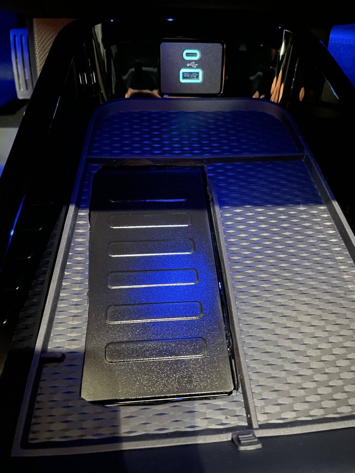

So I've got a new mat on order and its already shipped to me. I went ahead and cut into the console mat that came with the car. I'm not real happy with the cut on the left side. I don't think my OCD is gonna stand for that. But when the phone is in the slot, you can't see that its uneven. In my driving around today, the phone seemed to be held in place very well (iPhone 12 Pro) with an Apple Magsafe leather case. It did not disconnect from charge once. I'm making a 3 hour road trip this weekend so we'll see how it performs then. I think the thickness of the case and the mat is the issue.
But with the cutout, you can see where the actual charger is and you could probably use the design of the mat to help guide your cuts if you wanted to do this yourself. The charging area starts right next to the raised piece of rubber on the rights. So cut right up against that piece on the right side. The cut to the left based on the size of your particular phone.
I may try and clean this one up some more tomorrow and if I'm not happy, I'll work on the new mat when it comes in a couple of days.
