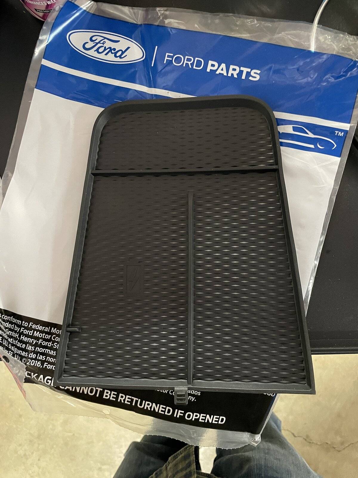

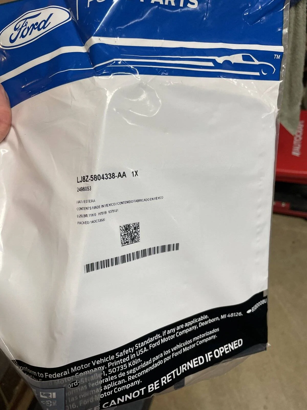

Can confirm that the replacement mat listed here is correct!
thank you for opening it and risking not being able to return it ??
