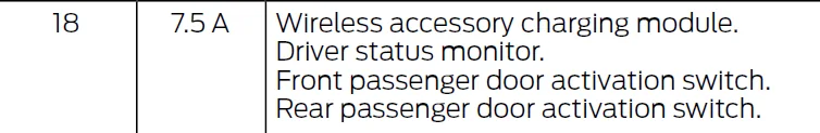

Well, i tried pulling and replacing the fuse, and still no luck getting ANYTHING to happen with the Qi charger. No intermittent charging, no real indication that there's any power going to the charger. Unfortunately do not have an Android phone to test on it. I may wait a while for the first OTA update or for more people to start reporting in with a similar issue (no functionality at all) before taking it to the dealer. The rest of the car is pretty much perfect and I'm happy to give up wireless charging for a while and enjoy the rest of the car. Will be watching this thread for solutions AND I'm intrigued by others' ideas to put a magsafe or other wireless charger connected to the USB port
