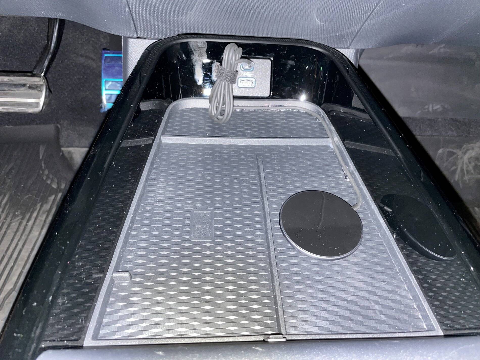

Here's my hack.
Purchased a black MagSafe compatible charger from Amazon (the standard Apple white was just too much). Got some adhesive pads to stick it onto the rubber mat. Cut a small slot into one of the rubber dividers and routed the cord along the edge. Hot glue'd things in place.
Works rather well. I can slide the phone off (or pull it off using the mat as leverage) with one hand.

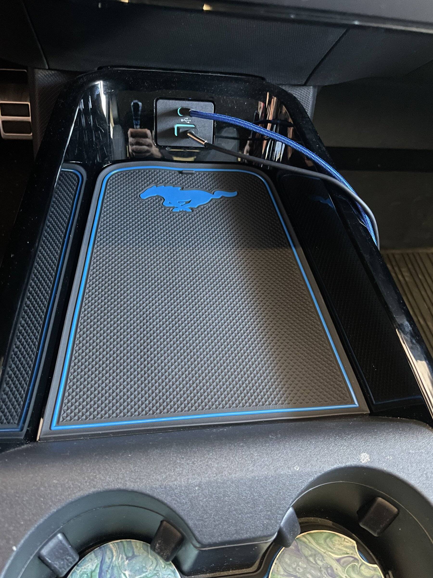

My first test today but charging off my iPhone 12Pro lasted much longer today. The trick? A thinner pad:
Ford Mustang Mach-E iPhone Qi Wireless Charging B5E32514-0F61-4F0C-9B21-BB247E82CB42
Thanks @AOSK
505
14,328
28,693
Is yours in a case Mark?
Yes, mine is in a case and I'll be that contributes to the issue. I'm not pulling the iPhone out of the case every time I drive though.

I have an official mag safe charger case on my 12 Pro Max. The Aosk mat did not significantly change the duration of the charging. The case is easy to pull mine out as it’s a fairly minimal case, but I’m not inclined to do so regularly. I use their rubberized charger tray organizer now and without the case, charging works fine. As others have said though, this appears to be an iPhone 12 issue. I also don’t have FRDS to try the change mentioned via few posts above.
