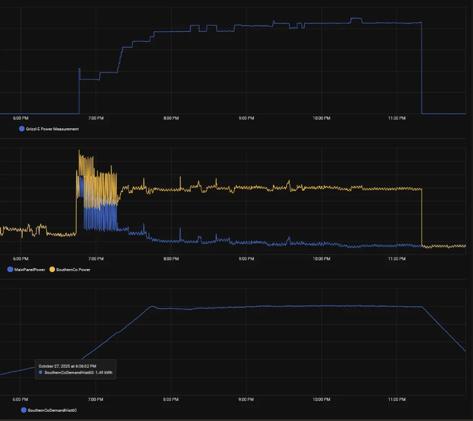

That is why I replaced my JuiceBox circuit boards with OpenEVSE, which are local interface only.
I'm bit-banging a Grizzl-E via HomeAssistant to keep my demand kW in check. Here the oven was on making dinner and you can see it turned the charger down
Ford Mustang Mach-E is the Azure outage affecting Ford(pass) app? 1761826534179-f6
