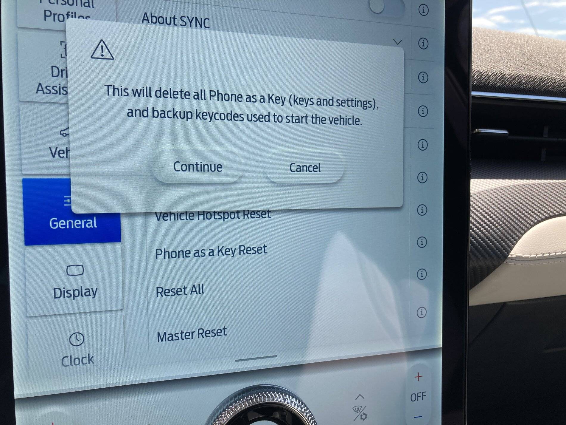

doesn’t exist. After making a new email and adding the car to that, it still didn’t work so I removed it, uninstalled, reinstalled, used original email, and it finally let me “activate”. Guess what though? Activate phone as key doesn’t exist as an option anymore. I watch the tutorial and it shows it right under remote start… but not on my phone
Ford Mustang Mach-E FordPass app outage 6EF800A5-E17C-45C2-BCD2-DD7F0E428552
Credit for finding this goes to @Mirak.
EDIT: To be clear, you go to Settings -> General -> Reset -> Phone as a Key Reset.

I even did a master reset and pulled my 12v connection (dealer recommendation) nothing doing. Trust me I have cleaned the clock. If its not working I hate to think people are on wild goose chases.
A major issue is the secondary bluetooth pairing that is require to make PaaK work. Not sure why Ford did it this way. My primary bluetooth with phone have never been an issue yet PaaK for some reason refuses to use it. Security maybe, but I doubt it. T after all.he Primary connect carries my CC info after all.
I think Ford needs to go back to basics on this PaaK/Ford Pass architecture, something elementary is being bungled.
This way of doing the bluetooth connection likely has something to do with extra security. This isn't a typical bluetooth connection.
Since the phone as key option literally doesn’t exist for me, I can’t even do this. When I follow that path all I can do is reset fordpass.
