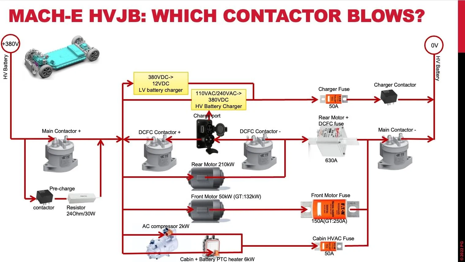

Watching a teardown video of the HVJB, I seem to remember that the contactors used in DC fast charging were a different pair than those in driving. If that is true, then would not the specific contactors that failed give some clue to the problem. Can anyone clarify or correct my info.
I believe it is the same set of contactors used for DCFC and driving, and there is a different set for L2 charging and maintaining the LVB. Maybe someone else can confirm my memory...
I can answer this since I've taken them apart. DCFC uses all 4 big contactors, so the current also flows through the main contactors.
Ford Mustang Mach-E Is there a correlation between fast charging and HVB issues? screen-shot-2022-08-05-at-13-56-30-jpg
Source: https://www.macheforum.com/site/thr...-the-problem-of-overheating-contactors.20373/
If you have a bad main contactor, high-power DCFC WILL heat it up. If it's already hot from driving this can further melt it and cause a SSN/stuck contactor after DCFC (or the next time the vehicle is shut off). Less than 100 kW charging isn't as much of a concern.
The HVBJB is going to fail regardless of if you DCFC or not. It's just a matter of time and how good of a part you got.

OK, now I can see that both DC fast charge and high power draw scenerios could be factors. Seems to me that high amps conversion to heat can happen quickly so that does not give much of a safety factor if part design is marginal.
