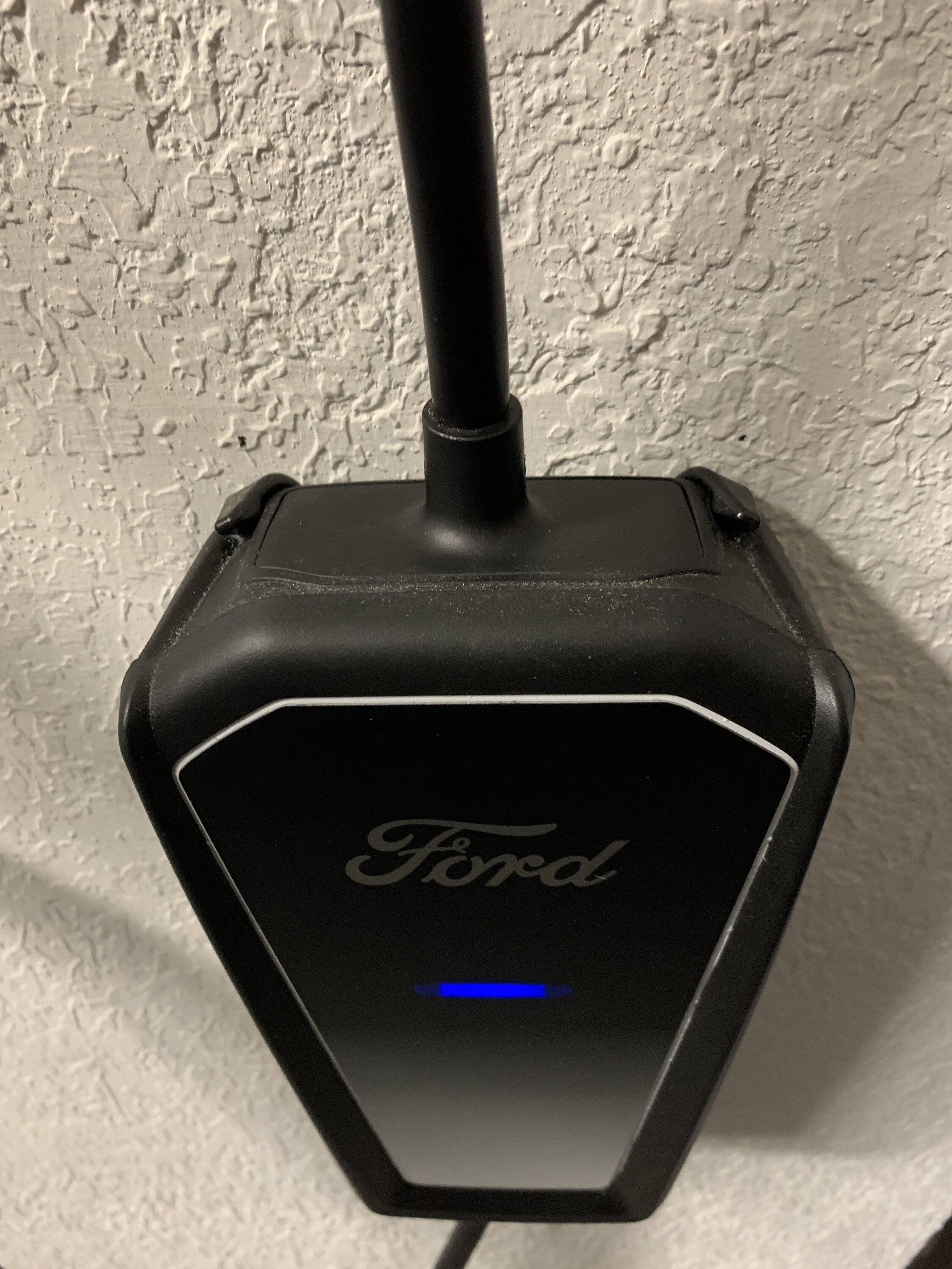

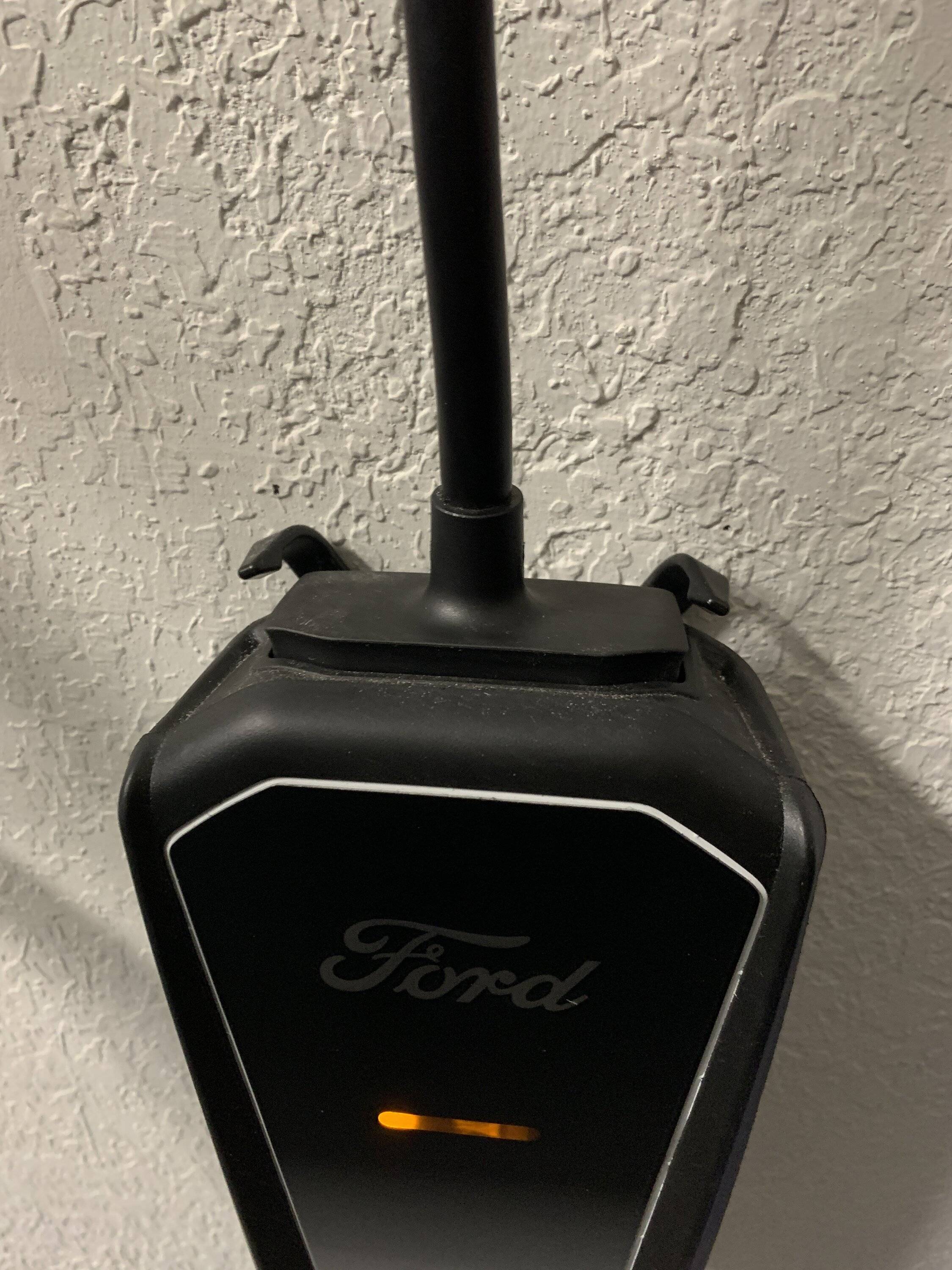

Brian,
Just because this really sounds like what happened to me way back when - the plug not pushed in, I’ve included a couple pics. Look closely and see which one looks like yours. You need to push it in firmly. Hope this helps and it’s not another problem.
Good luck.
Not in all the way with steady amber:
Ford Mustang Mach-E Issues with Ford EV Charging Cables D2CBC0BD-0690-47C8-BB72-591002EBFC1C
Pushed in and flush with steady blue light:
Ford Mustang Mach-E Issues with Ford EV Charging Cables EB22ACB6-23BF-46AC-9572-0DA106049DEF

Brian,
Good luck.
the OP says he did.... but these pix are perfect examples.
