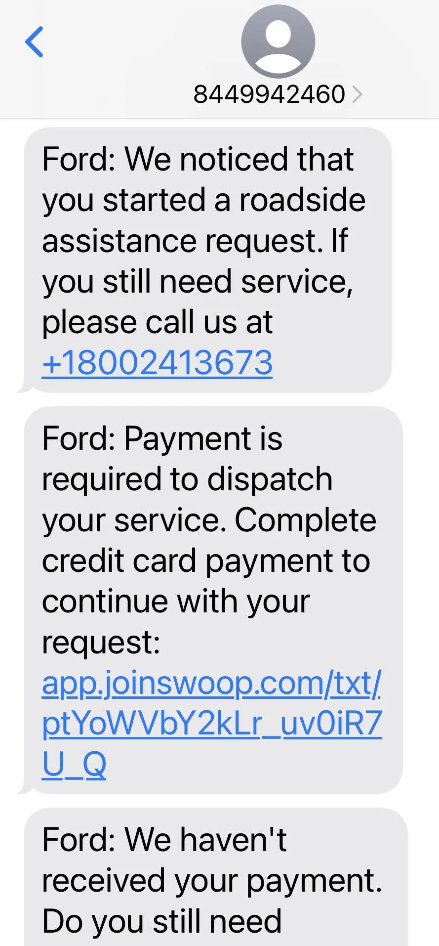

There seems to be some question about whether I should have or should not have had to pay 125.00 to Ford Roadside. Here is an image of the message and link they sent for me to pay, otherwise, no soup and no towing for me! I did not pay it.
Your car is absolutely covered by Ford Roadside Assistance. It is also covered by Ford Electric Vehicle Battery Roadside Assistance, which provides towing to the nearest charger or Ford dealer. Here you were at a charger, but the assistance should have covered taking you to the Ford dealership.
Please be sure to tell Ford Customer Service about this when you talk to them. It is so wrong that you were going to be charged for towing!
