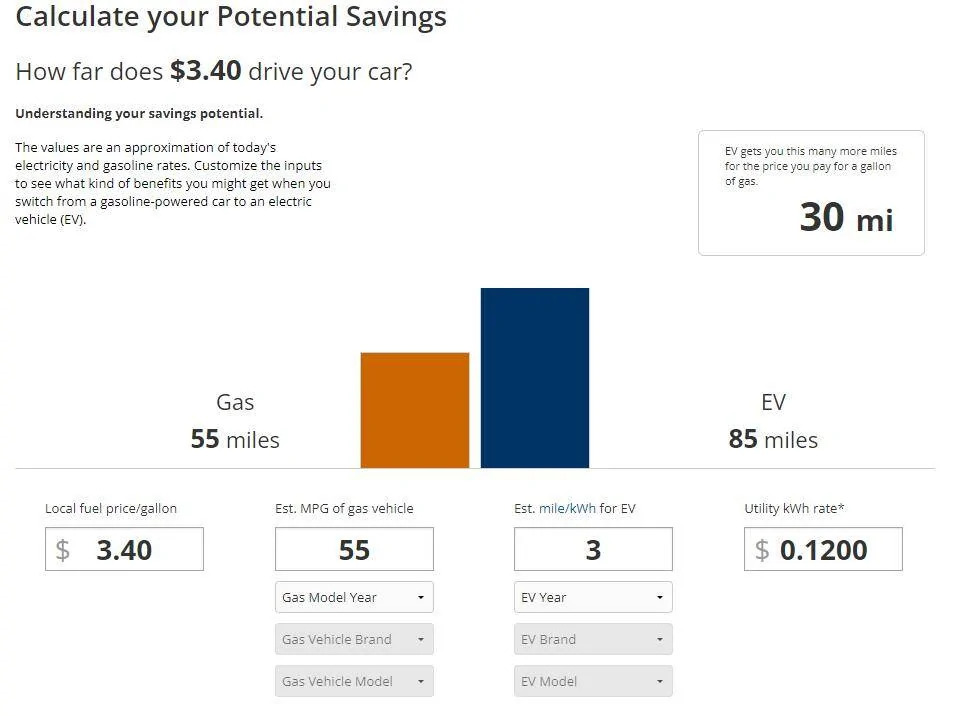

https://chooseev.com/savings-calculator/
HEVs with low gas prices in Florida will probably be cheaper - just slightly. Definitely cheaper than DC charging but if you have cheap Florida electricity and never DC charge... it's close.
