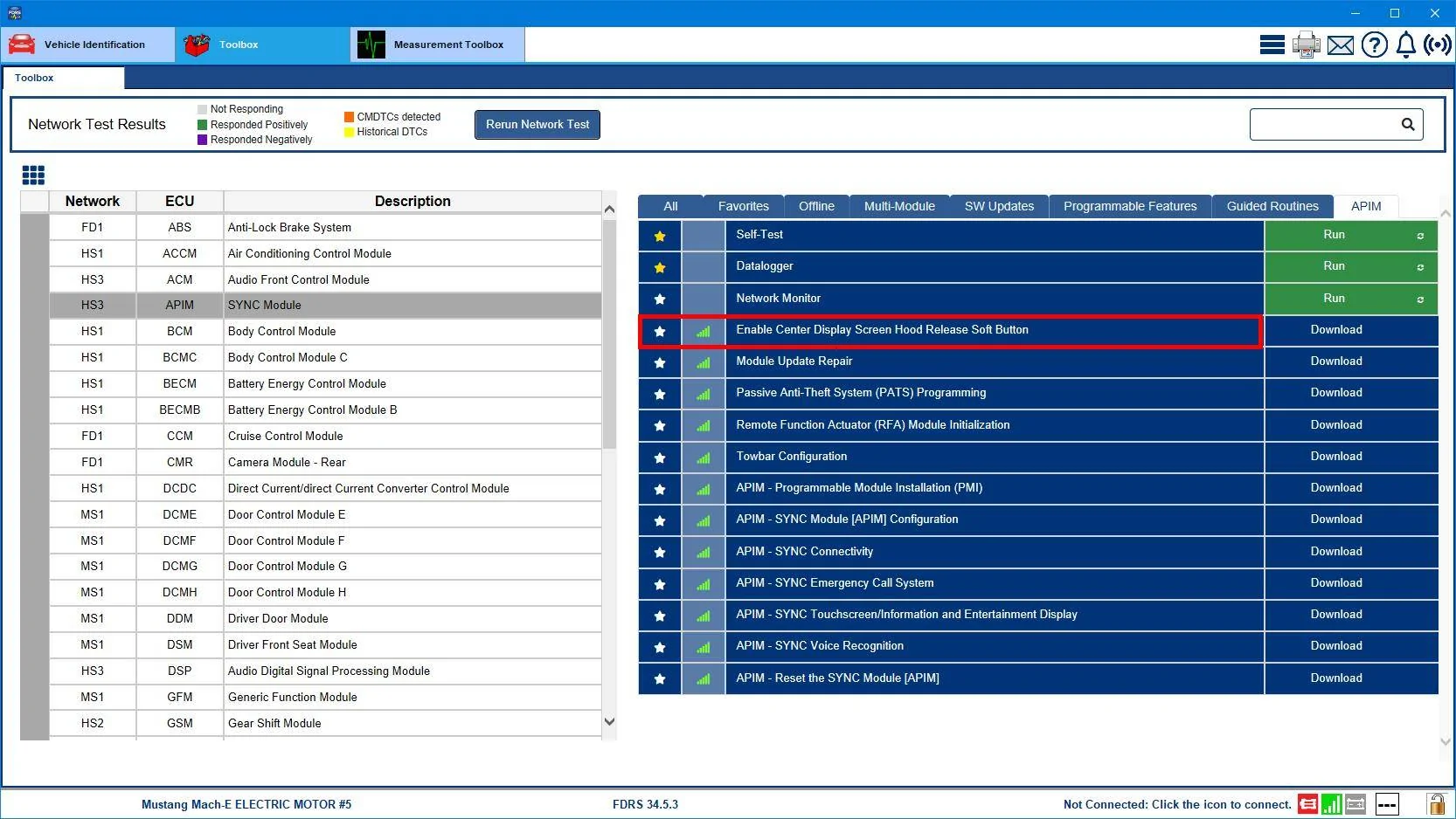

I think the OP is referring to the child escape safety button inside the frunk, any way to remotely open the frunk from the Sync screen or the door pillar. That said, does anyone know if updating BCM and GFM modules activates the hood release button inside the frunk?

Yes, it does.

It would be nice to open the frunk from the outside via keypad without entering through the driver door and double pulling the lever. So much easier to accomplish while carrying multiple bags of takeout Teriyaki.
If you get the modules updated as mentioned in steps (1) and (2) above, then you should have the option of programming an F-150 FOB that will enable the frunk button from that FOB. There is a thread on here describing how to do it.
I carry my keys more than PaaK, so having the FOB button is more convenient than getting a FordPass button anyways.
I appreciate that you're trying to be helpful, but dropping a few hundred dollars on equipment or non-warranty labor is kind of missing the point.

If you get the half-a updates done, you’ll be able to use the door pillar. It’s 7/8 after entering your PIN.
