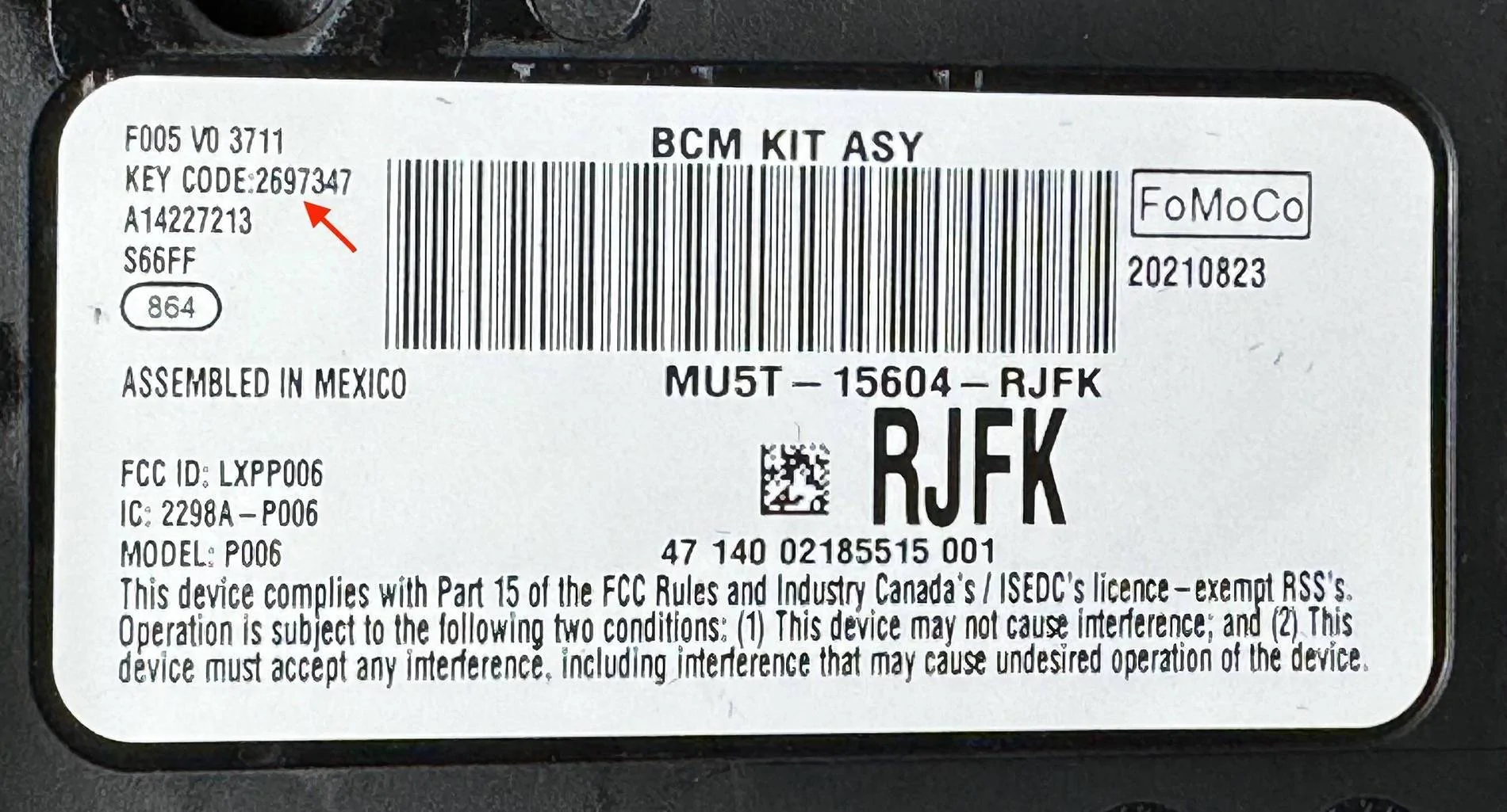

Decided I should try keyless entry, can’t find card with code but fortunately saved code on I phone locked car put in code nothing
Wondered if I saved code properly tried two fob method no factory code appeared .
Frustrated tried to set up iphone as key but this option does not appear on app or on car
Is this disabled for UK ? or is it just me
Maquis
5,719
8,126
Phone as a key is only in US. Check the door code on the body control module label. It’s in the passenger footwell.

This is an example of the label on the body control module that Dave mentioned above where you will find your 7 digit code to unlock your car.

Eureka
Can't thank you guys enough if you were close by get you the best coffee ever !!
Label in fuse box
