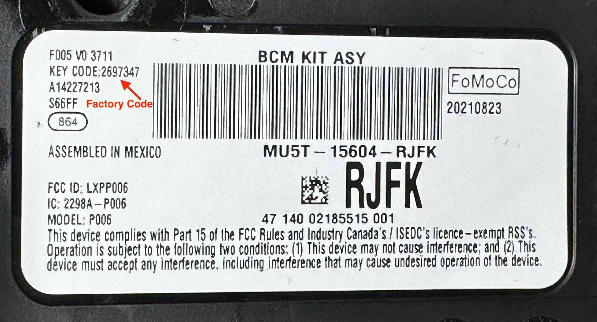

UK
Mach-e AWD Extended range
The factory code is also displayed on the data label in the fuse box in the passenger footwell. I’m in the UK so not sure if this is reversed for US cars.
It is the same for us here Chuck. Label is on the BCM (fusebox) in the passenger footwell. All 7 numbers are used in the European Union and China. In North America, we just use the first 5.

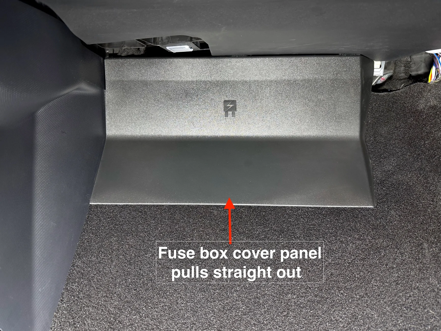

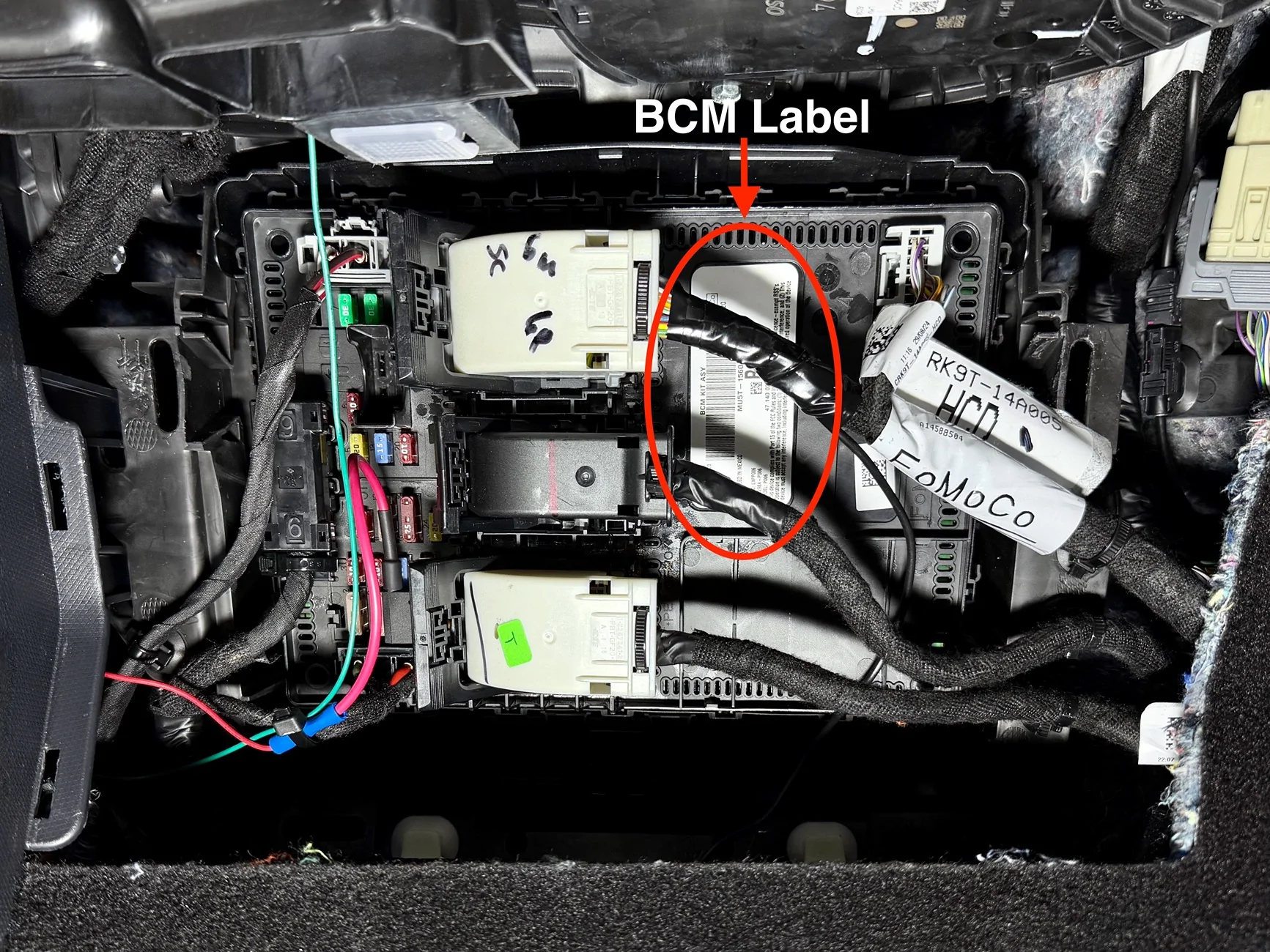

I don't see that label, mostly just a fan it appears.
In the front passenger footwell, under the glovebox against the carpet, behind the floor mat, is the fuse box panel cover. Behind the cover is the BCM/fusebox. On every BCM there is label that is prominently displayed.
You don't have this fuse box cover?

Your statement "mostly a fan appears" means you don't understand the term "label". Mark Boris has posted a picture of the label, and where it is.

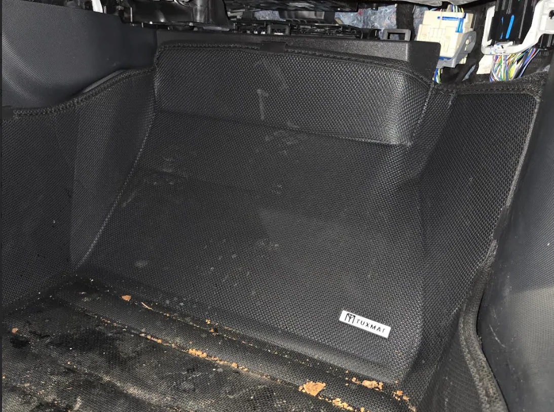

My tuxmat floor liner goes up to the top edge of that panel, I would need to pull it out of the way. Thank you for explaining that!
