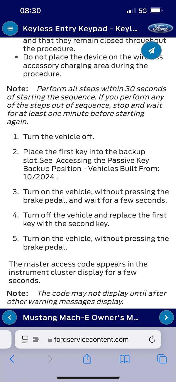

I live in the UK and have a second hand mach-e. The sales guys are equally useless in the UK and did not get the factory reset code from the previous owner. When I asked them about it they all looked blank. I have tried to follow the instructions in this thread and have a few recommendations for improved success.
1) Thecar must not be plugged into a charger.
2) Turn off the car while inside and do no open the door.
3) Place one key fob in the cradle in the centre storage box.
4) Start the auxiliary power e.g. press start without touching the break.
5) Wait untill the process is complete e.g. 5 seconds or so.
6) Turn off the auxiliary power without touching the break.
7) Swap the key fob in the cradle with your second key fob.
8) Start the auxiliary power again (no foot on break).
9) Clear the messages and the code will be displayed.
So this worked perfectly on repeated tests. The issue I encountered was that the factory code displayed was 5 digits long and the reset on the centre screen asks for the 7 digit factory code. Does anyone have any idea what the two missing numbers would be?
As I have never been able to use the keypad code, can I ask how the numbers are entered? The keypad contains 5 buttons with two numbers for each. If I was trying to enter 15724 would I press 1/2, 5/6, 7/8, 1/2, 3/4?
Thanks

That worked a treat and let me erase previous codes and set a new one.
The keypad code is limited to 7 digits in the UK. Following the duel key master access code instruction (attached), I get a 5 digit code displayed. What is this 5 digit code for?

7 digit is for Europe and China. All other countries are 5 digit. However you can in any country change the code from 5 to 7 or 7 to 5 using the software FORScan.
