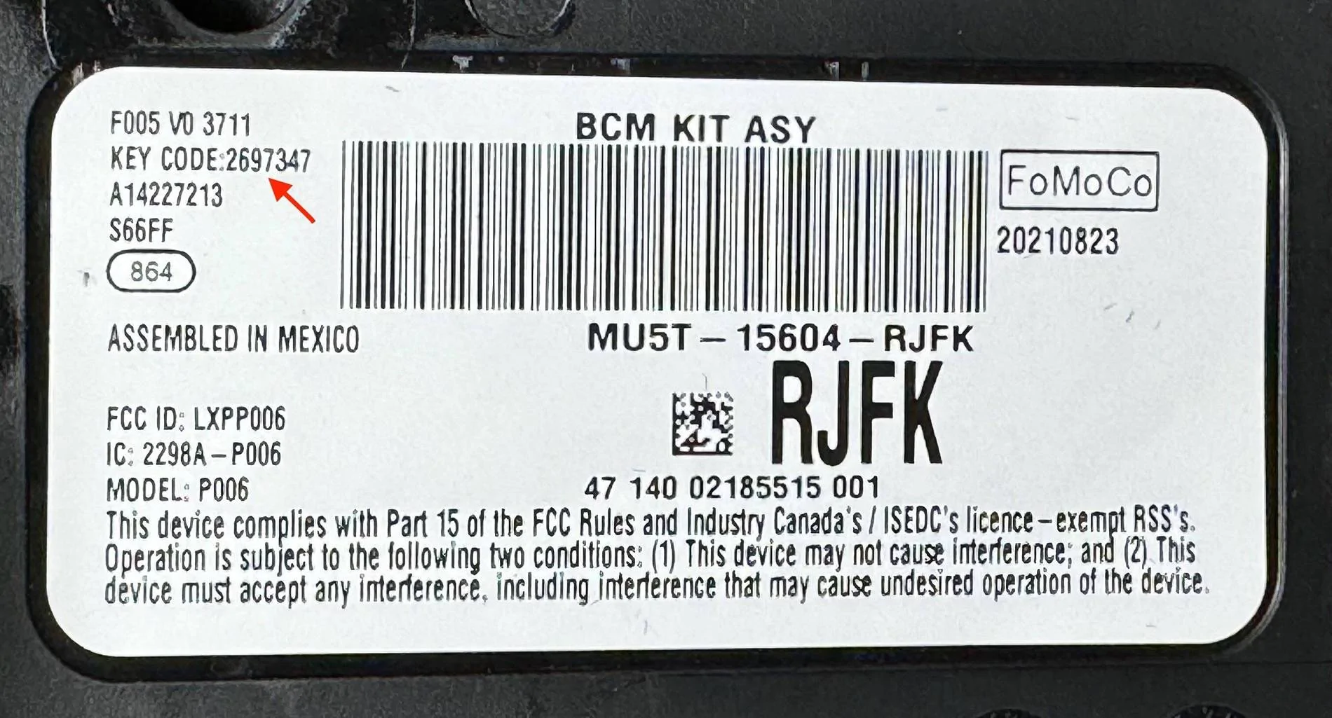

The Keypad code is located on a sticker on your BCM. It will be a 7 digit code. The BCM is the module that is in the footwell on the passenger side with the fuses.
Like This:
Hi, thank you for the code location, I found mine as well, and there are seven figures on a US vehicle!
The problem is that the system is asking for five figures code, which are? First five or the last five?
Many thanks for your kindly help!
Last 5 iirc. Try it once.
