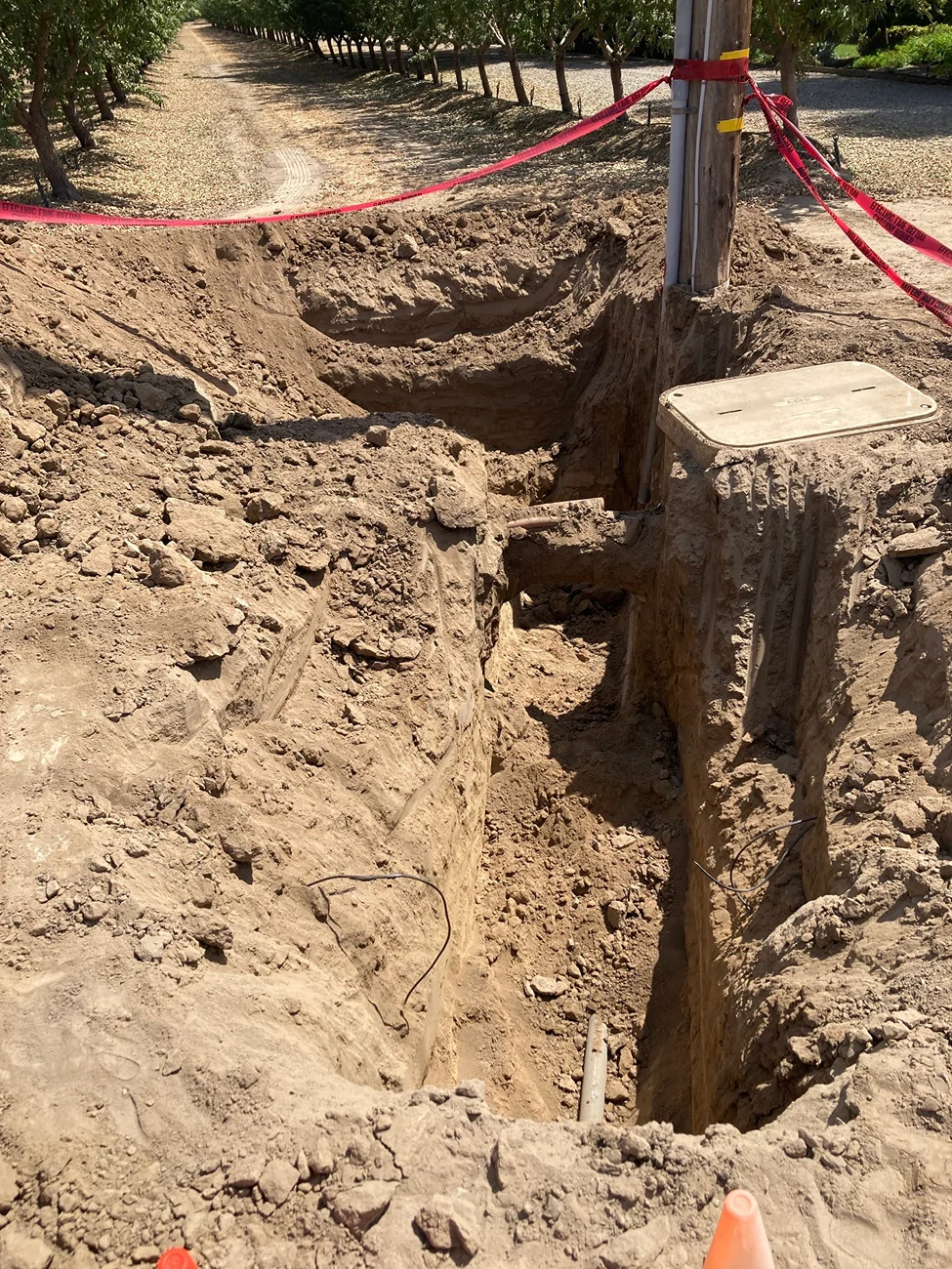

O/T, but related. QMerit sent an electrical contractor out to install our 'free' Charge Station Pro. He took one look at our 50YO breaker panel and said "I can't touch it, QMerit won't let me." It turns out the house my folks built 50 years ago had a breaker panel from a company called Zinsco, which was commonly installed back then but went out of business--a couple times--because, well, they're defective and a potential fire hazard (something to do with an aluminum bus). So, I bit the bullet and gave the go-ahead for a new panel(s) for my house and my rental. Since my house had underground service (240V/400A), the local utility--an 'irrigation district'--required that our service be brought up to current code, which involved digging up the old service and installing a 'christy box' a few feet from the pole and pulling about 250ft of heavy cable. I did get lucky as the utility didn't require I dig up the 2.5" conduit and replace it with 3" (it was 6' down and went under our paved road). I had to hire a mini-excavator for the dig.
So far, the 'free charger' has cost me about $20K for both houses--haven't gotten the bill for the excavator--but I'm happy; fresh wiring to the charger I'm running at 48A and my lights don't flicker anymore. I figure the Mach-E will pay for itself in about 15,000 years. Moral of the story: don't assume you can necessarily just find a free position for a 240V breaker and be done with it.
