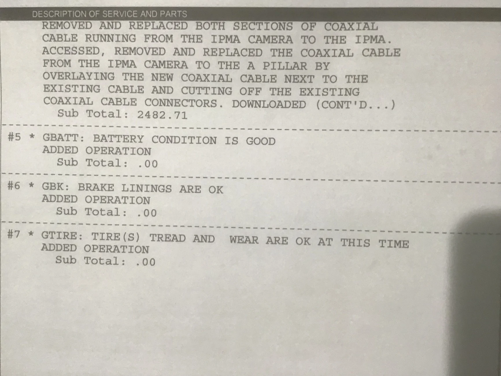

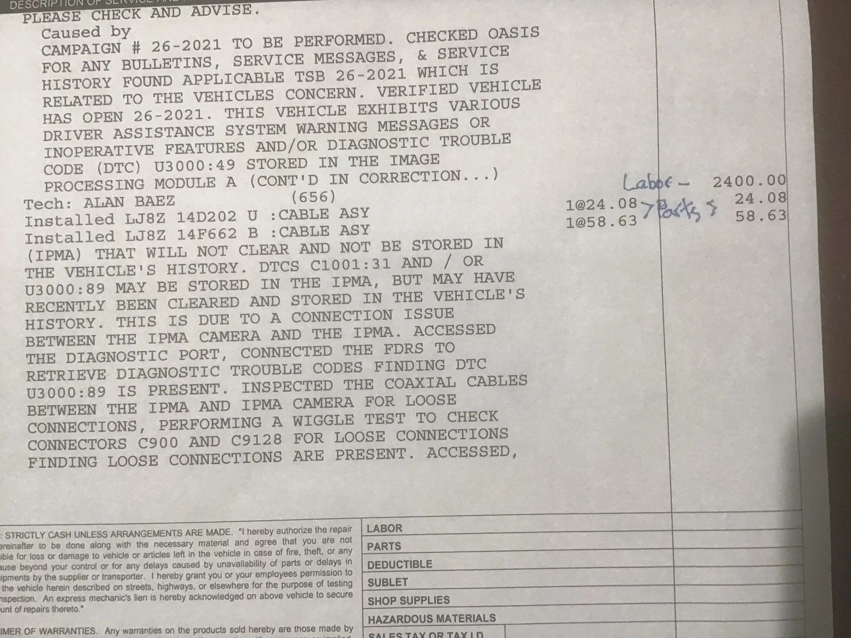

Took 2021 AWD in to have cruise control fixed. This was charge for 2 parts (cables) plus labor. Can someone out there please explain. Picked up car drove back home and ACC still didn’t work. What no road check . Ran cable from IPMA at rear of car to IPMA camera at front of car for $2400.00 labor cost.

Yes, I would ask them what their hourly labor rate is, and then how many hours it took.
For the camera coax cable replacement, I would think about 5 hours is reasonable. In LA, labor rate is probably up to $250/hr now? So I would expect around $1300 in labor.

What's really important is that they spent your money, and apparently did not fix the problem...
