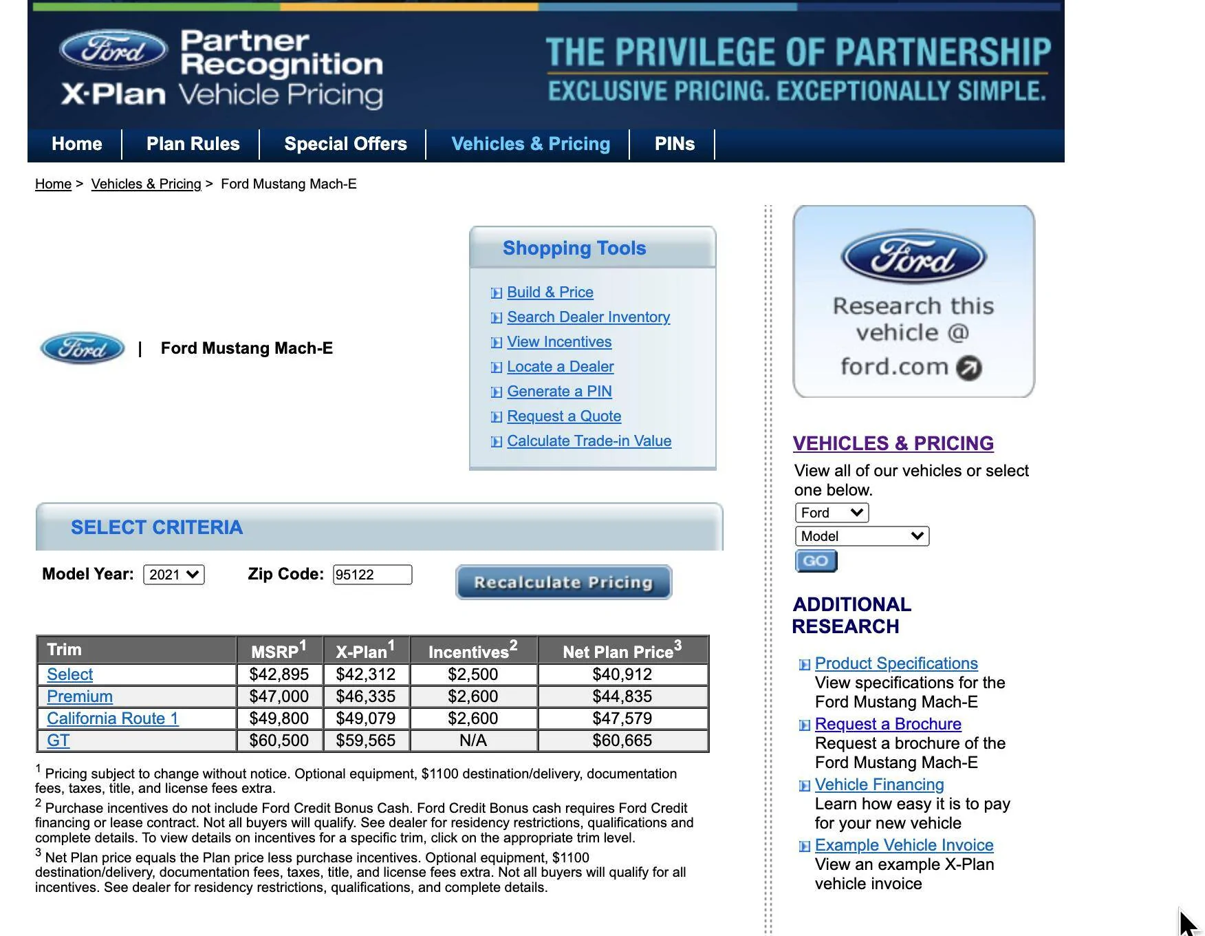

As others have mentioned, they are incorrect (or flat out lying) about X-plan. My dealer also tried to pull something similar saying that this car did not qualify for X-plan. I was calm and confident telling him that it did apply to this vehicle and that I had proof (via a screenshot of the Mach-E listed with X-plan pricing). He had to ask his GM but ultimately honored it.

Can u share an FE xplan screenshot? U mean an invoice? Not sure I’ve actually seen one other than a premium.
Hmm... Luckily I didn't have to show the screenshot to the sales guy ??... Looking for it now I realize that it doesn't specifically say "First Edition."
However, I didn't have to tell the dealer that the First Edition is actually a Premium. Once I pushed back on them they made it happen. It should be common knowledge for any dealer salesman with the proper understanding of the Mach E that the trim of the FE is Premium...
