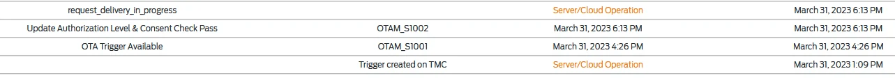

I’m pretty sure that the only time a vehicle-side parameter affects updates is if: 1) The update has already been queued for your VIN, and 2) All update parameters are met by the vehicle (LVB >80%, vehicle not running for an inhibit update, etc.) . If the update has not been queued for your VIN, there is zero that can be done to influence the delivery outside of using FDRS. ??

Yeah I wouldn't buy into the 10 key cycle thing, sounds like someone on BEV support was just confused about a process. The OTA updates are triggered by your VIN being set to get an OTA update on Ford's end, nothing your car does matters.
Here is the OTA Status Log from one of our MMEs recent OTAs.
Where can you see this?
