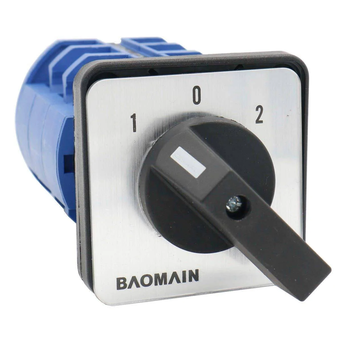

So, I had an idea.
Getting ready for buy MME, Surely (Surely you can't be serious. I am serious, and don't call me Shirley.) I ordered my EVSE. It is an Autel 50 Amp, which is hard wired. Got a great deal on Amazon...
Anyway, the thought is around redundancy and utility.
I thought I might have the line from the fuze box run into a Changeover switch. This would allow me to have the hard wired Autel EVSE AND a NEMA 14-50 plug and switch between them.
Why?
Well, I'm glad you asked.
1. Redundancy - If there is an issue or failure with the EVSE, I can switch to the 14-50 plug and use the Ford charger....temporarily.
2. Utility - Who knows what else you could use a 14-50 plug for.
So, am I crazy, stupid, both?
Example of the Changeover switch:
https://a.co/3evF4I6
I see no reason for a switch, you can have a hardwired

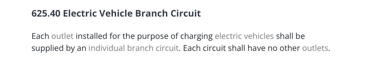

I see no reason for a switch, and after watching Sandy Munro's video on level 2 chargers causing breaker and plug failures I would no want to add another component in the circuit. Why not just hardwire the EVSE and a NEVA 12-50 on the same circuit similar to every other circuit in a house. As long as only one is used at a time no problem, if the accidently both get used, I assume the circuit breaker will open.
Hammered
Oct 4, 2022
1,303
1,175
SE US
2022 PB F150, MME GTPE
You can't do that -- Both require direct-wire.
You could end up with 2 32a chargers running and possibly start a fire if fed from a 60a breaker. Even 32a chargers will pull up to 34a. Not smart.
