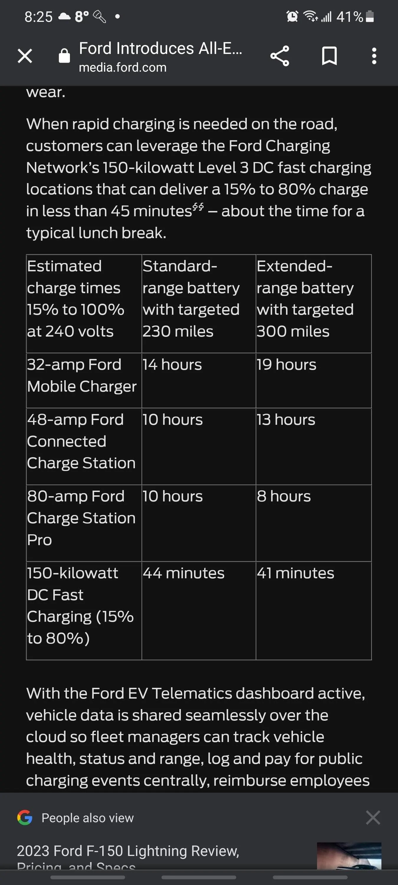

Plus if you're DIY, 6 gauge is plenty fun to work with already. Can't imagine 4 gauge. Future proofing is one thing but I think we're a ways out, if ever, from needing anything like 80 amps for L2 overnight charging... By that point, that'd mean the mpge would be the equivalent of an ICE.

Lightning F-150 supports 80A charging. But yes, for the MME crowd, 48A is more than enough for now.

Adding 80AMP plus circuits to the majority of household panels will almost certainly cause problems. When 80AMP or more becomes a standard a lot of folks will need new panels, and posibly new service lines.
There are a lot of benefits to using the slowest charging that suits your needs. Its cheaper, safer and better for your batteries to charge at lower speeds. If you are charging from 15-85% of the battery 20amps will geet done overnight.
