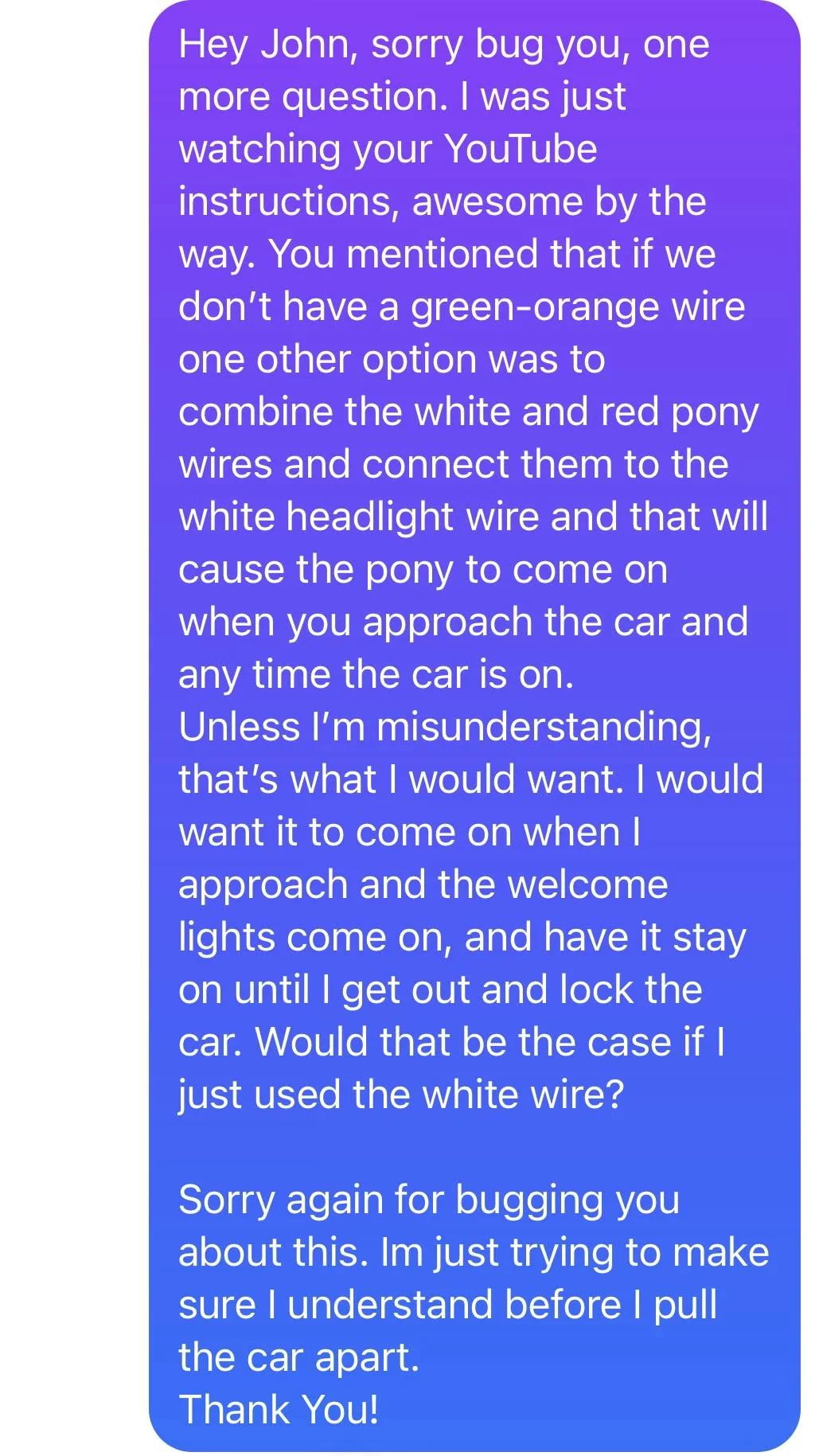

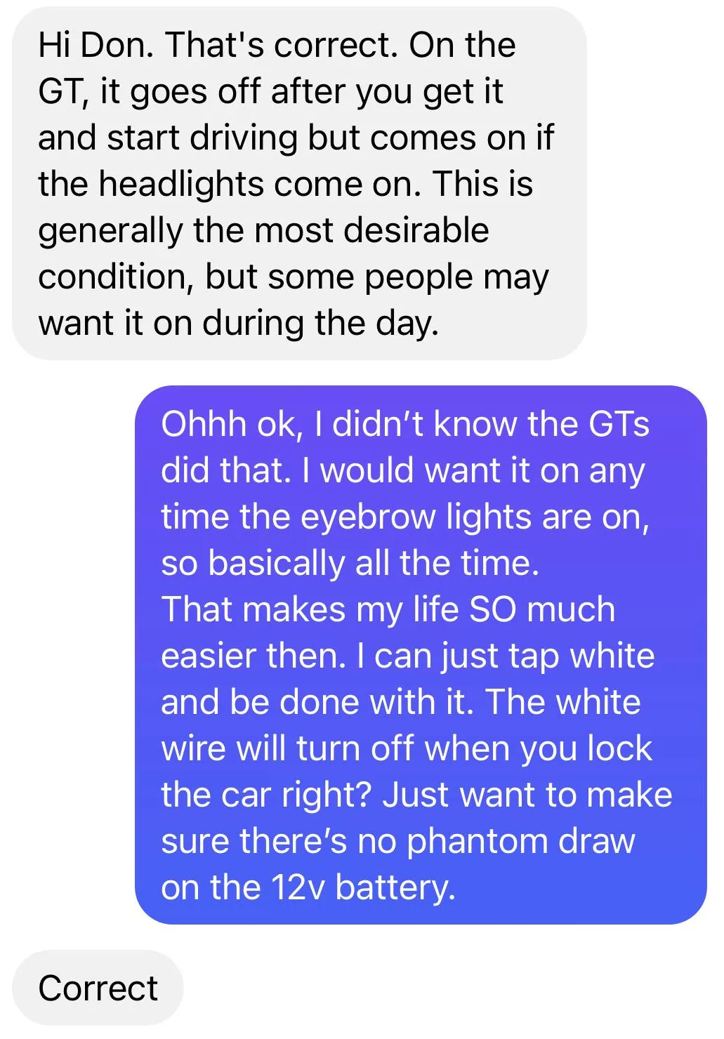

When I asked him about the “always on” method, where the pony is on any time the eyebrow lights are this is what he said.
Ford Mustang Mach-E Lighted Pony Project (back it!) 8E019481-FF11-4586-B419-81BEFD43003B
Ford Mustang Mach-E Lighted Pony Project (back it!) 493AAAA1-BDDD-4F00-A92F-098BE0EE7C75

An alternative to the always-on with the 15-minute shut-off delay might be using a fuse tap to an open switched fuse location. I have the battery packs for my dashcam, which is wired to a switched fuse location. It seems to shut off charging immediately on power-off vs. the 12v from the headlight with the delay.
It will not light up on approach but should stay on anytime the vehicle is powered on and shut off immediately on power-down. Just throwing this option out.

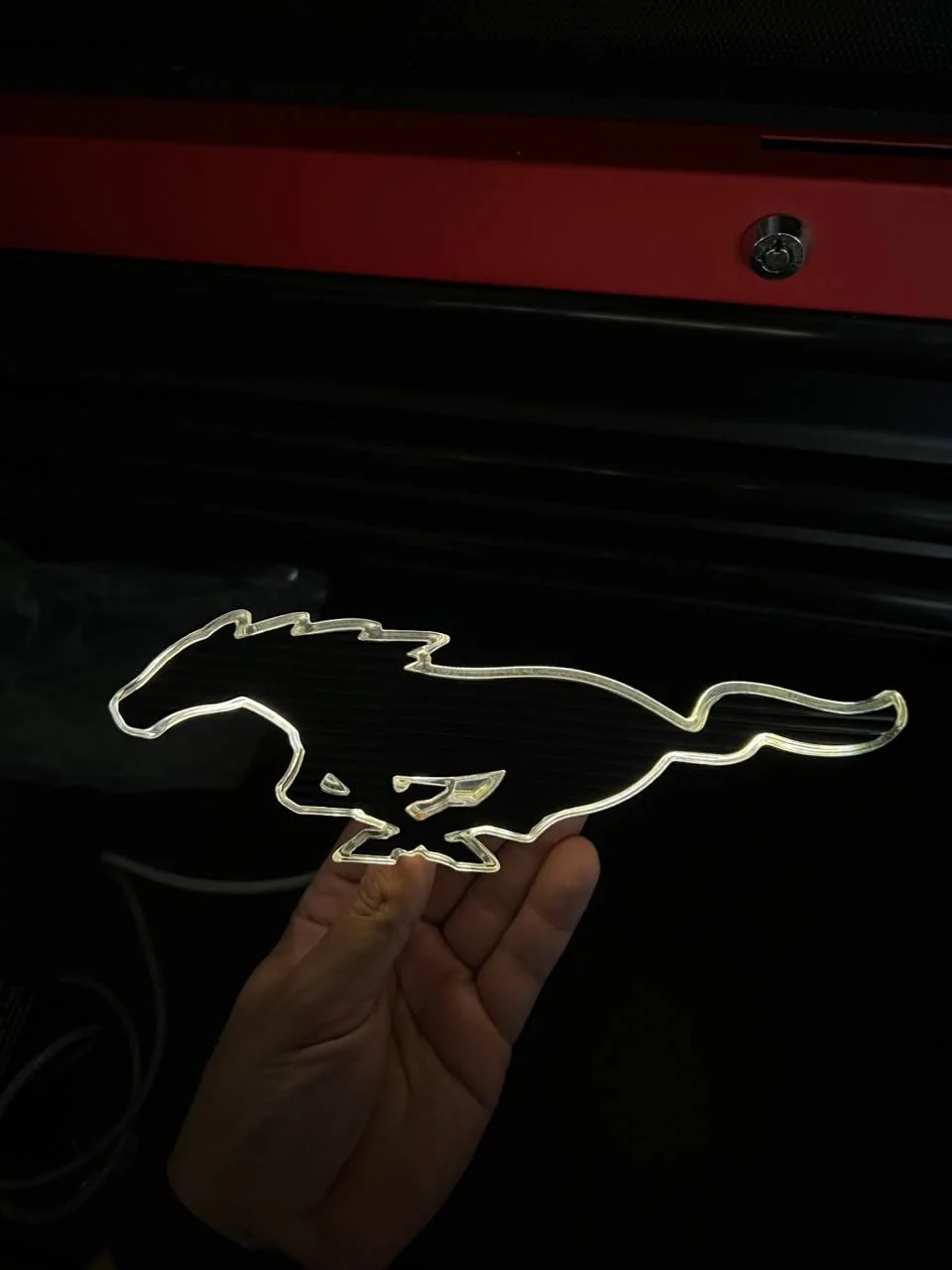

The same thing happens to me with the 4000k. I installed it yesterday.
Similar issue here. The LED pattern is weaker across the entire top side of my pony. I’ve tested it up against different materials to see if it would end up reflecting light to look more illuminated but it’s simply not the case.
The camera pulls more light on the top edge of the pony, but it’s not that bright in-person. Might try to get a replacement, or return and wait for the next redesign to be implemented and available.
Ford Mustang Mach-E Lighted Pony Project (back it!) FB6C865E-4ECA-404A-A13C-9632D4E2380A

Received mine and feels similar.. though I've only set it up on a test unit and not wired into the car itself.. wonder if this behavior was observed by others who have installed onto their cars?

Mine definitely had some areas of dimmer and brighter, but nothing like the 6k version. I was happy with it. But now mine is completely dead. ? Not sure what happened, but it only gets hot now (135F ish). I had to pull the frunk back out to disconnect the positive wire. If I can't get a replacement, maybe I try the AliExpress version. It's less than half the price.

2) Uniform intensity. This is a tough one. It would take a lot of trial and error. For the bottom appearing brighter than the top on some, well I don't think this is really noticeable installed, standing at adult height, 3+ feet away at night. I could be wrong. Note that the LEDs are spaced uniformly around the outline of the horse. Otherwise, we get dim spots (the tail has been mentioned; more on that in a moment). The LEDs along the bottom are closer to the edge. It is partly a function of available space. But it's not just that they are closer to the edge. It is about how the light is reflecting around the curvature of the body and the border. The light collects more in some areas and diffracts more in others. This behavior is impossible predict. I adjusted the arrangement of the 4K LEDs that should be coming in a week to 10 days. Hopefully that moves things in a positive direction. I also have the new plastics now with a little more diffusion. This should help also. It's not perfect. The side surfaces can't be too rough or else the Ponies will break when ejected from the molds.
3) The Tail. The first version is most affected. The later 4K and 6K dotless go all the way to the end of the tail and still it is a little dimmer. Something about that curl and curve does not want to let the light out. Instead it seems to reflect it back inwards. BUT, again, my integrated circuit solves this. I have an LED right there in the very end of the tail, and there is no dim spot.
