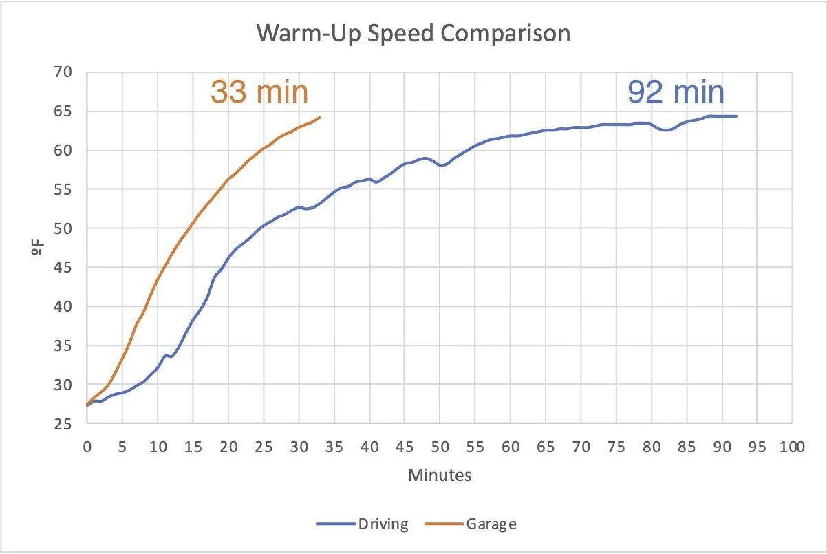

Figured i would update in hopes of other cold climate owners with similar issues and data logs being able to toss some data on fire. The problem continues and ford has stuck their head in the sand and gone radio silent.

I did a bunch of testing there and came to the same conclusion, the heater isn't big enough to heat both the cabin and the battery in below 0ºF temps. My Mach-E was only able to maintain a 70ºF cabin temperature differential with full 5.5 kW heater output. I think it should be able to maintain a 90ºF differential or more. If we scale that, that means the Mach-E should have a 7 kW heater minimum. Or two heaters that add up to at least 7 kW. I'd spec a 7 kW cabin heater and a 4 kW battery heater, that would be about right.

I sort of did a similar test. It will probably take 30-45 minutes to fully warm up the Mach-E. Where and how you measure the temperature matters. The air temp will be a lot warmer than the seat temp, so give that some thought.
Interesting in those temps I do not gain heat in the cabin unless I precondition even then it drops as I drive. The colder it is the faster it happens. At -19c I would be frozen solid and windshield frosted over in 82min. The variation of this issue is interesting and super annoying. As is @Ford of Canada @Ford Motor Company not doing anything to fix it going on two winters with little to no heat.
If you have low heat output some of the circuits in your PTC heater may have failed. If you have a scan tool, verify heater output by monitoring battery output power. You should see the heater draw an additional 5-6 kW at full blast. If your actual power draw is less than that, the PTC heater should be replaced. Again, they do have a partial output failure mode.
Runs about 5.5kw the whole time pegged right out. in the earlier logs in this thread.

Runs about 5.5kw the whole time pegged right out. in the wailer logs in this thread.
You need to look at the battery power draw, the heater power is self-reported and will be inaccurate if there is a partial failure. You will see the heater parameter say 5.5 kW but the battery power will only increase by 3 kW for example. That mismatch in power draw means it's partially failed.

You need to look at the battery draw, the heater power is self-reported and will be inaccurate if there is a partial failure. You will see the heater parameter say 5.5 kW but the battery power will only increase by 3 kW for example. That mismatch in power draw means it's partially failed.
I see will check that next data log. The heater was replaced with an updated unit last winter. Which does work better than the original unit.

Nice chart. I tested mine at -5f cold start and a 48 mile drive. It never reached 68F in the cabin. I have other charts from 10F to 68F took 38 minutes including precondition time.
So power draw looks good. Cold start e heat off .6kw power draw and heat on 7.8kw draw. Assume pumps and stuff make up the rest.
