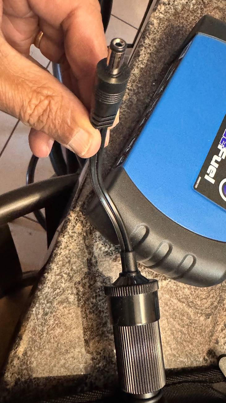

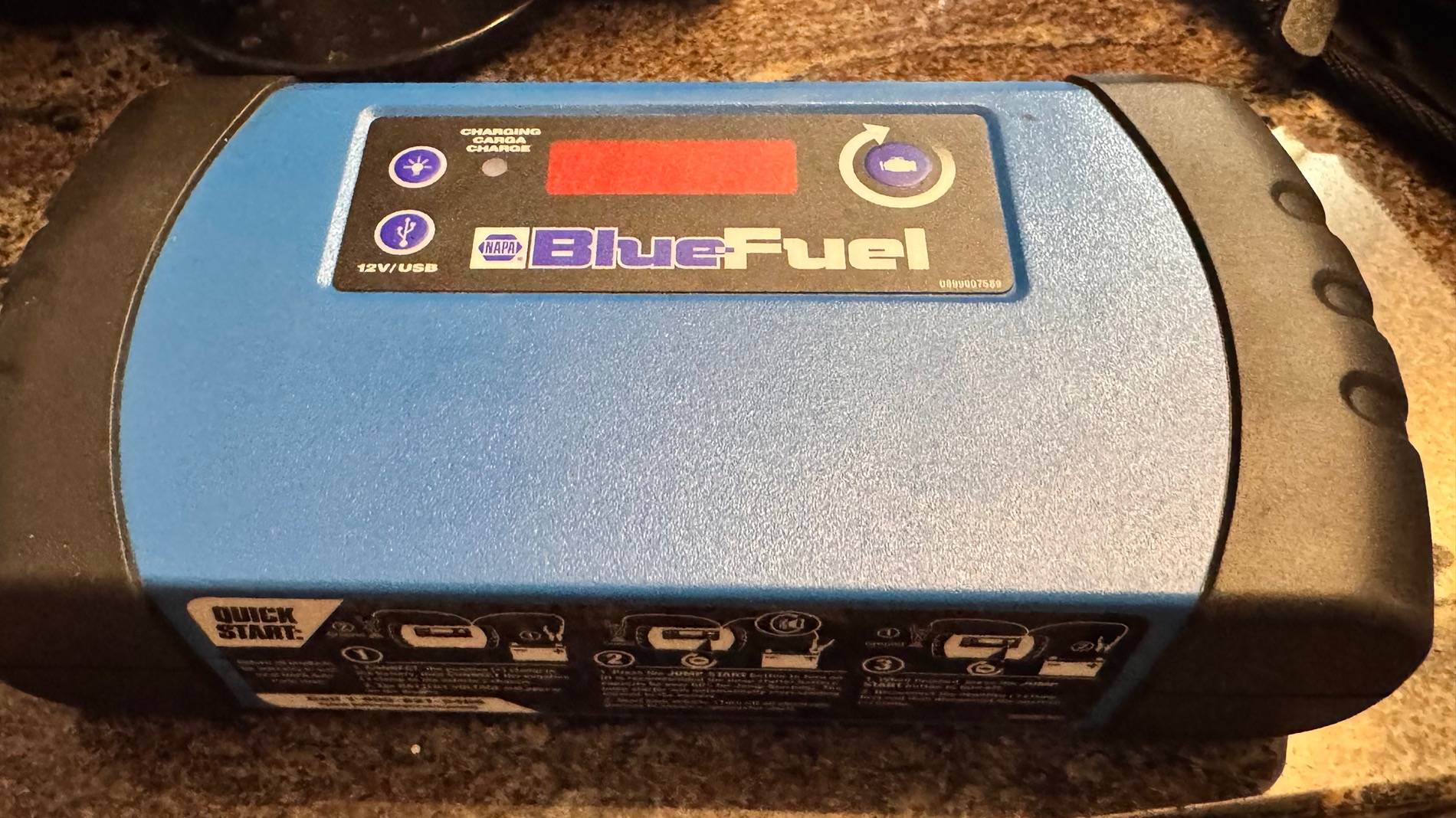

Update to anyone following in my footsteps…
1. I have this jump start pack from NAPA it’s called BlueFuel. It has 12 V cigerate lighter adapter only thing I had to do was Jerry rigged the two wires to connect to the 12V adapter.
2. First I tested with multimeter that 12V was showing at the leads of adapter.
3. I opened the hood and disconnected negative terminal (first remove the plastic cover).
4. I applied the 12V to black and red wires in the bumper. I could hear click click. So I knew it had power.
5. Next closed the car door and hood (little scary) with car battery disconnected.
6. I applied 12 V to bumper wires (didn’t hear clicks) but when I press the button on the door it opened the door.
I am thinking in step 4 I actually unlocked the car with the hood open.
So my observation is that 12V at bumper unlocks the car door and you can open the frunk with the handle inside the car afterwards…
I even closed the door (12V internal battery disconnected negative terminal), closed the hood and NO 12V to bumper wires. And pressing the round button at the door still opened the door.
I am guessing in step 4 I put a car in unlocked state so it didn’t matter if I applied 12V to bumper wires afterwards…
In summary once you apply 12V to bumper wires car is unlocked for good. I guess till you re-attach internal 12V battery.
I think I am ready to store the car for winter…]
PS: Is there an adapter to 12V plug (see pic) that would give me two separate wires?
Ford Mustang Mach-E Long term parking and preparation IMG_5463
Wrong conclusion. The doors WILL NOT UNLOCK if they were previously locked. The door modules remember their current lock state. So if your 12V battery dies while your car is locked, you will have get the frunk open and jump start the 12V battery (and have your fob present) before the doors will unlock and open.
You did not lock the doors before disconnecting the battery in your test.
The bumper leads only power the GFM or frunk module so it can open the hood release, and only when the 12V battery is dead or disconnected. That's it. It does not backfeed power to the 12V system or provide any other unlocking functionality. Your 12V power supply may not be powerful enough to open the latch while loaded, use a bigger battery (such as another car battery) in that situation.
