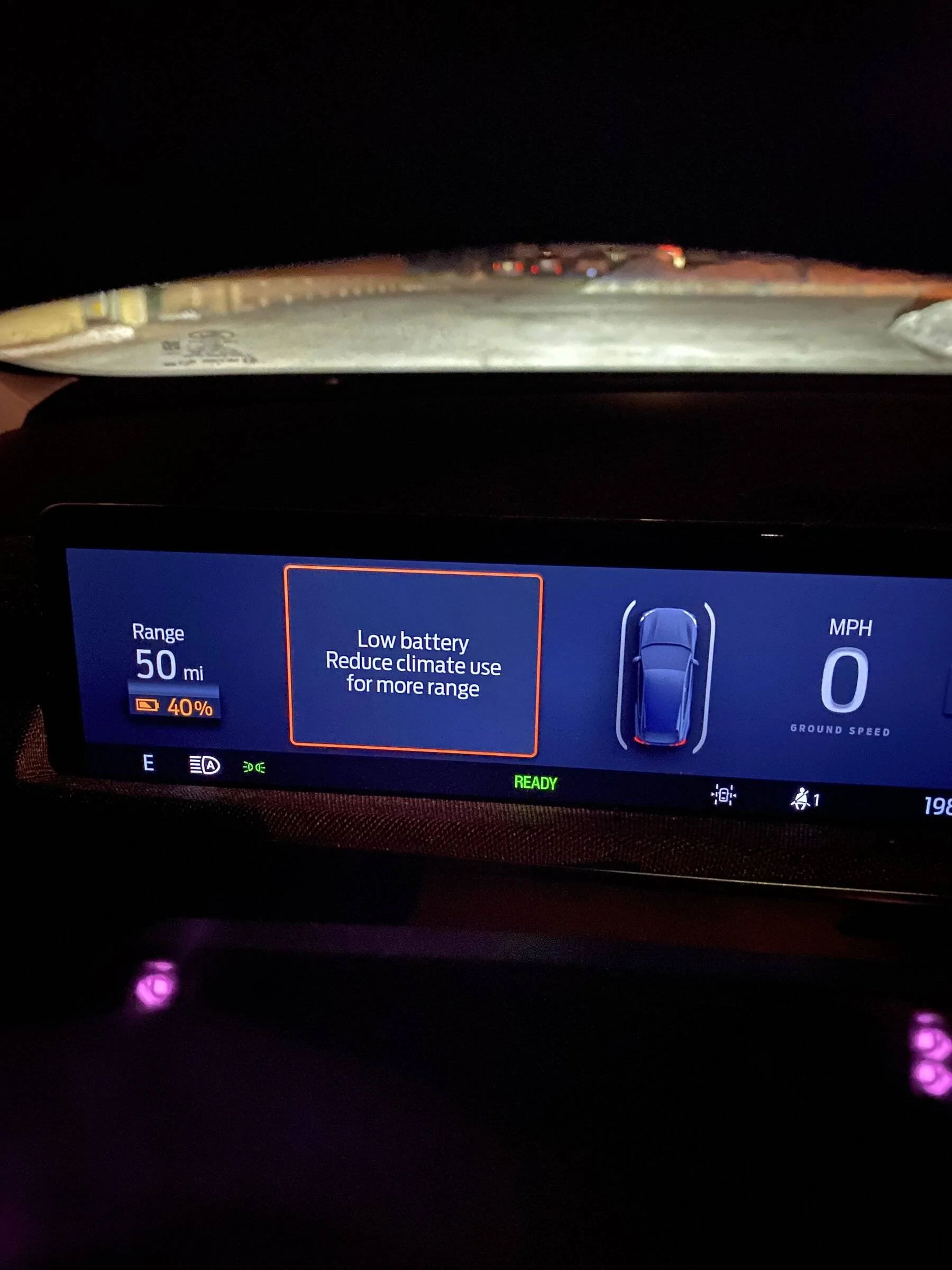

Why at 40% does it tell me my battery is low?!? I live in WI it’s 2 degrees right now. I don’t need you to tell me my battery is low at 40%
the other day the car slid on the ice I saved it and didn’t hit anything. Then the car starts losing its mind and tripped 7 codes! The dealer couldn’t get me in for 5 days so no cruise control during that time and as a realtor I drive a lot. Cruise would have been nice. The car spun imo because when it is really cold the car appears to kick out of “unbridled” so I took my foot of the throttle and it didn’t slow down at all! I had to brake hard while trying not to hit anything. That has happened 2x’s now where it is not in “unbridled” anymore. It appears to happen when extrem cold. Like negative 15 or so. Now this battery thingtelling me it’s low is just too much!
The car also didn’t charge overnight and it was a long day of driving so I woke up to 4% to get my kids to school and to a super charger so I could go to work.
Car is fun to drive but I’m not sure it has been worth it with these seemingly small issues as they add up to a lot of time dealing with them and time is money.
Sorry to all of the haters out there that will rip me because it’s not a big deal but I disagree with all the people that say things like that and trash others. It is a big deal we paid at least 60k for a product that I’ve had close to a year and the issues keep popping up.

There’s a setting where you can chose when the low battery warning comes on. That and your mode changes sounds like it’s just going to a guest profile instead of your profile. Does it happen after a remote start by chance?
Several people have had issues with traction control freaking out. Many people recommended disconnecting the battery for a few min but I don’t think any of those people tried it.
mine has done the late start on charging about 5 times now. Just another exciting bug. At least it was an excuse to use some of those free kWh.

The set point for the low battery warning is set by you and based on range, not charge level. I have mine set for 30 miles.
This is a brand new product and first adopters can expect more issues then someone who waits a year or two before getting it. New products always follow that cycle of continuous improvement until production ends.

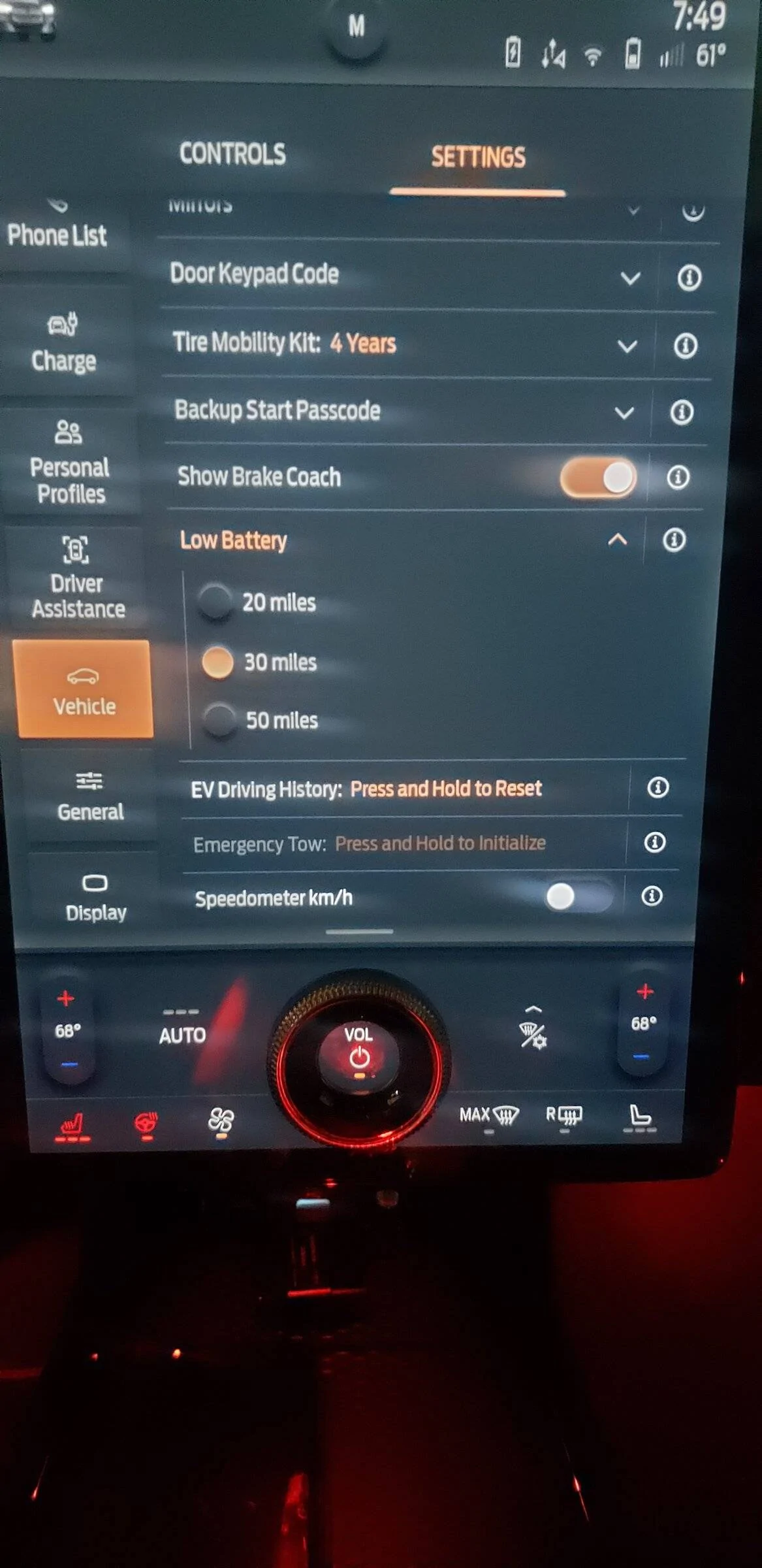

Here is where you can find the low battery setting:

Thank you so much for that info! Clearly something is not right with this thing after it spun. Even after the dealer did their thing and I even asked if there are any Updates hanging out there and they said there wasn’t. But today it only charged to 60% so yeah something is off. It goes to dealer again next week for the roof recall and I have them putting the gasket in between the roof and the windshield so at least it will be quieter and the roof won’t fly off. Thanks again!
