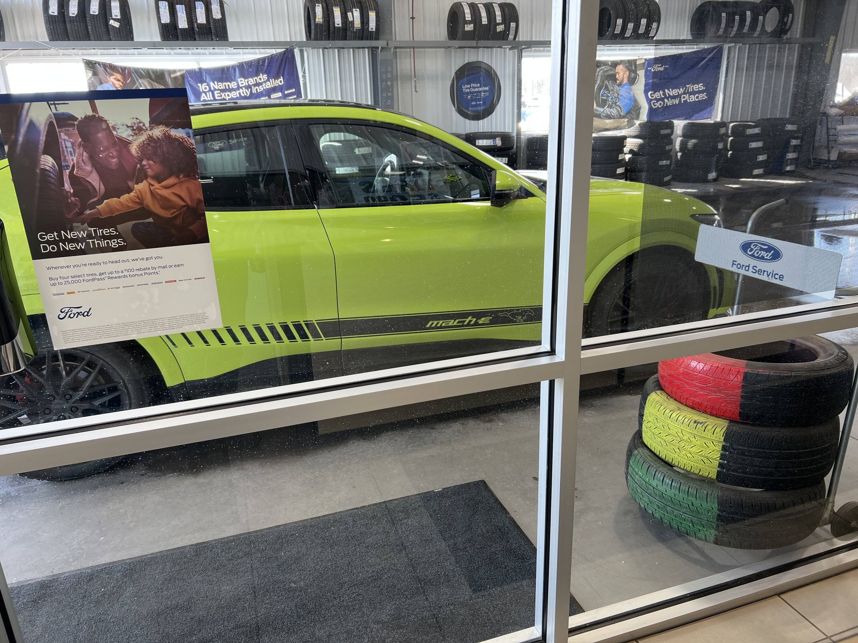

Ford Mustang Mach-E Charge Port Replacement and unknown codes image
When you really want your car back, and Ford says they need to compare your broken car to a working car….and the dealer doesn’t have a Mach-E on the lot…. I guess you have to to bring your OTHER car in. Hoping it helps get the other car back.
