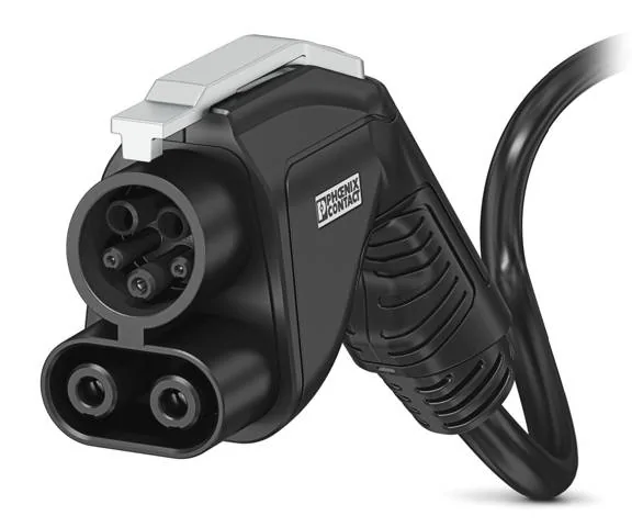

I received an email from the BEV team today saying that my buyback was approved. Now I have to wait to hear from the buyback team.
I received a copy of the dealer service notes. The first charging port that they received had a different connector to the wiring harness that goes to the battery. The newer model that my CR1 needs is still not available. Total time in the shop as of today is 39 days.
The notes also say that "One of the 2 charger sense pins is bent" on my original charging port. This is still a mystery to me as I can not see how an EVSE/DCFC jack can even be inserted into the port in such a way that a pin could be bent. Everything seems like it has to be perfectly aligned before it can be inserted, but maybe this is why I am not an engineer. When I examined the port as part of my original troubleshooting trying to figure out why no charger would connect, everything looked normal. Lesson learned: ALWAYS take a picture!
That would be their out that it is your fault you bent the pins. I have taken photographs and I am sure they are not bent. Something is wrong with the port or the harness on these vehicles it appears and Ford is being as transparent as the HVBJB problem. Also as proactive at fixing it.

Possibly if it was one of the AC Pins and the DC cable doesn't have AC pins present:
If it was one of the J1772 ground or signal pins that was bent, then no go.
I’d be opening it up and repairing it. Nothing to lose if unsuccessful??‍♂
I wish I could. Since it stopped charging while I was traveling, the car is at a dealership that is a 2½ drive with a ferry ride away.
When the service writer first told me a pin was bent, I said "Well can't you just use a pencil or popsicle stick in and bend it back?" That didn't go over too well. If I had seen a bent pin, that's what I would have done.
