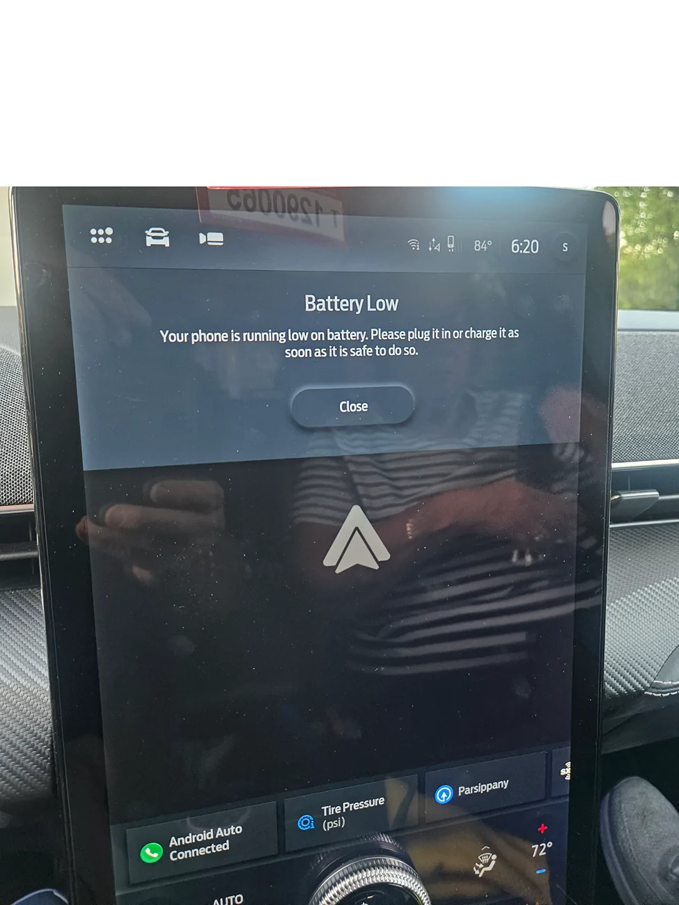

We get this almost every time we get into the car now (maybe every time). Galaxy s10e and 24 ultra. 2021 build 2

Mine is a S22 Ultra and the same issue. Started after the new recall update was performed at my dealer last week

It happens to me as well, started about a week ago. I have a Galaxy S23. I was about to post in the forum too.

I was getting this. Sounds like it is due to an andoid auto update. The solution was to turn off the power savings on your phone from the swipe down settings menu.
