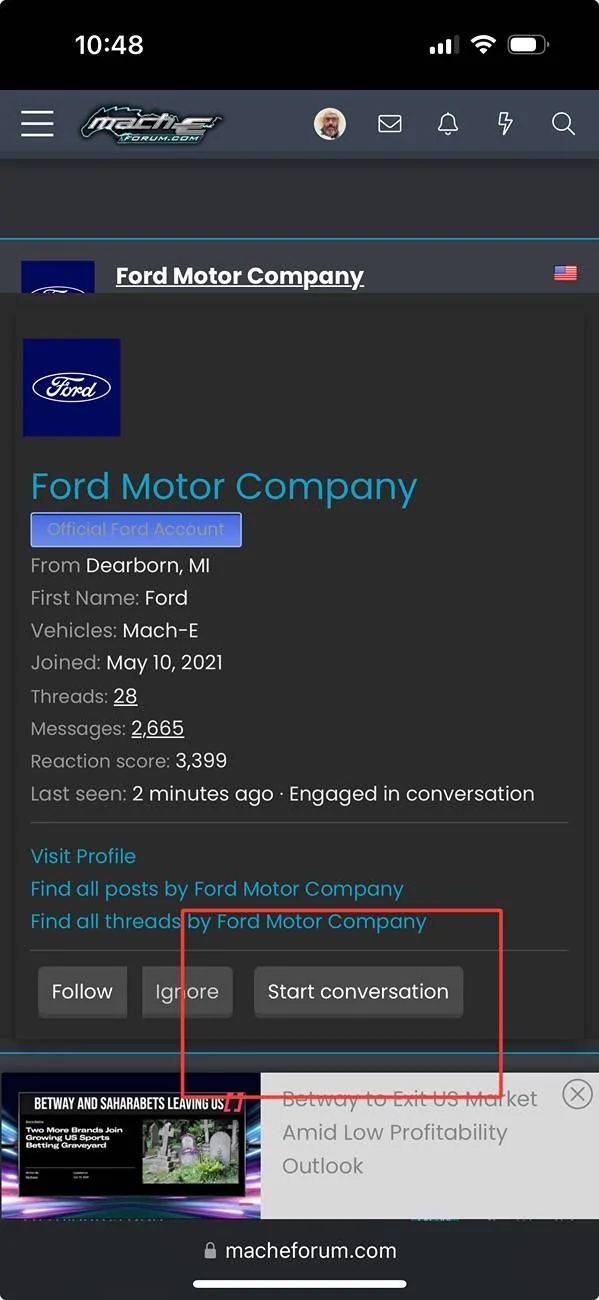

Not sure how to send you a private message. Been on this forum for 3 years, reading and learning but never posted before or sent private message.
Click on the posters name and then start conversation.
