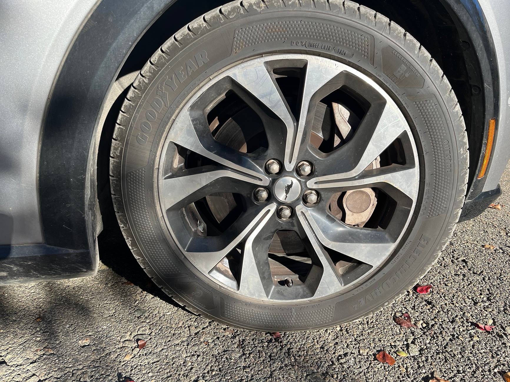

I just put these Goodyear Electric Drive 2 tires on my 2021 MME permium and they are great. I like the way they hold the road better than the Michelin tires that came with the car. Four new tires on a MME are going to cost you some money no matter which brand you select. I am glad I got these. They include foam which makes for a quieter ride. Goodyear is offering a $100 rebate on these right now which made the decision a little easier. Check them out.

thanks Silver Pony, - will check it out today/are they run flats?
